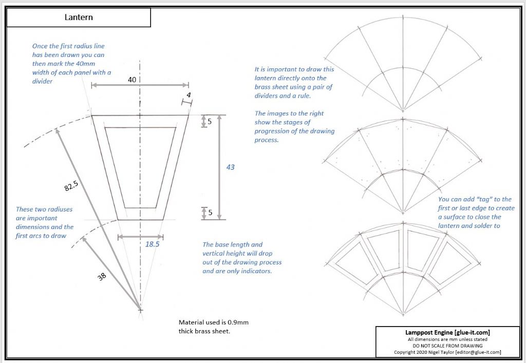

                        #484970
                        Nigel (egi)
                          @nigelegi
                          Hi All, lots of interest in drawings and so I thought I would share with you all a simple plan for the lantern main frame to see if this would meet your standards. I'm not great at CAD and I find it therapeutic to use an old fashioned drawing board, scan it in and then add nice text (my handwriting is like a spiders scrawl).
                          A lot more to do, but would be grateful for some feedback, thanks, Nigel
                          PS: uploaded image to here so that you should be able to click and zoom in
                          Edited By Nigel (egi) on 10/07/2020 21:48:50
                          Edited By Nigel (egi) on 10/07/2020 21:49:58
                          Edited By Nigel (egi) on 10/07/2020 22:14:32
                          #485054
                          Jim C
                            @jimc
                            Hi Nigel.
                            The development drawing looks ok to me and clearly worked for you. Did you use a sheet metal folder for the fold lines when producing the shape ? Cheers, Jim.
                            #485075
                            Speedy Builder5
                              @speedybuilder5
                              Nigel, it may have been easier to have used an adjustable set square using an edge of the sheet as your datum line, but full marks for the method you used.
                              #485106
                              Nigel (egi)
                                @nigelegi
                                Posted by Jim C on 11/07/2020 15:43:50:
                                Hi Nigel.
                                Hi Jim, I made my own clamp to file and fold to. Image below of the clamp
                                clamp for filing and folding
                                When folding I had to work outwards from the centre fold. For the folding process I clamped the one side and used a wide piece of steel that I could force the edge over with.

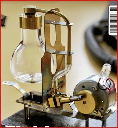

                                            John you could also include a small spirit (idea for Xmas) fired boiler then you would have a self contained unit
                                            Edited By JasonB on 14/07/2020 10:10:06

                                                Nigel (egi)
                                                  @nigelegi
                                                  Posted by JasonB on 14/07/2020 10:09:48:
                                                  Hi Jason, I quite often see these glass boilers, do you have any specifications and or guidance on their use? Best regards, Nigel
                                                  #485580

                                                    #485585
                                                      Sorry, no details of the glass boilers, some of the German suppliers do simple kits with them in but a small metal boiler would work, the plastic tube acts as the safety valve popping off if pressure gets too high
                                                      The other option is just to supply a length of tube and pass it around the table to see who has the strongest lungs, couple of "steam" engines I have built recently can be run by blowing, even my 10V will do it but not for long as I go blue in the face!
