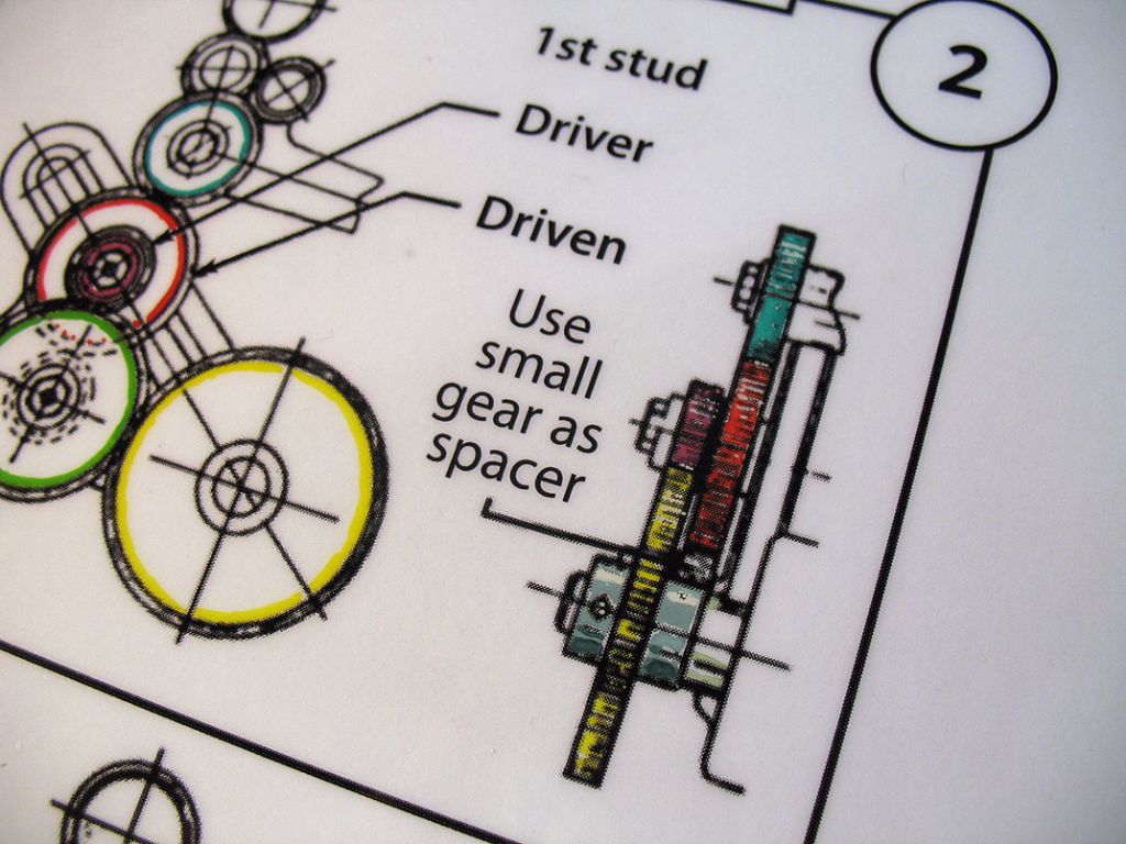

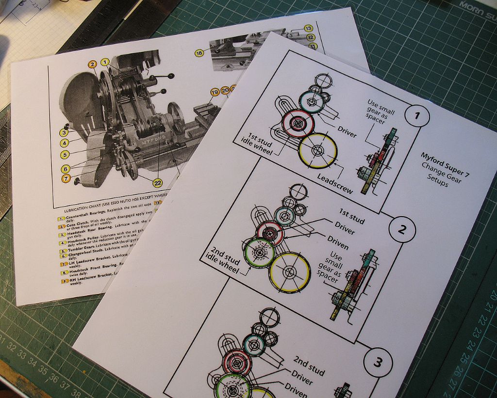

      Just acquired a Super 7 lathe to replace the aged ML10 and because the lathe is new to me I've been printing out copies of all sorts of information to have at hand out in the shop.
      Of course, a machinist work environment is not exactly paper friendly, what with stray chips, oil, etc.
      The obvious answer is to laminate that information to keep in clean. Nothing new in that one, but in addition to that I decided to help my old eyes by doing the following:
      A) … I scanned and then scaled up the information as large as possible.
      B) … I cleaned and tweaked the images using some graphics programs. (I'm kind of an artsy sort, but this bit is strictly optional)
      C) … After spitting out the pages on the laser printer I spent some quality time adding color to make some of the information more obvious.
      The images below tell the story. The color highlights were added with watercolor paint, but felt tip markers or color pencil would do just as well. The laminated covering protects the color as well as the information.

          I did the same thing with cutting speed tables, tapping and clearance diameters, screw pitches, metric/imperial conversions and belt/pulley settings for speeds. (Tubal Cain's "Model Engineers Handbook" had most of the data and Excel provided a handy way to present the tables in A4). In my case I laminated two pages back to back, punched holes and joined all the sheets with two 1" keyrings so that I can easily leave it open at whichever table I need.
          It looks like Myford's illustrations of change gear configurations are much clearer than Chester's, having seen your sheets I think I will have to draw up something similar for my son's lathe and add them to the stack.
