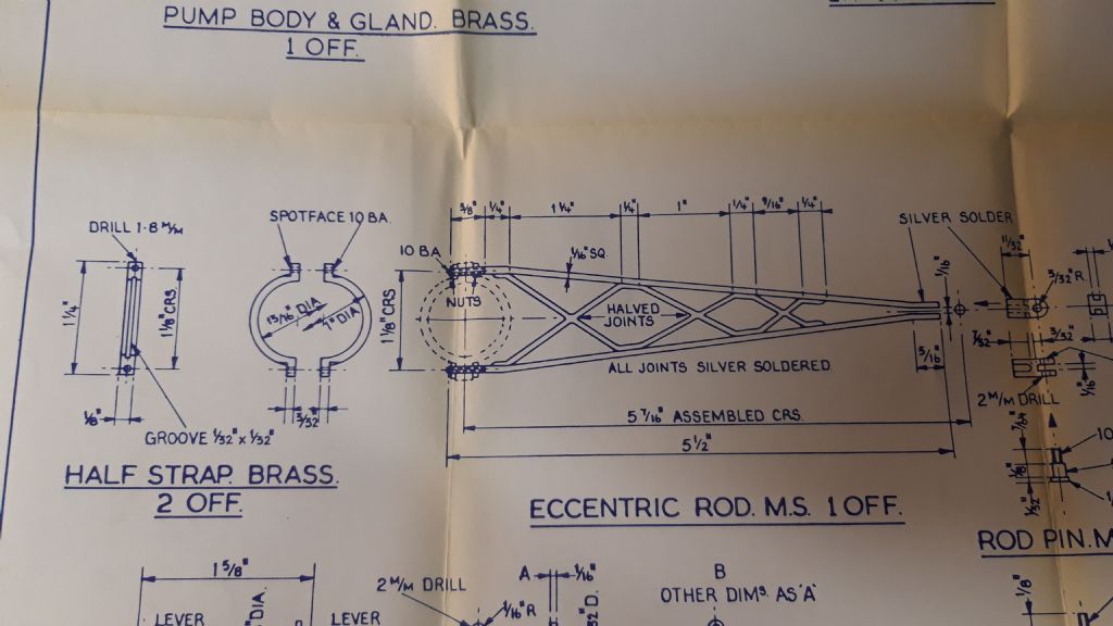

          I built Lady Steph about 10 years ago. She ran very nicely on air so I stripped her down for painting and left the parts in a box for a few months. When I went to re-erect, the eccentric strap and rod were nowhere to be found. Meanwhile I had donated the plans to someone on this forum. I assumed I had lost the parts somewhere under the bench and that they would eventually turn up, but having recently moved house and cleared out the workshop they are still missing.
          So… does anyone have a copy of the eccentric strap and rod drawing that they could help me with? She is now all painted and pretty in a display cabinet, but would look a lot better running.

            Hi Alan is this what you need? I took the photo from my plans, if it's not clear I can scan them. My lady stephanie is still a bix of castings and lumps of metal, one day I might get round to making it!

              Thanks Ian, that's just what I needed.
              Apologies for the slow reply – I had a bunch of Covid related family issues lately and only just got around to checking the forum. You should definitely get around to making it sometimes, it's an interesting build and makes a very attractive model.
