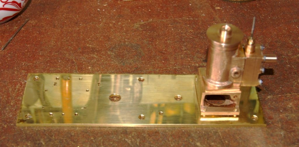

          #209874
          john carruthers
            @johncarruthers46255
            Got the pedestal/cylinder covers/valve and rod done.
            Used the new (ish) indexer to mark out the cover holes.

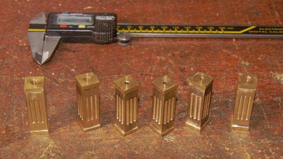

            #210791
            john carruthers
              Today I received the 2mm ball end mill and made a start on fluting the square lower columns…

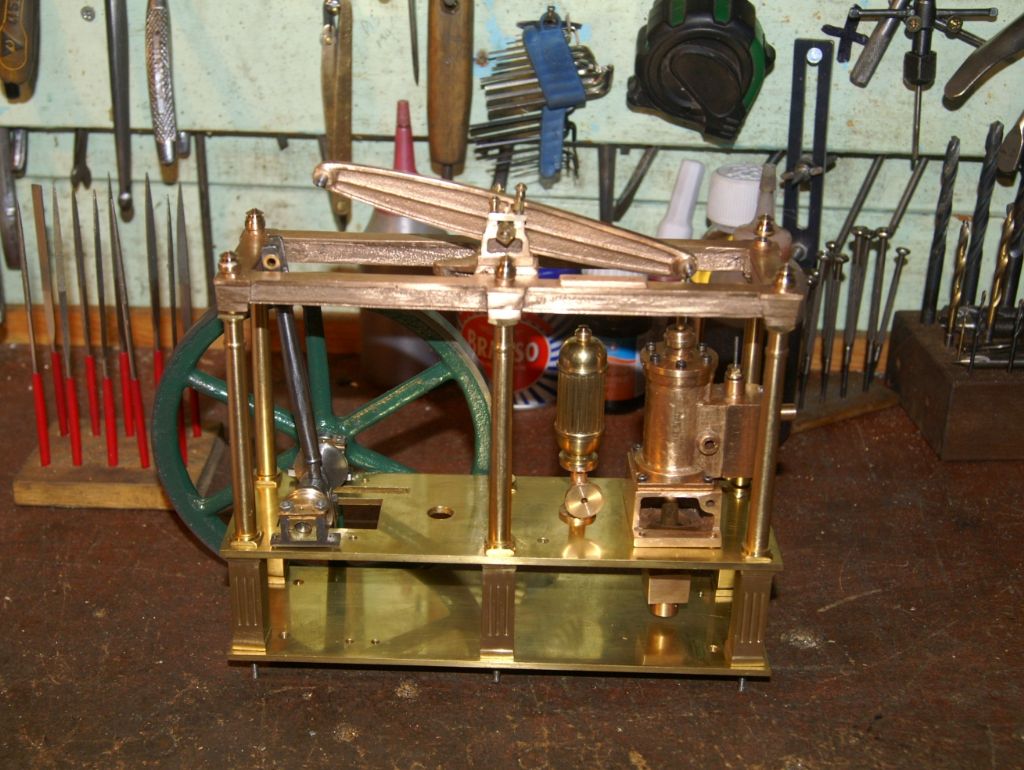

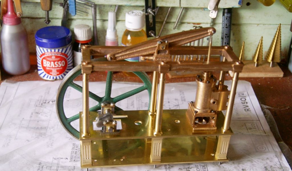

              #211116
              john carruthers
                Starting to look like the pictures.

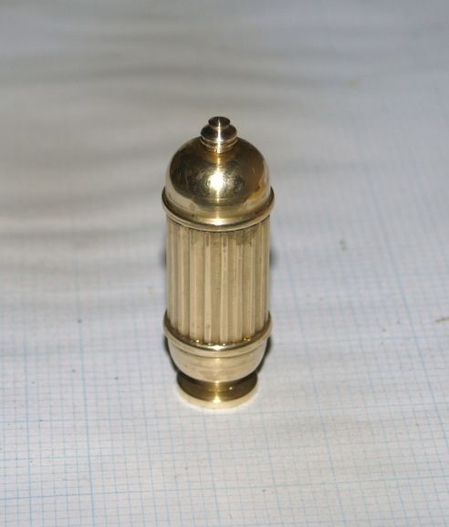

                #212826
                john carruthers
                  Probably the most recognised bit, the air vessel. Still have to make the flange drilling jig.
                  #212878
                    Very nice, I'm saving that bit for last
                    I like your columns.

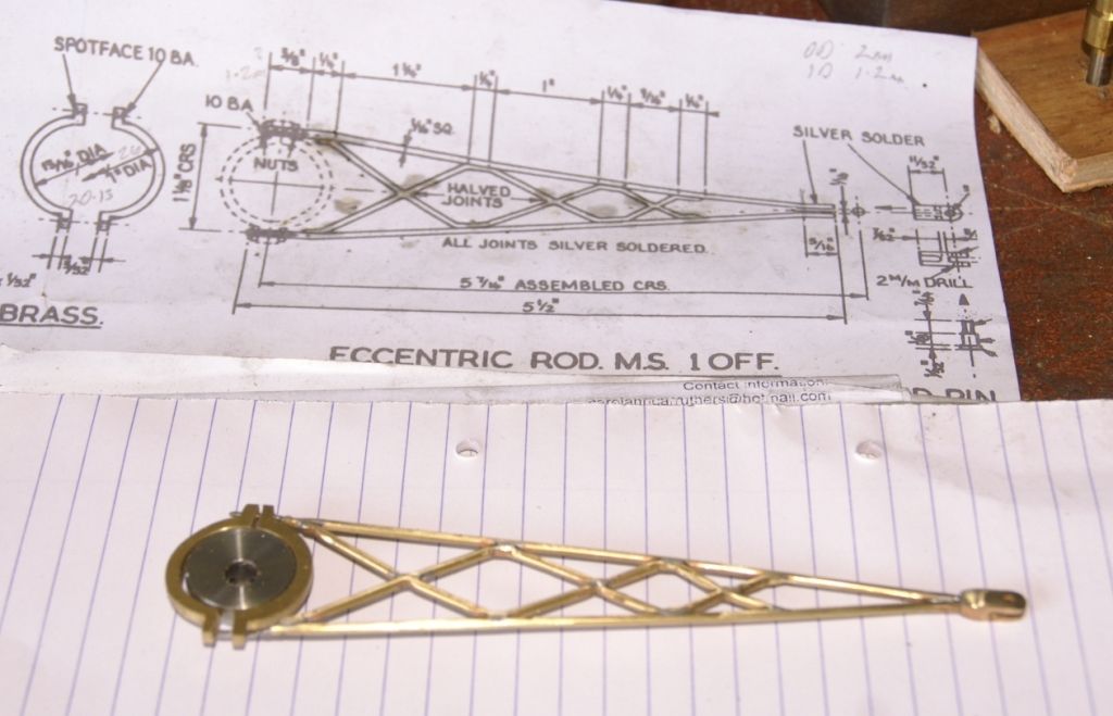

                      #213715
                      john carruthers
                        eccentric sheave, straps, rod and 'forked jointy end thingy'.
                        I shall clean up the solder a bit more.

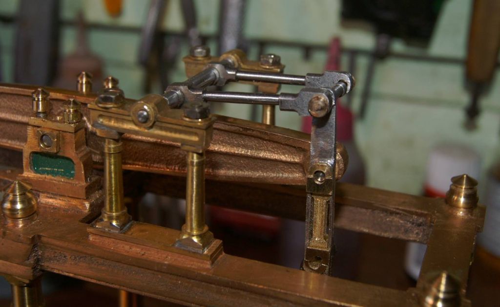

                                            After a fortnight moving the sister-in-law and a lurgy I'm trying to get on with Lady Stephanie again. Got the parallel motion roughed out.
