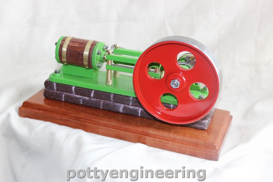

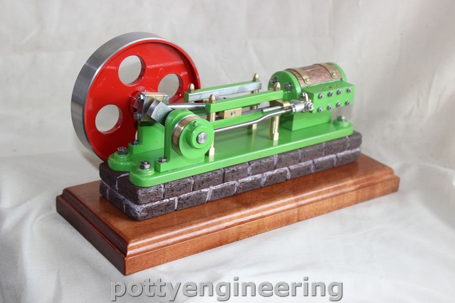

            #120542
            Stewart Hart
              @stewarthart90345
              Well got the engine finished off her's a few glam shots img_0159.jpgimg_0156.jpgimg_0153.jpgStew
