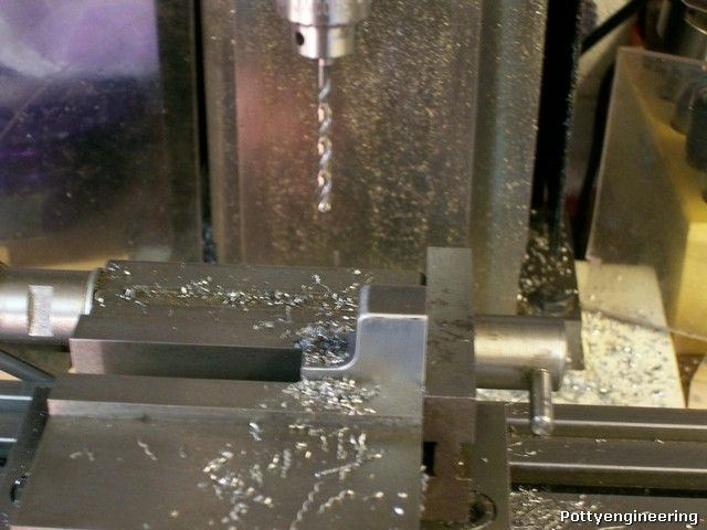

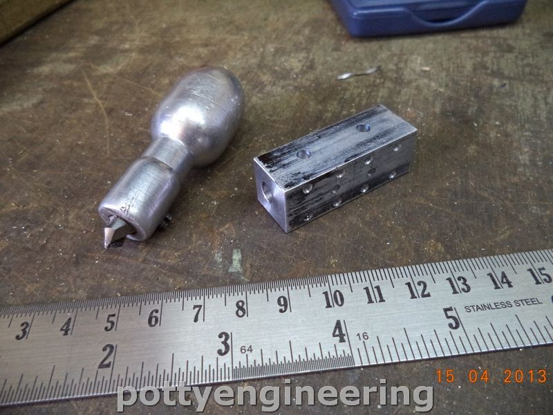

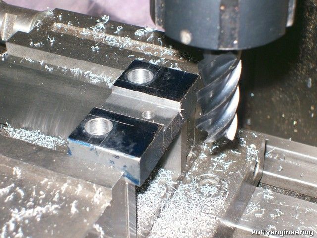

        I have an old works friend who's just getting started in Model Engineering along with his 11 year old son who's his showing a great interest in engines with a developing tallent for 3D CAD. Chatting to them got me thinking about an engine that could be built in a relative short time with limited equipment and I came up with the simple mill engine design
        The engine is design so that a father/grandfather and his son/daughter could make it with limited equipment, lathe a resonable quality pillar drill and drill vice.
        Hence Lads and Dads.

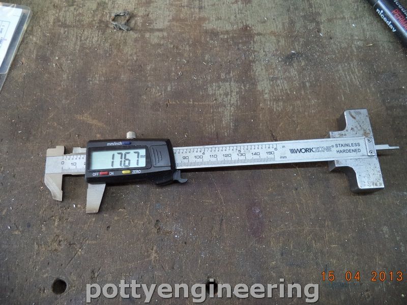

        The design is based on this engine that I saw at the Northern Mill Engine Association at Bolton at their Christmas steam up.
        An accurate method of marking out is required something like this
        Its just a cheap digcalipre with the legs cut back to form an odd leg, the lump at the other end is just a foot I made so it could also be used as a depth gauge.

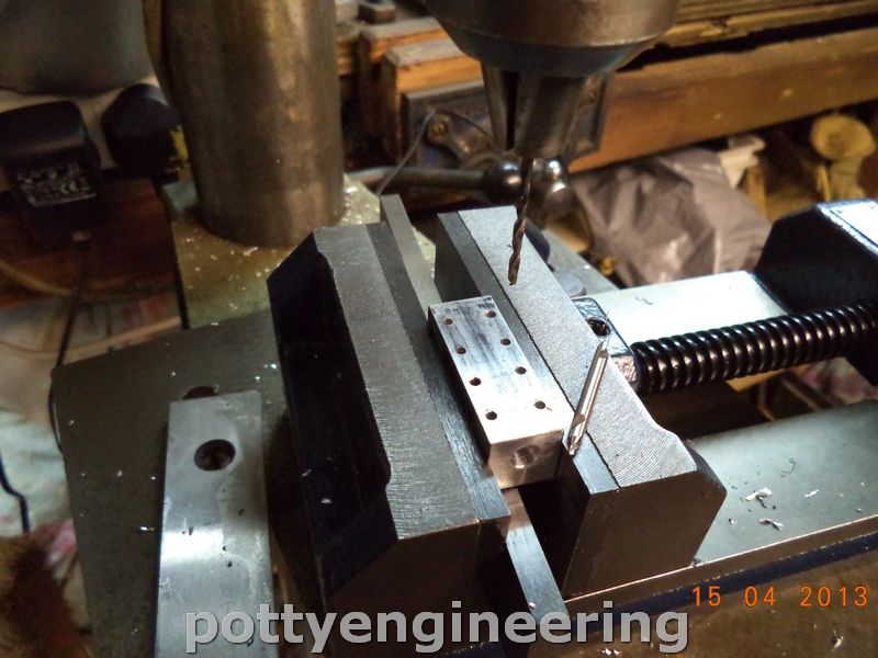

        I've made a start on the valve chest
        I'll add a few more pictures as work progresses

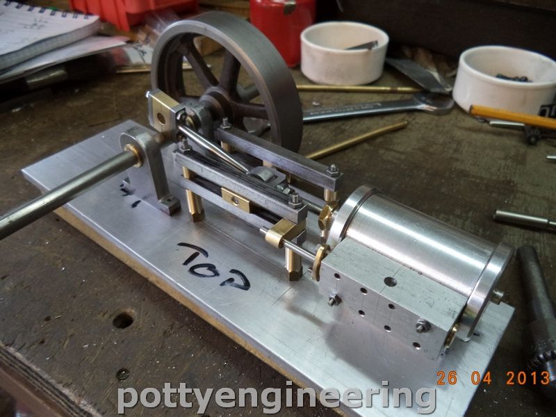

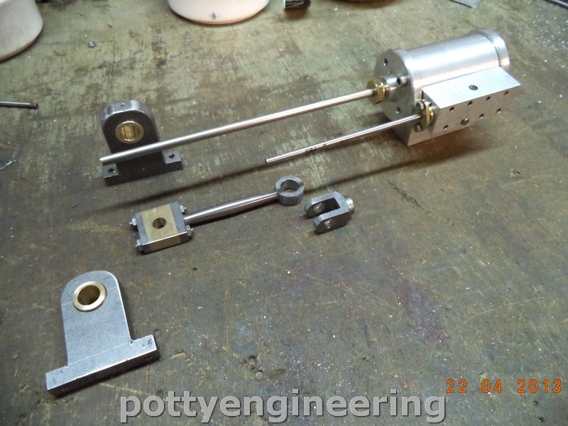

              A little more progress got the cylinder and covers along with the valve chest and base nearly completed
              Stew
              #117570
              Stewart Hart
                @stewarthart90345

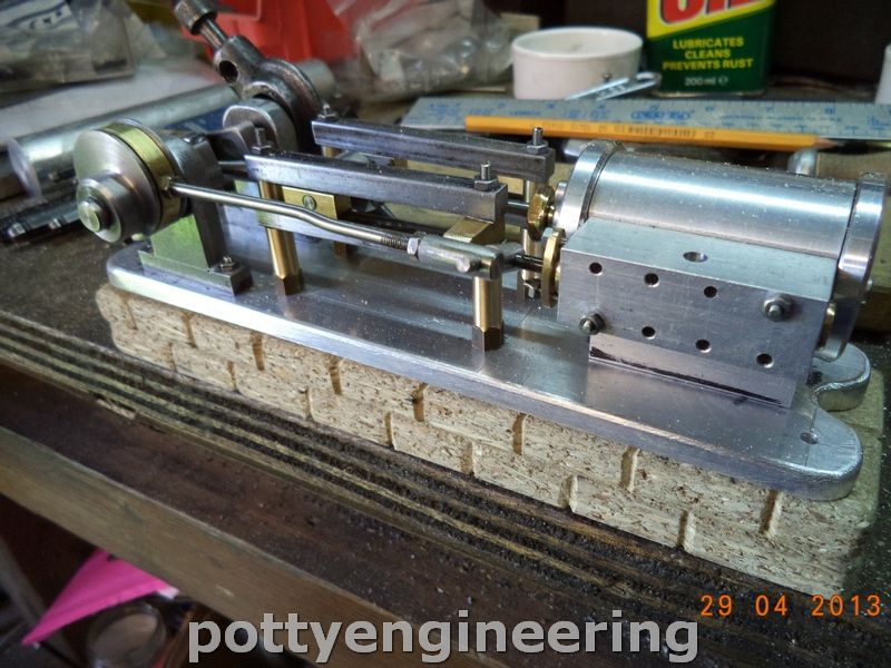

                This is how far I've got so far, its progressing quicker that I thought.
                Stew

                  #117885
                  Stewart Hart
                    @stewarthart90345
                    Its seems to be comming together very quickly, i had a sort delay waiting for some ally plate to make the engines bed plate from.
                    Any way this is it so far, the fly wheel is a 4" dia Stuart wheel that I decided was too small for another engine I was building, for this one I think I may fabricate a fly wheel up that will be more in keeping with the origonal.
                    #117914
                    _Paul_
                      @_paul_
                      Hi Stew, engine build looks great,
                      I have a question tho how is that foot mounted on the Caliper?
                      Regards
                      Paul
                      #117915
                      Stewart Hart
                        @stewarthart90345
                        Posted by _Paul_ on 27/04/2013 02:42:37:
                        Regards
                        Paul
                        Hi Paul
                        Thanks for your interest
                        The foot is made from a chunk of mild steel I simply milled a groove across it to take the caliper, and then so the foot would sit perfectly square on the caliper I took a light skim ocross its base without removing the it from the mill first, I then drill and tapped a hole across the foot opening up half its depth to the clearance size, I then drill a hole in the middle of the groove and put a saw cut into it, this made it into a pinch clamp so that it could be fixed to the caliper, the squence of pics should make this clearer.
                        If the interest is there i could submit a short article for the mag.

                            #117944
                            martin perman 1
                              @martinperman1
                              Stewart,
                              What an excellent Idea for a set of calipers, must see if I have a piece of metal to make a foot. Why did you shorten the caliper jaw.
                              Martin P
                              #117947
                              Stewart Hart
                                @stewarthart90345
                                Hi Martin
                                So they could be used as a set of odd leg calipers, for marking out.
                                Stew

                                        OK Stew, I have to ask. What on earth is the lump at the left of this picture and where does it fit?
                                        #118092
                                        Stewart Hart
                                          @stewarthart90345
                                          Hi Neil
                                          It doesn't fit anyware:- its a deburing tool my late Dad made )
                                          Its made from a drill stub and a scrap component from the production line he was in charge of.
                                          I just like using it, I have quite a few tool he made and they kind of remind me of him, as he always seemed to get a little of his personality into things.
                                          Stew

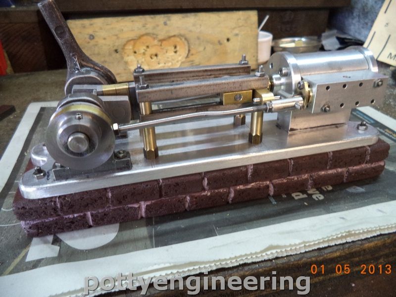

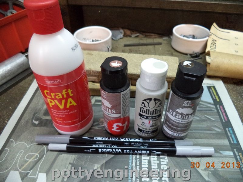

                                              When I drew the engine up I drop a bit of a cod, in that I had made no provision for adjusting the valve events, I did a bit of head scratching on how to correct this came up with some weird and totaly impractical solutions, so had a look through the pictures i took of the Bolton engine to see what they did and it couldn't be simpler:- they just link the eccentric rod to the valve rod by a simple link that could be slid along to make the adjustment.
                                              This is my take on the system
                                              Works fine though a little over scale but thats just one of the compromises you have to make. I've losly assembled the engine up and roughly set the valve events and she winds over nice, I'm waiting on the delivery of some steel tube to make the fly wheel so in the mean time I've been working on the bed plate and a mounting plynth, it was common for this typ of engine to be mounted on a stone plyth, so I fabricated on up from chip board.
                                              This is very much a suck it and see job, I'm planning on felt tipping the mortar line in and stipling it over with thin emulsion paint followed by a thin coat of mat laquer to seal thing.
                                              If any one could give me a few pointers on this it would be very apreciated.
                                              Stew
                                              #118146
                                              Ian S C
                                                @iansc
                                                For one of my hot air engines I used a similar method of construction, mine is 6" dia, I collect old brake drums, and discs, and one disc brake was top hat shape, just over 6" dia x about 1.5" high, so cut the brim/disc off, and the top/flange, the cylindrical bit left about 3/8" thick. The section with the spokes was made of 3/8" plate, this is pressed into the rim, and also held with six counter sunk screws through from the outside of the cast iron rim, on this one the hub is brazed in , on later flywheels the hub is held in place with shaft lock adhesive. The motor that this flywheel is on can run up to just over 2000rpm running with out a load. Ian S C
