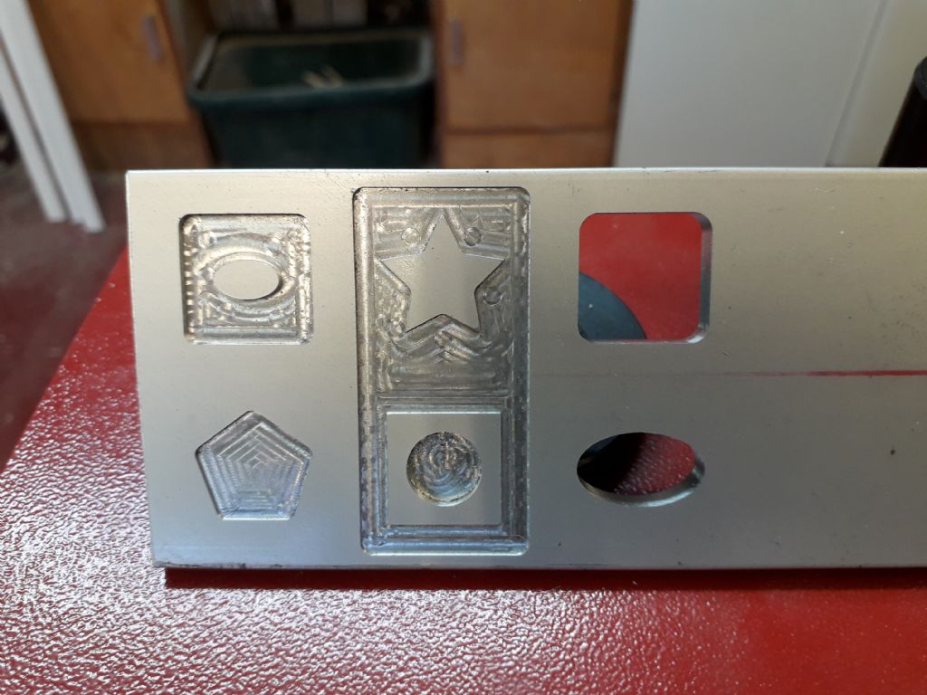

I already had them modelled in Alibre so it was just a case of exporting a DXF file and opening that in Cut2D, after a bit of a learning curve as there were a few things I had not done before in Cut2D I had the code after about 10mins. It said that I could cut the part in 8mins 23secs so allowing a second op to form the web on the opposite side 10mins each by CNC.
This is a test one in UPVC which took the 8 and a bit mins, the UPVC is thicker than the metal so it has not cut right through.

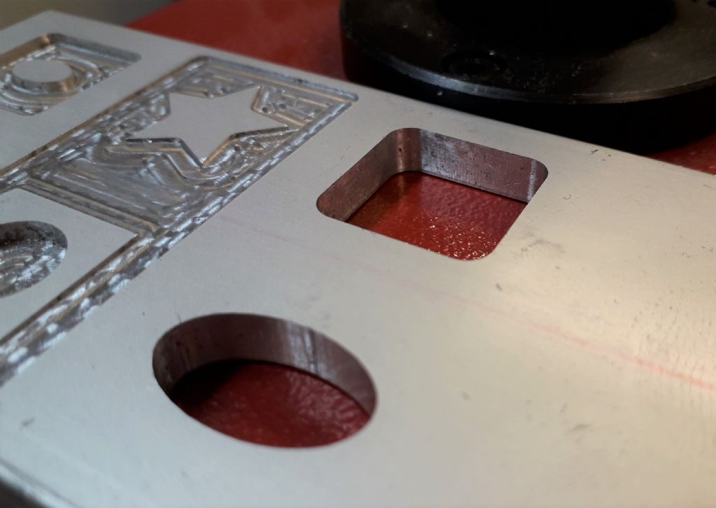

I decided to play safe and before cutting metal reduced the DOC but speeded up the spindle which added about 3mins more to the code. When I loaded the code into Mach3 I noticed an extra path on the screen (pink circle) and should have stopped and sorted it there and then but carried on with my finger over the stop button.
With about 30secs left to run the mill started to move in the wrong direction and luckily I stopped it before too much damage was done, just a nick out of the part.

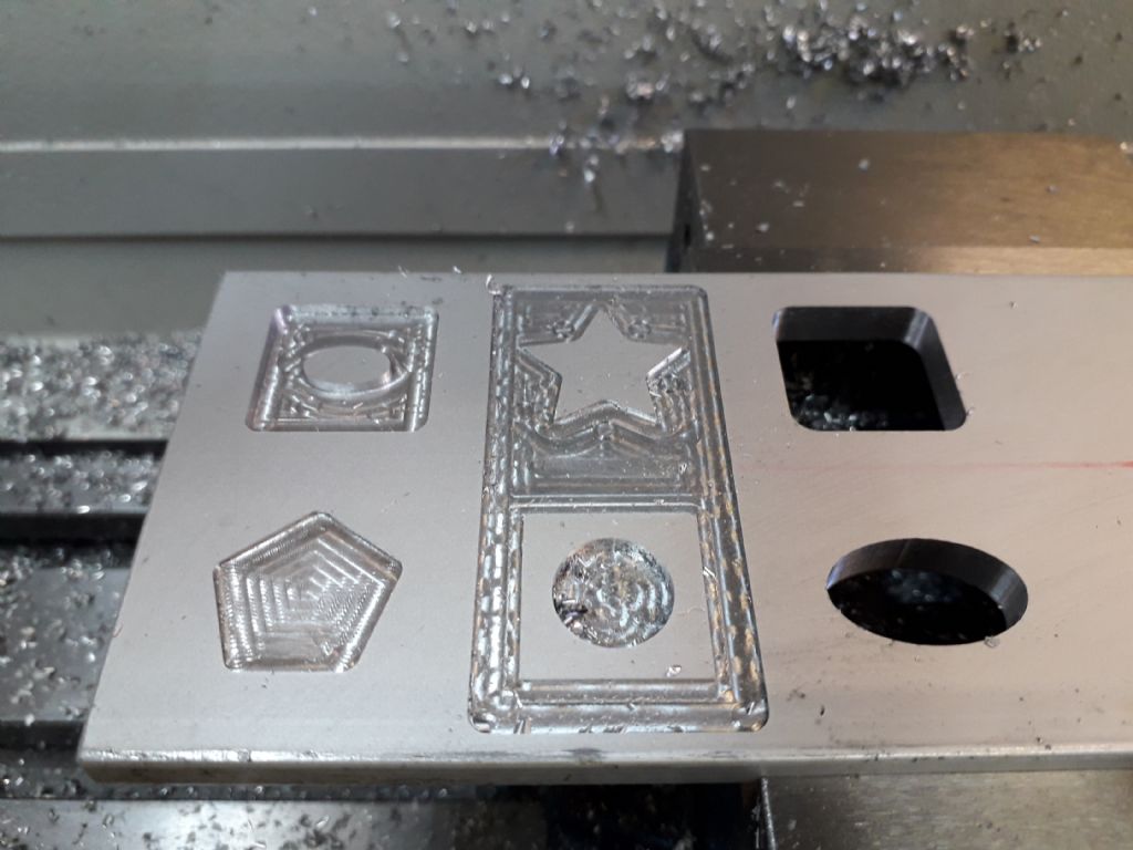

I redid the code and ran it again and all came out OK in just under 12mins, only downside was I used a bit of scrap with a hole in it.
If I wanted to finish the job then it would just be a case of flipping it over and running the first pocket code again then cutting away the tabs.
