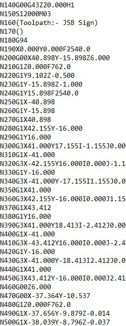

Andrew, it did ramp down before I got from mouse to camera, I had it set to ramp down over 25mm which again was too timid but better safe than sorry, it did it in the y axis along the short right hand side then moved off around the rectangle. looks like it ramps in line 220 I'm using a HSS F3 type cutter.
Looks like the ramp is line 220 and 230; it goes down by 0.5mm in 25mm and then down another 0.5mm in 25mm in the opposite direction. I normally specify a ramp as depth and angle, arbitrarily 10 degrees. If the CAM program can fit one ramp that's what it does, if space is tight it zig-zags. For pockets like the nameplate I prefer to follow a helical path. Roughly the same; specify the depth, helix angle (10 degrees again) and a radius, just less than the radius of the cutter.
