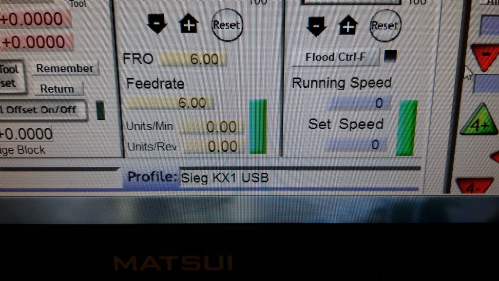

          Ian Johnson 1
            @ianjohnson1
            That is the wrong screen Jason. It should say in the bottom right corner 'Sieg KX1 USB' or for your machine 'Sieg KX3 USB'. You need the 'Sieg_USB_setup_1.6.0.0.' file. which should be on the Mach3/Sieg set up installation disc, then go to the Mach3 loader menu and the KX3 USB should be there with all the other screens for plasma, lathes etc.
            I'd post up a photo of my screen but haven't sussed out how to do it yet!

              #397460
                Ian, I did send you a PM earlier.
                However a big thanks must go to Ian as the machine is now moving and even in Z which was said to have a problem.
                In my rush this morning I looked for the USB file in the Mach3 folder that had been installed, I should have looked on the actual disc as Ian said, click that and the two new profiles for the KX1usb and KX3 usb have been added. On startup just click your machine and no other setup to do.
                As it is not in the manual, at least the one I have I'll take a couple of photos and post in detail as it may help Neil or any others buying the remaining KX1 machines.
                Thanks again Ian, J

                Ian Johnson 1
                  @ianjohnson1
                  Just got your PM Jason glad to help out. I am hoping this forum can be a good source for CNC knowledge especially as the small cnc support has gone.
                  I've sussed out photos too! This is my screen:

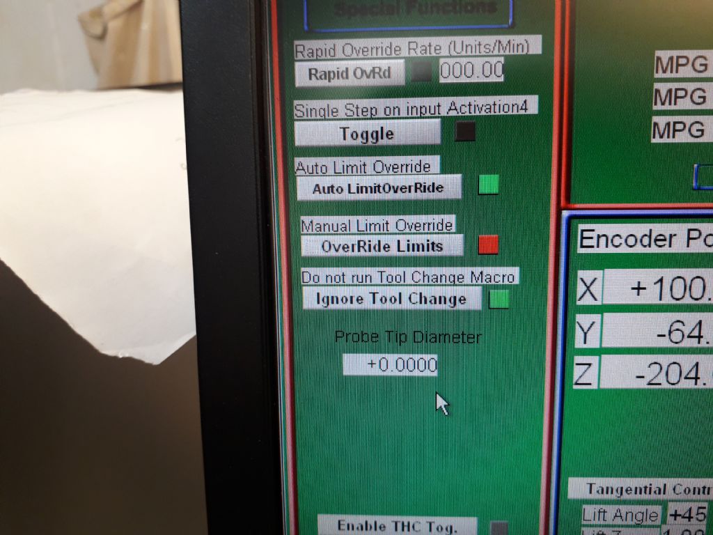

                                        Thanks all, some more things to look at.
                                        X&Y limit switches are micro switches and in line and it also seems possible to jog straight past those too!
                                        The upper Gib adjusting screw was certainly loose so will look closer there. This one just has a coil spring to take the weight not a strut – down the right hand side in the second video.
                                        My other thought was to see if I could set the max feed rate slower for now.
                                        One thing I did notice that I was going to read up on was that the "overide limits" was flashing red and clocking the text box to the left did not change that.

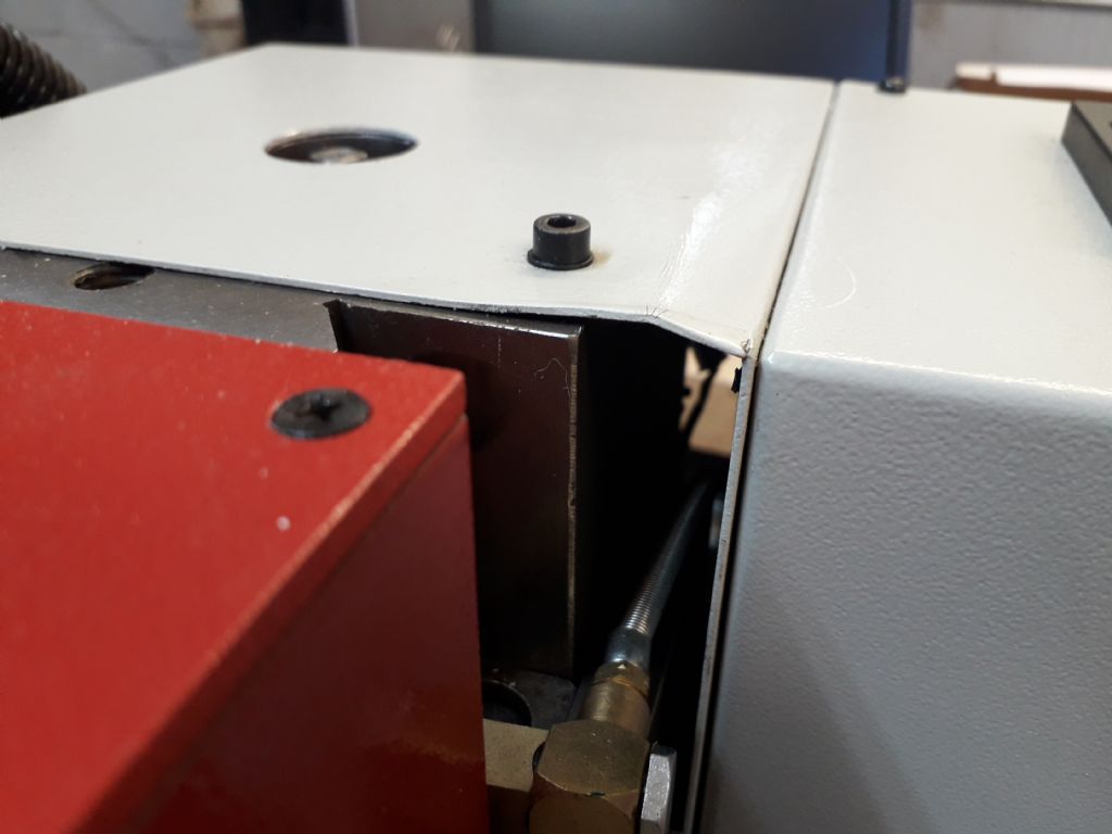

                                          #397727
                                            The way the micro switches are positioned there is no way they can be crushed if things overrun, will take a photo later
                                            Unlike the machine that does get damaged when the Z is driven past the stops, see how the case has bent where the oil union has got squashed

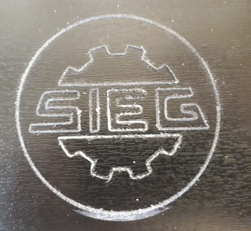

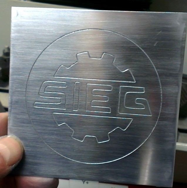

                                                  I have slowed the Z axis motor down which seems to allow it to move without complaint. Ian @ ARC sent through my licence file earlier today so I could run a longer set of code to see what came out.
                                                  Not the ideal cutter and the work was a bit thicker towards the bottom hence the scuff mark on the circle but for a first go I'm quite chuffed.
                                                  Thanks again to Ketan and the guys at ARC.

                                                  Ian Johnson 1
                                                    @ianjohnson1
                                                    Yay! making progress now Jason. I think every Sieg CNC owner has one of those!
