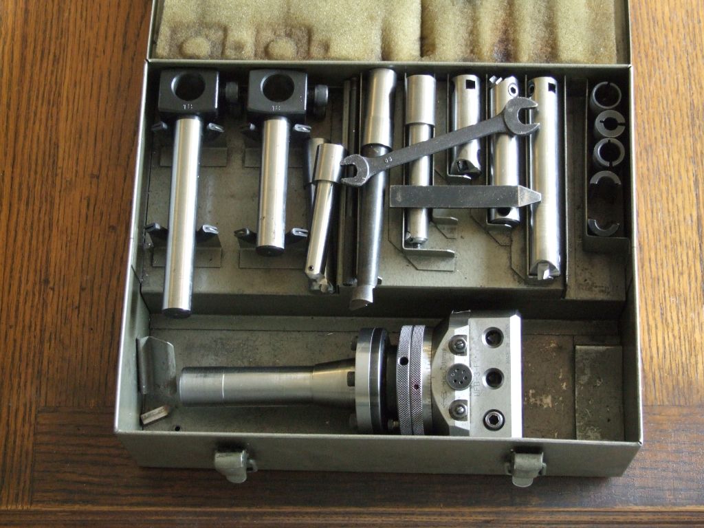

                                  #647578
                                  Anonymous
                                    Addendum
                                    Over the past few months I have continued to look for a boring and facing head for my Bridgeport mill, without much success.
                                    Recently I looked at a Wohlhaupter UPA2 head, but it didn't have any accessories and had an integral Morse taper shank. The seller also used the "I don't know anything about this" routine when asked if it was in full working order. I then looked at a Wohlhauper UPA3 head in excellent condition with a full set of accessories and a helpful seller. But sadly it had an integral MT3 shank and I couldn't think of a satisfactory way to replace the shank without a lot of work, and devaluing an expensive item.
                                    Then I lucked upon a Kuroda UFB-3-F head with an R8 shank and a full range of accessories. A big plus was that the seller was 15 miles away. After an exchange of messages I went to look at it yesterday. The head is in good condition, plus the seller was a professional machinist and clearly knew his way round the unit. He had bought it from his workplace so also knew it's history. The upshot was that I agreed to buy it and he let me take it away on a promise of paying today. Here is the box of goodies:
                                    The only downside is that one of the sleeves has been split, although it is still usable. The extension arms look to be unused and it even comes with the tapered lever for pulling and pushing the various pins in and out. Everything seems to work as it should and there is no evidence of any crashes. Of course the acid test is to run it on the Bridgeport, which I will do later this week.
                                    I'm not going to say how much I paid as it will probably upset some people. Let's just say I fall into SoD's category of those who like to own, and use, nice tooling and am fortunate enough to be able to afford it. No significant other to stop me for a start!
                                    Andrew

                                      Andrew that looks to be a nice bit of kit, nice to have the provenance as well, good quality tooling like this is getting harder to find and when you do find it you have to pay well for it. I also like to own and use nice tooling but mine usually costs me double because the wife wants sewing machines or patchwork material to the same value!
                                      #647583
                                      DiogenesII
                                        @diogenesii
                                        Nice, it's funny how you can scour the country for months and then the ideal thing turns up on the doorstep.
                                        Even the box looks straight which is a good sign for something from a works.

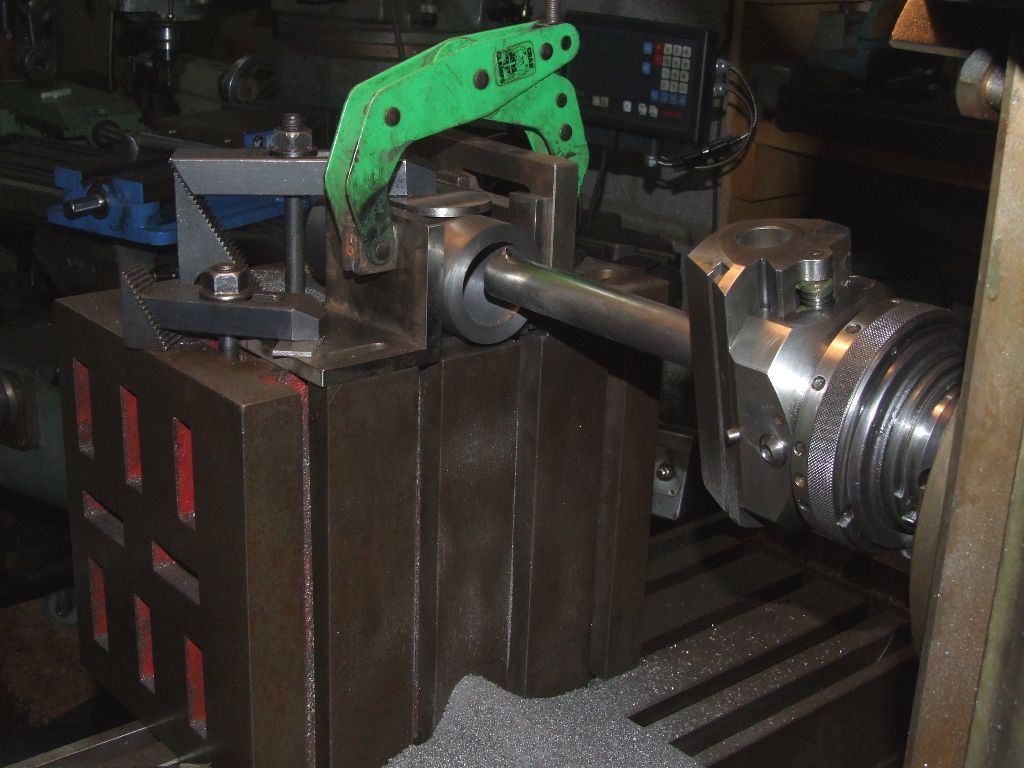

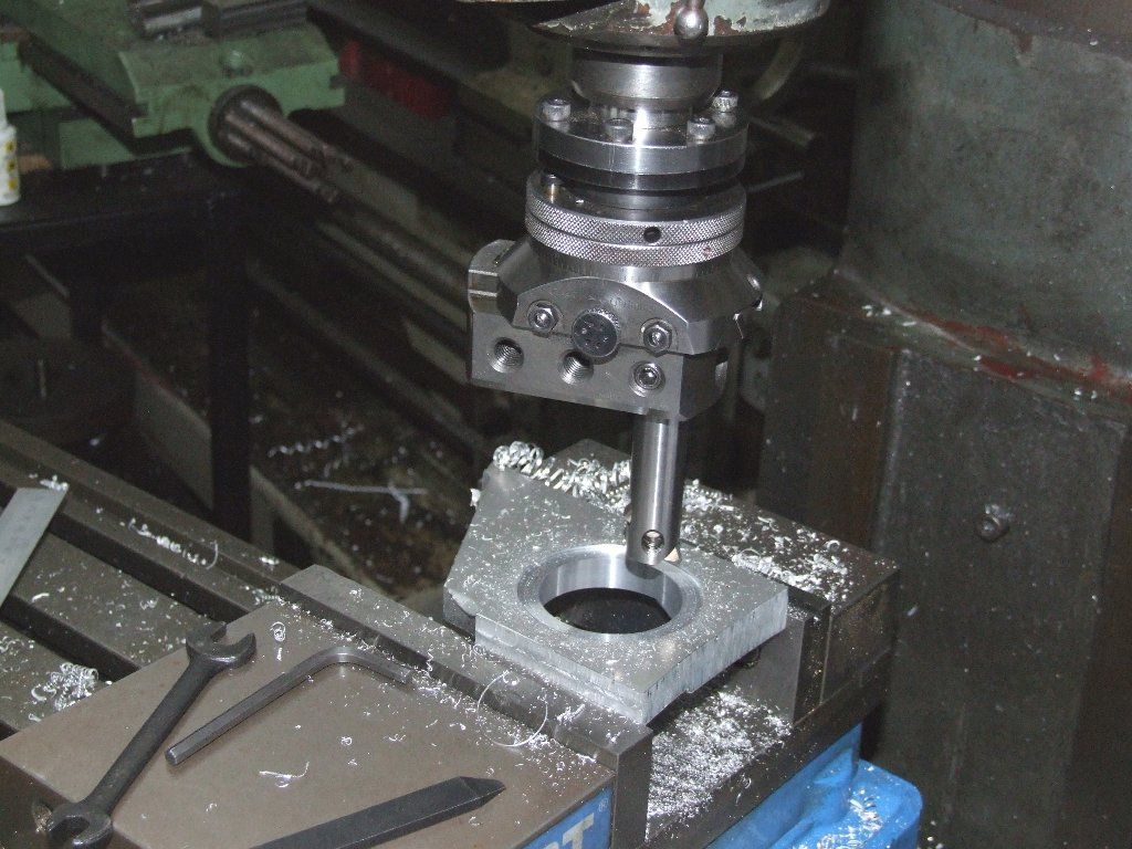

                                            #648019
                                            Anonymous
                                              I've been playing with the Kuroda boring head on the Bridgeport this evening, boring and facing:
                                              All functions seem to work and the head is a joy to use. Put on a 0.025mm cut and as near as I can measure the hole diameter increases by 1 thou (I don't have any metric internal micrometers). it was simple to get the hole diameter to size within a couple of tenths, on the micrometer reading at least.
                                              I like using nice tools. teeth 2
                                              Andrew

                                                Agree with Andrew about boring heads not being able to run fast enough to get the benefits of carbide, HSS still has its place for certain things.
                                                #648050
                                                Anonymous
                                                  Forgot to say that for the trial cuts I used a 6mm square HSS toolbit that came with the boring head.
                                                  Andrew
