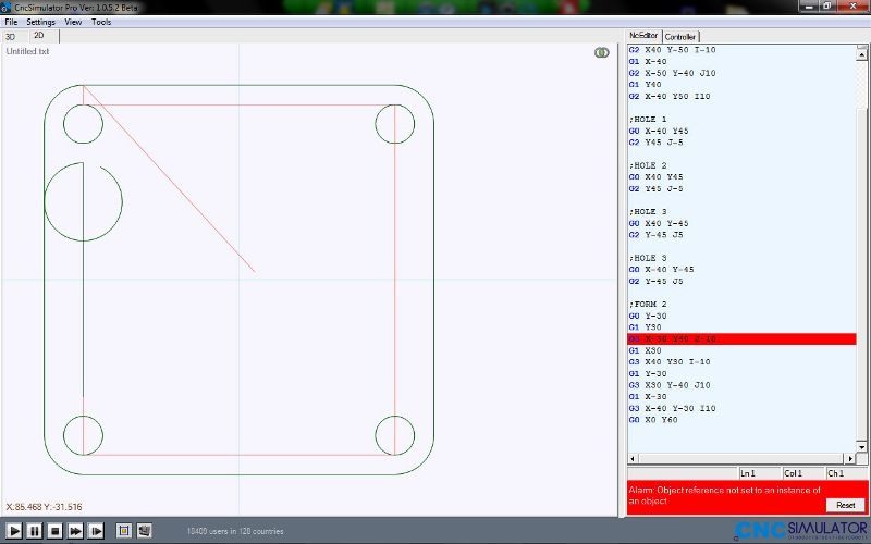

                      #97585
                      Jasmine
                        @jasmine
                        Right guys
                        Just got back from Paris and managed to get started on some G Code.

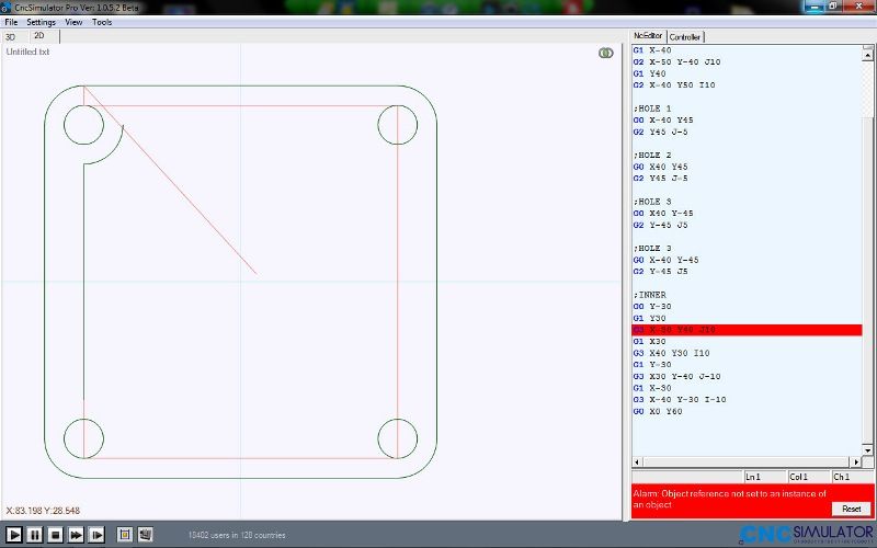

                        Starting off small and simple but, I keep getting errors, see below
                        When using NCCAD I get a Y Axis error at the first line……any ideas boys?
                        [IMG]http://i266.photobucket.com/albums/ii276/crash_photos_01/CNC_Help.jpg[/IMG]
                        ;OUTER
                        G0 X-40 Y50
                        G1 X40 F400
                        G2 X50 Y40 J-10
                        G1 Y-40
                        G2 X40 Y-50 I-10
                        G1 X-40
                        G2 X-50 Y-40 J10
                        G1 Y40
                        G2 X-40 Y50 I10
                        ;HOLE 1
                        G0 X-40 Y45
                        G2 Y45 J-5
                        ;HOLE 2
                        G0 X40 Y45
                        G2 Y45 J-5
                        ;HOLE 3
                        G0 X40 Y-45
                        G2 Y-45 J5
                        ;HOLE 3
                        G0 X-40 Y-45
                        G2 Y-45 J5
                        ;INNER
                        G0 Y-30
                        G1 Y30
                        G3 X-30 Y40 J10
                        G1 X30
                        G3 X40 Y30 I10
                        G1 Y-30
                        G3 X30 Y-40 J-10
                        G1 X-30
                        G3 X-40 Y-30 I-10
                        G0 X0 Y60

                            Third time lucky with the screen grab

                            #97590
                            John Stevenson 1
                              @johnstevenson1
                              What happens if you change the first two I's and J's to negative then the last two to positive ?
                              Not familiar with a code that doesn't put I's and J's on the same line
                              ;INNER
                              G0 Y-30
                              G1 Y30
                              G3 X-30 Y40 J-10
                              G1 X30
                              G3 X40 Y30 I-10
                              G1 Y-30
                              G3 X30 Y-40 J10
                              G1 X-30
                              G3 X-40 Y-30 I10
                              G0 X0 Y60

                                Opps!!! face 4 This makes things go a little crazy………
                                I guess this may have something to do with G2 & G3 being CCW & CW????

                                      I assume the inner is causing the problem? It looks like you are going clockwise around the outside (correct) and clockwise around the inside (incorrect). Also, no obvious G41 either.
                                      You don't have a X start point which should be -40 + at least half the cutter diameter + 1mm or so, probably about -46 assuming a 10mm cutter, but it might have been set up by a previous move.
                                      I think G3 should be G2.
                                      The easy way to remember which way is which is G3 = 3 letters – CCW for counter clock wise and G2 is two letters – CW for clock wise and the program is definitely going clockwise.
                                      I and J on their own are fine john. As the other centre of the radius dimension is correct it is not needed, the program/machine will assume the start point is the radius centre..
                                      I or J 10 or I and J – 10 is just the offset in the direction of the 10 mm radius centre.
                                      The only thing I can't remember is if the + 10 and – 10 and relevant moves should be in incremental. Too long ago since I programmed.
                                      I am assuming that you are cutting the profile outside.
                                      If inside, the cutter must be less than 20mm diameter (10mm radius) or that will stop it working.
                                      Post the complete program as a text file if not too long.

                                        The screen dump seems to be of a simulator run from some G code that you have hand written. Your code looks ok to me; obviously the outer profile and the four holes are shown correctly. The move that seems to be causing the problem is:
                                        G3 X-30 Y40 J10
                                        The screen dump shows this move correctly, ie a CCW move starting at X-40 Y30 ending at X-30 Y40 with the centre of the arc at X-30 Y40. This means that your system is set to use absolute coordinates, with the I and the J values as incremental.
                                        One slightly unusual aspect of your G code is that you have omitted I and J values when they are equal to zero, and X or Y coordinates when they have not changed since the last move. Some CNC controllers allow this some don’t; your simulator seems happy with this for all the outer moves and the four holes.
                                        I would suggest you try the following on the offending line of code:
                                        1) Explicitly set the I value to 0, just in case, ie.
                                        G3 X-30 Y40 I0 J10
                                        2) Erase the line and then re-type it, in case there are some non printing character embedded, or if you’ve used the letter o in place of the number 0. It sounds silly, but I have seen it happen often enough.
                                        3) Check that there are no typos in the line following the highlighted line, or indeed in the rest of the program, sometimes the location the program stops at is not exactly where the error is located.
                                        The error message is as helpful as most error messages are…. It will mean something to the programmer who wrote the simulator, but no help to anybody else!
                                        You obviously understand G codes, so don’t be afraid to experiment, try different values and shorter program snippets until you find what is causing the error. As far as I can see there is nothing obviously wrong with the program you have listed.
                                        Chris

                                          Yippee finally cracked it wink 2 enlightened thumbs up
                                          It appears that I needed to have both I & J values when using the G2 or G3 command even if they were zero.
                                          I have actually managed to cut my very first piece today, thank you all so much
