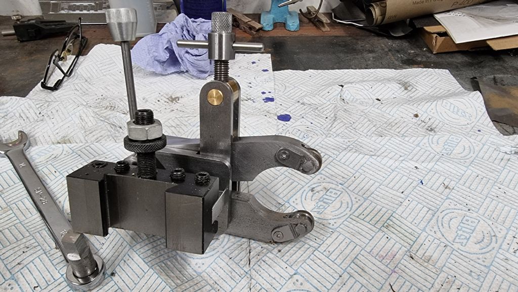

                    Well after quite a few months , I finally made the Hemingways sensitive knurling machine. I thoroughly enjoyed the whole project. It came with brilliant drawings , but no instructions. But after much head scratching & a bit of info from some members I got there. Below are a couple of pictures of the finished article. Also a link to the youtube vide part 1. If anyone is thinking of making one then please watch away. If not then don't bother as it is 8 parts long & will send the pro's to sleep.
                    It was made using the Myford Super 7B lathe & the Tom Senior milling machine. With plenty of work on the rotary table which was a great bonus to have. Hemingways sensitive Knurling tool
                    Pictures below.

                      Looks good Steve, Must catch up on the last few vids, I'm looking forward to some nice knurls.
                      #570517
                      Nicholas Farr
                        @nicholasfarr14254
                        Hi Steviegtr, yes, a tidy looking job.
                        Regards Nick.
                        #570536
                        Howard Lewis
                          @howardlewis46836
                          An end to your problems!
                          And nicely done.
                          Came in too late to suggest the Hemingway clamp tool, so have to say a good choice.
                          Wherever possible, I use the clamp type of knurling tool.
                          Only use a single wheel knurl when absolutely necessary, (Want a straight knurl and only have a single straight wheel ) because of the loads that it imposes on the bearings in the Headstock (And my machine has taper roller bearings! )
                          Howard

                              Thanks for the comments. I did have another go yesterday with slightly better results. My main problem is the QCTP is rotating on its stud . So i either need to pin it or try to get the knurling device closer to the post.
                              The problem is the hand lever is to the right & fouling against the toolpost. So i may strip the knurler & move the handle to the left side.
                              Steve.
                              #570885
                              bernard towers
                                @bernardtowers37738
                                Don’t quite get why your QCTP is moving as if the knurling wheels are centralised on the workpiece this doesn’t put a strain on the QCTP or are you trying to traverse the tool with too deep a cut on the wheels, try traversing several times with slightly deeper settings each time. As far as movement of the toolpost is concerned make sure it is squeaky clean and has a relief in the underside putting the pressure towards the outside edges of the toolpost. The tool I made I put the lever to the left , makes it more comfortable to use.
                                #570887
                                Steviegtr
                                  @steviegtr
                                  Bernard that is what I have done today. Moved the lever to the left. Works much better now. Yes it was traversing which caused it. Some members shun doing this but did not seem to effect the knurl. I have done a little I'd which I will be posting soon. Showing what I did.
