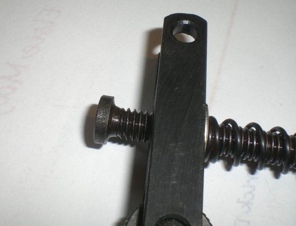

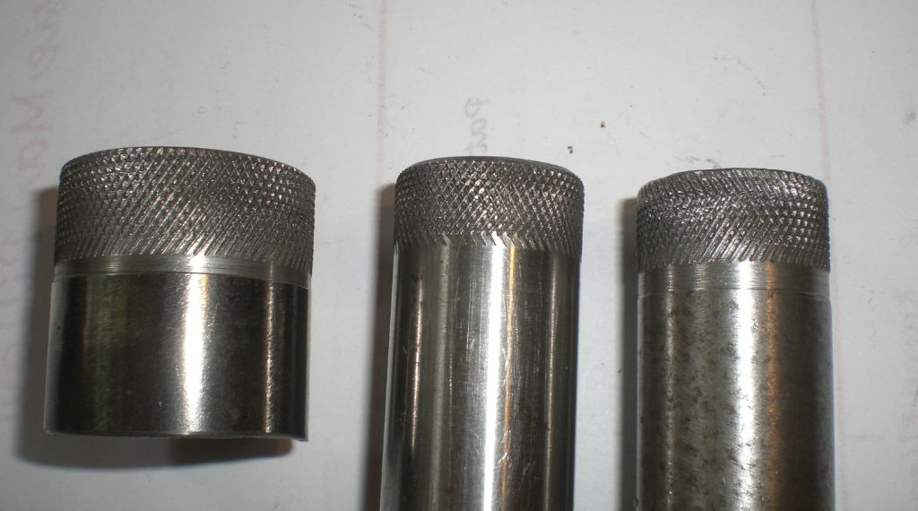

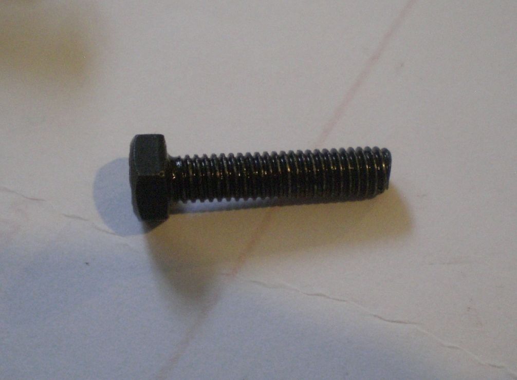

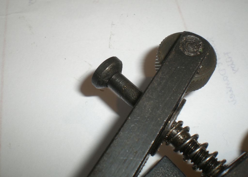

            #558291
            Nicholas Farr
              @nicholasfarr14254

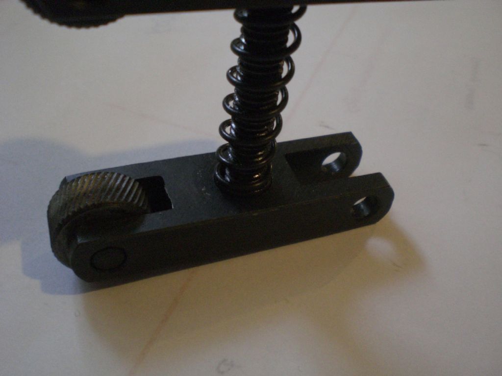

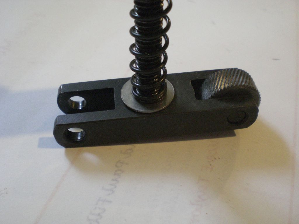

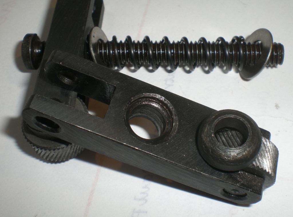

              Hi, my curiosity about the tool Steviegtr bought, lead me to buying one myself and I have to say that his frustrations with this product are valid. Upon inspecting it, it does have a lot of side-play in the arms relative to the holder, this is somewhat due to the use of setscrews holding them in place, but also as there is a 0.27mm clearance between the arm clevis's and the holder, this can be reduced but not eliminated, by using bolts with a plain shank the length of the arm clevis.
              I don't know about Steve's one, but mine didn't come with washers between the spring and the arms, this leads to the spring dropping into the small chamfer in the bolt holes and locking the whole thing in certain situations.
              Adding a thin washer at both ends of the spring, prevents this locking up happening.
              The next thing I noticed, is the bottom end of the bolt has a square edge to it, which also locks the tool when adjusting it down to it's smallest sizes, but also reduces the floating action somewhat, between fully open down to the smallest size.
              My small scissor type bolt has a radius edge to it, which seems to stop this type of locking, happening.
              Lastly, I don't think the shape of the dimple for the radiused top washer is quite the right shape or quite a large enough diameter, which allows the tool to kind of lock when using it with the arms on the two inner holes for using on smaller size diameters.
              I did three samples with the tool, the first one from left to right in the photo below, was with the setscrews in place and was done on a piece of trued up black steel pipe, which is about 33mm diameter on the outside, the second one was done on a piece of 25mm EN8, but the set screws were replaced by plain shank bolts and the third one was done on a piece of 25mm unleaded mild steel, all of these were with the washers in place at each end of the spring. I think the worst result is on the mild steel one, but it can be clearly seen that the side-play in the arms move the knurl's out of line with each other in the opposite directions. I think it is clear that this tool does need some reworking done on it to make it a satisfactory tool to use and it may mean making a new holder to reduce the clearance in the arm clevis's and bespoke clevis pins to reduce the slop in the holes that hold the arms in place. Whether one thinks it is poorly made or not is up to the individual as it does work, but certainly not to a high spec.
              Regards Nick.
              Edited By Nicholas Farr on 15/08/2021 09:34:16
              #558295
              Tony Pratt 1
                @tonypratt1
                Nick, absolutely typical of most far eastern 'tooling', all the elements are there but so poorly executed as to make the tool completely unusable as purchased.
                Tony

                    Hi Steve, I spent two to three hours on Friday evening examining it in a logical and methodical way before I even attempted using it, the set-screws were the first obvious fault followed by the lack of the washers, I've seen set-screws used in similar situations during my maintenance years and it always caused slop and fast wearing of the clevis and the yoke holes. I was not biased by anybody's opinions in my assessment and if it had no faults and could be used to what I think was an acceptable standard, I would have said so and I will stick by that, whatever anyone says.
                    Regards Nick.

                              #558409
                              Nicholas Farr
                                @nicholasfarr14254
                                Posted by SillyOldDuffer on 15/08/2021 16:13:21:
                                Posted by Emgee on 15/08/2021 14:24:15:
                                Posted by Vic on 15/08/2021 12:06:06:
                                The clamp type knurling tool I use was made by a now passed toolmaker, although there is a fair amount of sideways movement (slop) of the arms in the yoke it doesn't affect knurling…
                                Emgee
                                Emgee's post and my experience suggest sideways slop doesn't matter much, and why should it? Correctly adjusted knurl wheels follow their own grooves and the forces keeping them on track are considerable. The tool doesn't depend on being well made. Clamp knurlers are an inexpensive solution to an ordinary problem, not high-end production tools. Are chaps assuming clamp knurlers are precision instruments?
                                Cut
                                * One test showed professional Wine Judges forced to rely on taste alone were unable to tell the difference between Red and White Wine…

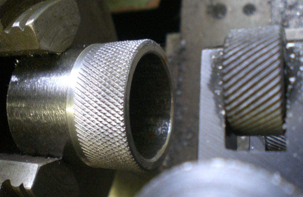

                                Hi Dave, If you have ever had anything to do with rotary kilns, you will know that skewing the support rollers will alter the tracking of the kiln depending which way one or more rollers are skewed. The fact that the knurls on the tool in question have a helical pattern, they will act as is if they are skewed to the bar being knurled, but because the bar is relatively unmoveable, the knurls themselves will be forced in opposite directions, whether there is any slop or not, but yes, once the knurl has been formed they will follow there own grooves.
                                The photo below shows the tube that I did and it can be seen that the edge of the knurl close to the chuck only has the pattern of the top knurl in the tool for approximately 2.4mm, which is the same amount of slop of the two arms that can be moved away from each other by hand when set apart at the width at which the tube was knurled at, the bottom one moved away from the chuck and could be seen just beyond the end of the tube. The direction the knurls were force apart, followed the laws of skewing with the relative direction of rotation of all three rotating parts and the corresponding angle of the knurl patterns.
                                Regards Nick.

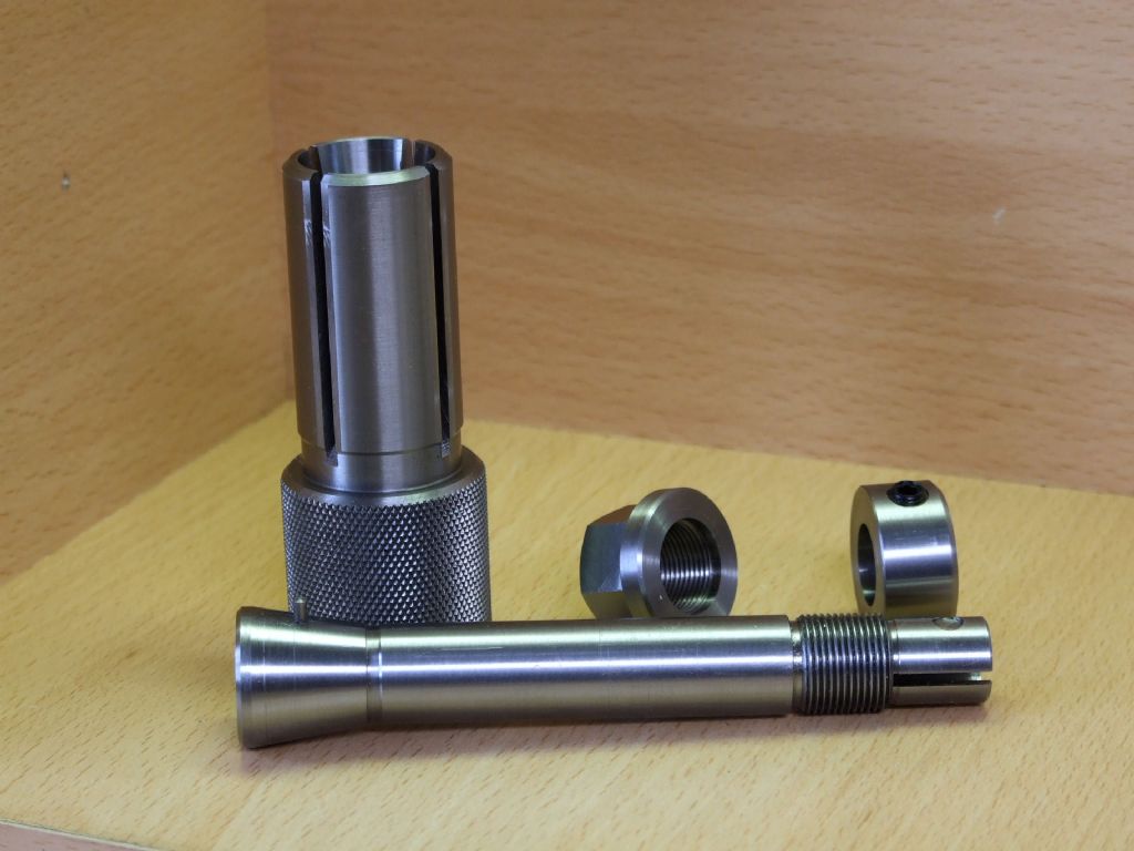

                                    Graham Meek
                                      @grahammeek88282

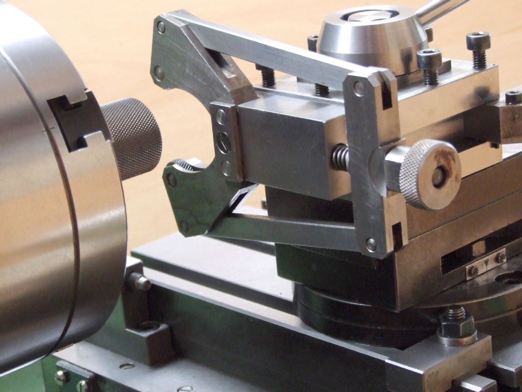

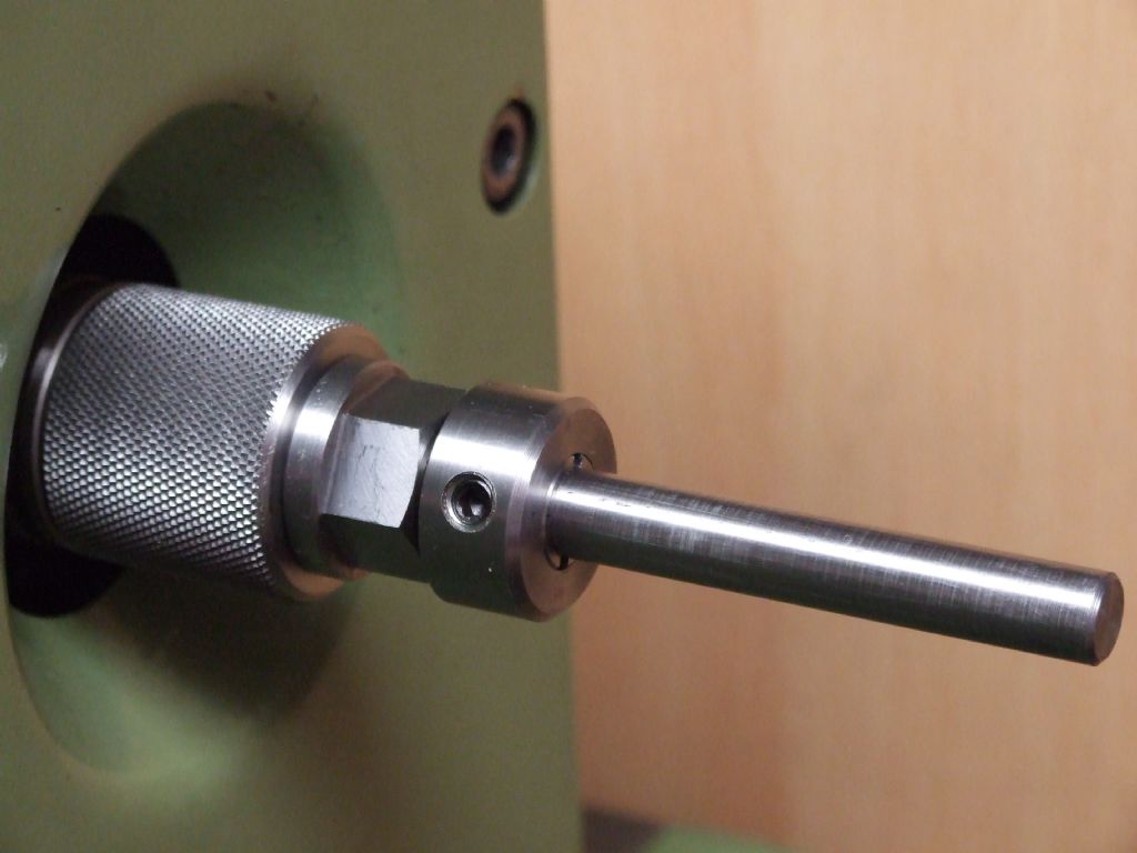

                                      A while back in this post I outlined the faults with the commercial knurling tools. Nick's photograph above clearly demonstrates what I said, a picture paints a thousand words.
                                      Given the time so far expended on this discussion and the steps necessary to correct the faults with commercial knurling tools. To my mind it is easier to start from scratch with a known and proven design, and not necessarily mine.
                                      As regards spending loads of money for state of the art knurling tools which only get occasional use, (even in the Meek workshop). To me this does not make financial sense, but each to his own. The only time I have found the more expensive knurling tools of benefit is when knurling Brass. As they produce a crisper pattern in this material. The manufacture of ones own cut knurling tool is no big deal, the knurls are a tad on the expensive side though.
                                      I have attached photographs of the work produced from my meagre home brewed kit. The only cost of this standard of work is, financially for the knurls, and my time in making the equipment. The materials came from the scrap box. When I put this tool in the tool post I have the satisfaction of knowing that I made it, and more importantly it will produce the goods. The reliability of my knurling tool to produce good quality work first time has more than repaid for the time expended in its manufacture. "Does exactly what it says on the Tin" comes to mind. Click on the photographs for a closer look.
                                      Regards

                                        Looking at the picture Nick posted I have experienced the same but only when traversing the knurls to get a greater width of knurling, The second point I made in my earlier post was regarding the fit of the knurls on the pins and fit between the spindle yoke, these are important and what I believe lead to a good working tool.
                                        I remember years ago there was an article in ME about calculating the correct diameter for a given knurling operation, although I believe it is a good method I tend to give another 1/8 of a turn on the nut if the knurl doesn't look as required, it usually works OK.
