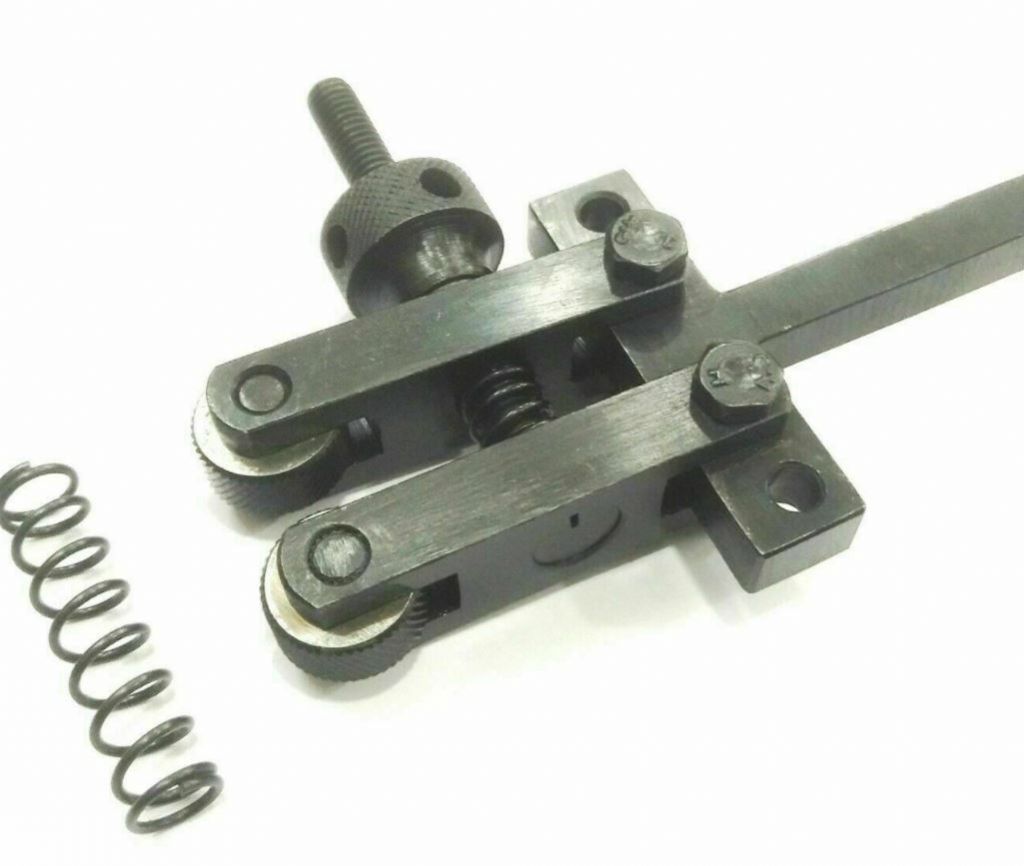

                    Well guys & gals, for anyone who wants to buy a cheap & cheerful knurling tool. Here is the conclusion i came to. Some of you will say i was not using it correctly. But really it is not fit for purpose.
                    I know there are certain members on here that do not want to be my bestest pal, but this is not worth buying.
                    Steve.

                        Did not bother to watch it all Stevie so you may have figured it out.
                        The other two holes in the "tee" piece are so the arm positions can be adjusted to get you close to size and then the top screw is used for final adjustment that way the top arm does not end up pointing down much when knurling small diameters.
                        Set height by toolpost adjuster so bottom wheel just contacts when hanging down, then set top wheel to just contact with it pivoting in a suitable hole. Move away from work to tighten tool and then advance into rotating work. There is sufficient movement of the lower arm to allow it to move up for the depth of the knurl.
                        Maybe it's not the tool that is "not fit to use" wink 2
                        Although the 3/8" shank may fit a Myford it is described as an industrial tool and really suits a bigger machine where the shank can be set at a better height but you have fallen into the trap of buying bigger tools before and had to alter them.
                        Edited By JasonB on 07/08/2021 07:42:15

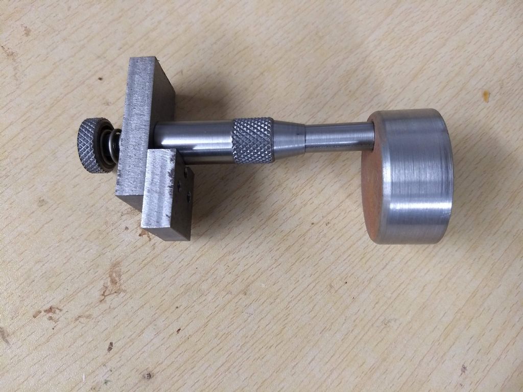

                            This is the knurling tool I made for my mini-lathe using a dedicated tool post.

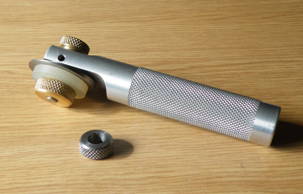

                                I've often wondered if the same concept could be adapted to a lathe mounted version. Bottom arm on some sort of pivot'n slide mount so the lower knurls could take up the correct position on the job. Just lean on the top to cut. Flip top over to extract job.

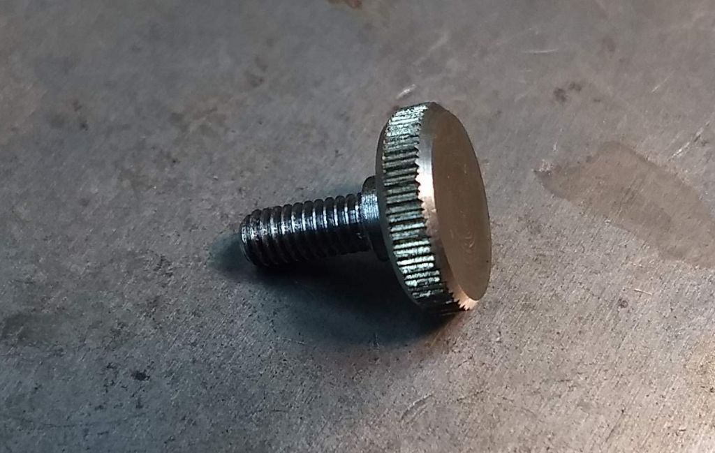

                                  Bit late in the day, but choice of knurling tool depends on what the knurl is for, and how many are needed.
                                  In my utilitarian workshop, I mostly make things for practical reasons. I'm not into fine models, and rarely care about decorative qualities, because what I make rarely needs to look good. I paint to prevent corrosion, not to improve the aesthetics.
                                  Knurling is done decoratively and/or to improve grip. Decorative knurls have to be consistent because the eye is so good at detecting flawed patterns. Cut knurlers are the go to tool for manufacturing these in quantity with minimum rejects. Bump knurlers are fairly consistent but a bigger stiffer lathe is needed than most hobbyists own. Scissor knurlers allow small machines to produce workmanlike knurls, but they're not particularly consistent. There's a bit of a knack to using them, and I wonder how many poor results are blamed on the tool rather than the operator. Maybe psychology kicks in: the beginner having failed to get acceptable results from an inexpensive tool leaps to the conclusion the tool is at fault. No excuses when the expensive replacement arrives: the learner has to learn how to use it, and does!
                                  Consistency isn't important if the knurls only purpose is improving grip. More important that the knurl be blunt to reduce abrasion. As even well-made knurls on heavily used tools damage the operator, knurls are discouraged in industry. Anyone who doesn't believe me is invited to ride a push-bike fitted with knurled metal handles along a bumpy country lane!

                                    Cut knurling seems to produce a better result.

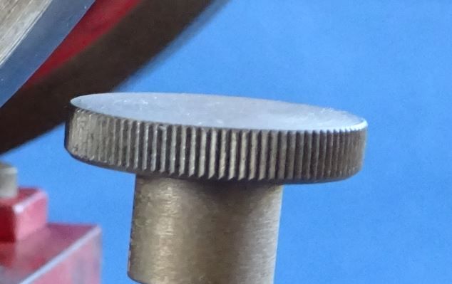

                                      These were done with my clamp-type tool. Examples in aluminium, brass, MS, SS. and silver steel.

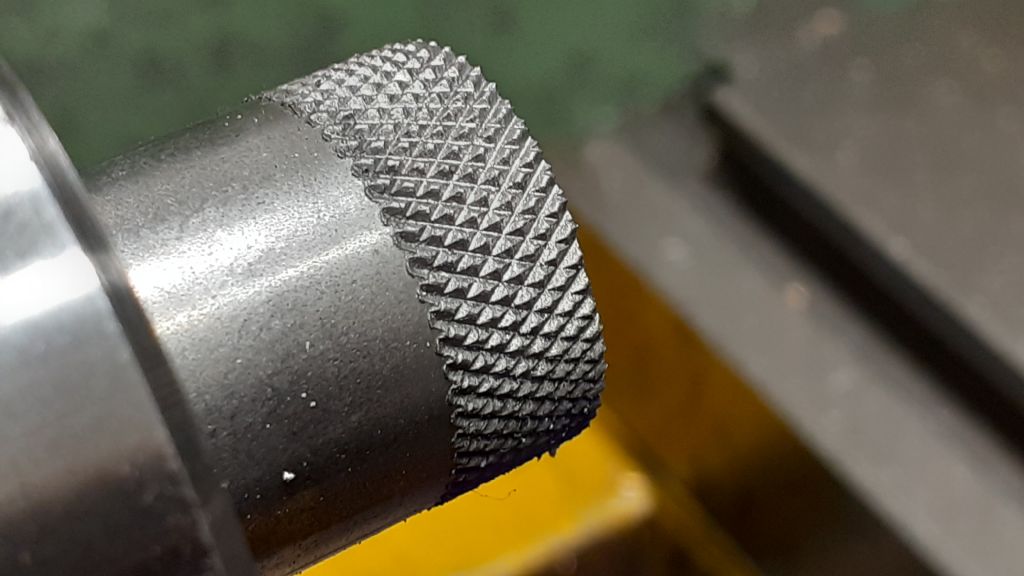

                                          Stevie, most of what I said in that post was how to set and use that tool correctly, at least if you set it up and use as intended you will be in a better position to say if it is rubbish or not. As you did not have it set correctly who knows where the fault was?. I think RDG even supply a shorter spring with it for when the arms are positioned closer together. Nowhere is I say it was good and would work, just to at least give it a fighting chance by using it correctly.
                                          Fitted with smaller spring and arms moved closer together.
                                          Your biggest problem will be having the range of tool post height adjustment to set it properly as unlike the similar priced one they sell as for the myford it does not have fully swinging arms. RDG even say it will fit some myfords depending on toolpost and as you have had toolpost "issues" in the past you may not be able to get the range of movement of the shank. I have that one in my link and it works fine for me even with short arms and the adj nut near the working end..
                                          Your other problem with it seemed to be adjusting the nut close to the chuck, I and at least one other poster have said to do it away from the chuck and then advance the tool, This is simple safety advice but if you are happy putting your hands near the moving chuck then that's fine with me.
                                          Crisp enough for me both 20mm steel EN1A
                                          Edited By JasonB on 11/08/2021 09:46:43

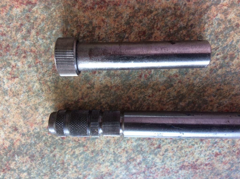

                                              Hemingway sensitive tool just after building, lower is 1a upper is 31648d54dbe-0d33-48bf-bb1a-21a6188dc903.jpeg
