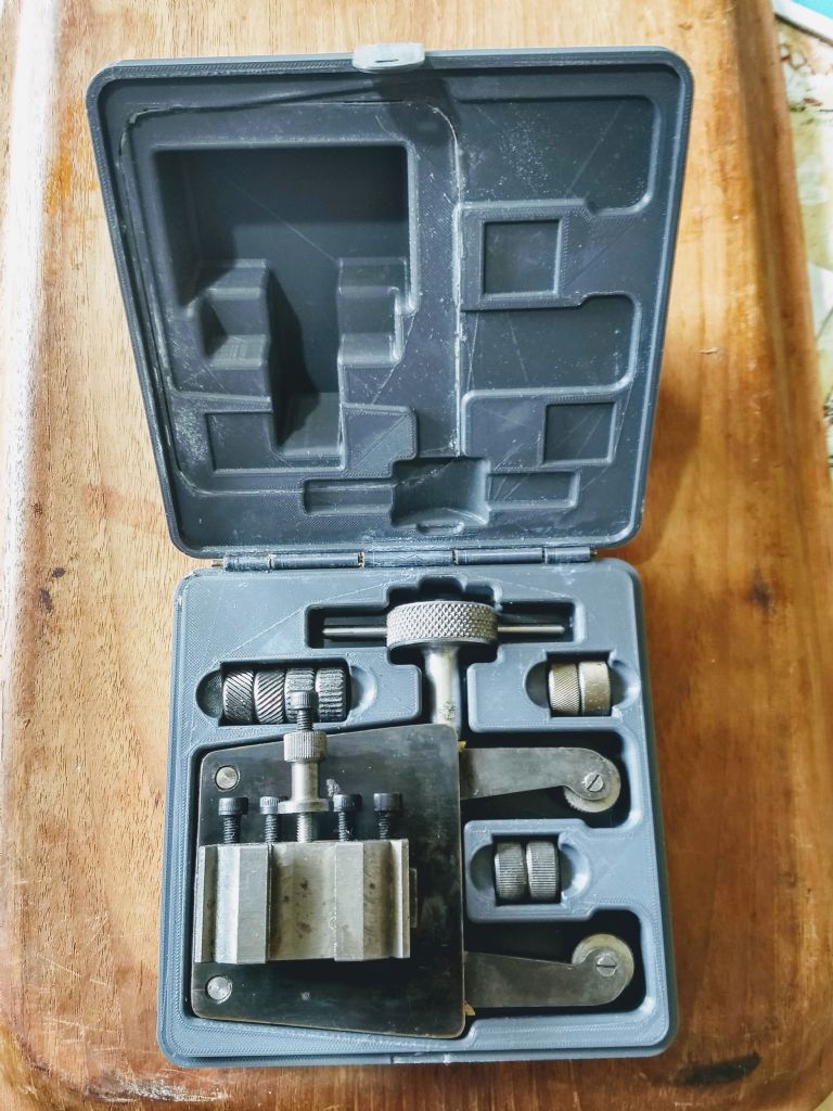

      Being really cheeky here. I know it has been done to death, but the knurling tool i bought from a sponsor on here is . Well lets say a bit to be desired. So i looked at the scissor type knurling tool & that is what i would like.
      The only ones i can find are from India, yes they are catching up. Unfortunately they do not look very good quality. So with that i would like to buy some stock & make one as a project. The cheeky part is does anyone have a cad drawing or even a pdf of one that i could cadge from.
      Steve.

            Have a look at Hemmingway's offering here

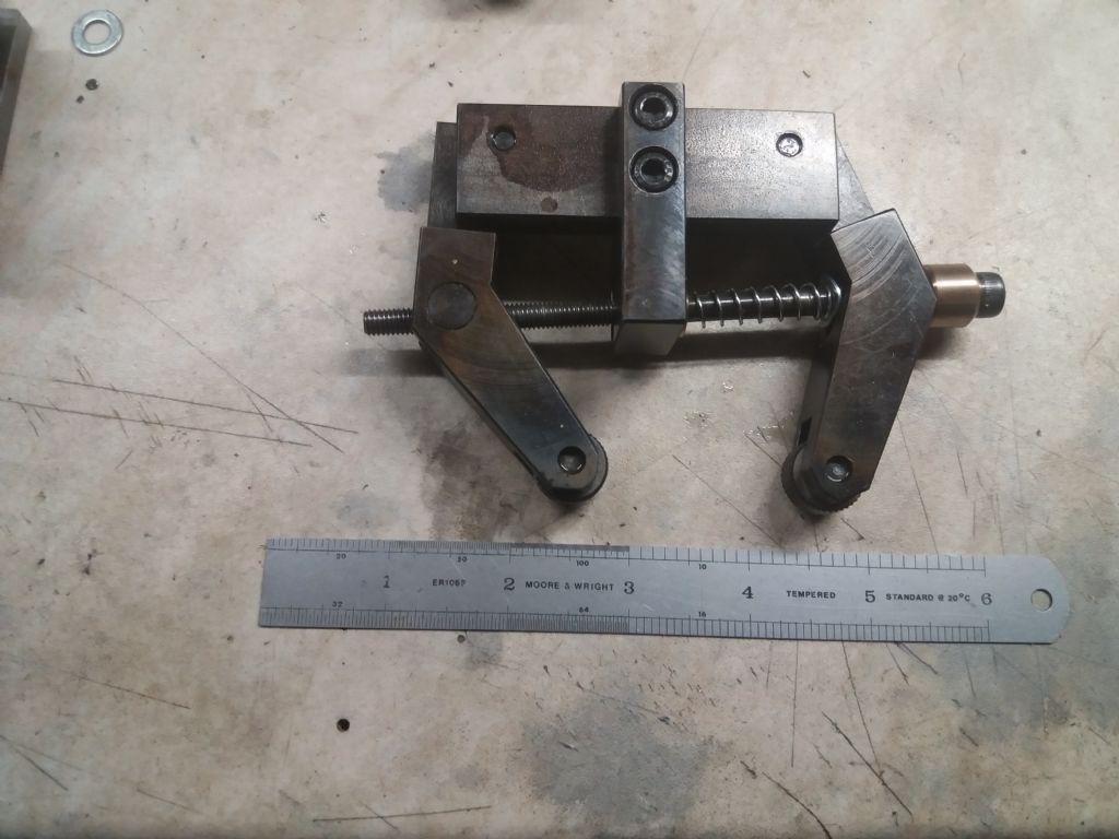

            David George 1
              @davidgeorge1
              This is my version.
              It will open up to about 2 inch and down to very small. I have drawn it up if you want a copy I can email it to you. I used a set of wheels from a push type tool and they are easily changed for all three types.
              David

                    The Hemingway kit is based on the Marlco knurler which is the best of the lot imo. They aren't cheap but worth looking at.

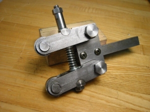

                              THIS is a link to a PDF of one I designed and made many years ago. I also designed and 3D printed a storage box for it and some additional knurls.
                              d/1HPVUl_xO_bRdRcHFAGKrxybH_YvmMAm3/view?usp=sharing >**LINK**

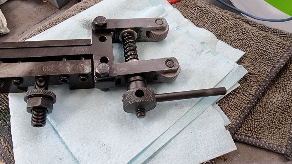

                                I've mentioned this before on the forum, in another thread, but I'll repeat it, anyway. I made a knurling tool to a Graham Meek design and it's very good indeed. That is to say the design is good, not necessarily my version. The design is detailed in Graham's book "Projects for your workshop, Vol.1"
                                It mounts directly in the QCTP and is easily adjustable from the front of the machine and can accommodate quite large diameters of material. I would second the advice to buy good quality knurls, too
                                As you can see, it works on the scissor principle, thus removing the thrust on the lathe bearings.

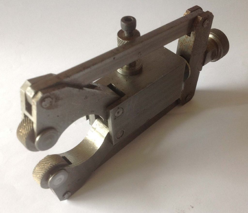

                                  Steve – I made one in 2014 and posted details here:
                                  **LINK**
                                  Rik

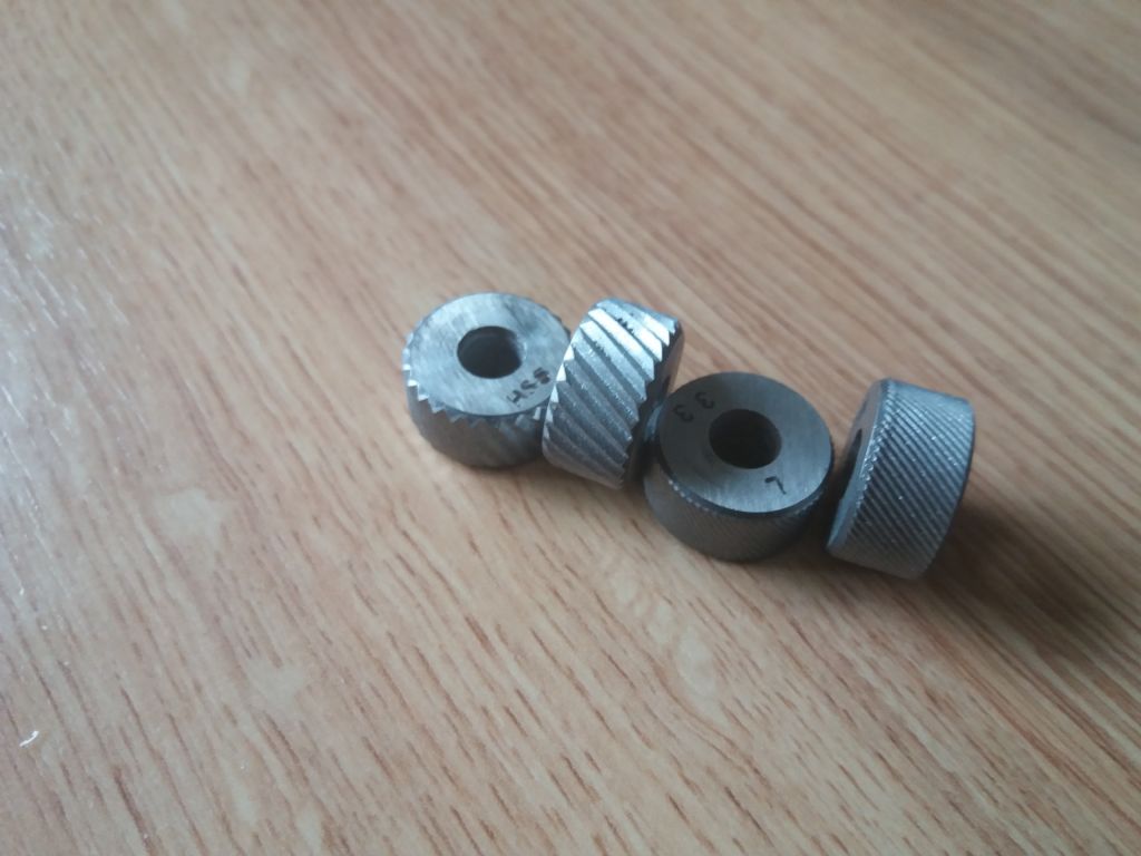

                                        Yes i did buy from RDG tools. I had a bit of fettling to do with it & it works just fine. The reason i want to make a better designed one is.
                                        The one i have is very hard to tension the jaws. The ratio is not great. Also the tensioner is very near the rotating work & bothers me a tad when tensioning because of the effort needed to turn it. The Meek design caught my eye with the tensioner at the back.
                                        I also thought it would be a nice little project to do. Thanks for all the comments & answers as always.
                                            I'm assuming you are trying to apply tension with the knurls on the stock? The way I use the scissor type tool is to set the tool so the wheels just drag the stock at the top and bottom then move the carriage off the work then apply some "cut", start the lathe and bring the wheels back onto the work (a good chamfer on the stock helps here). I have always had good success this way
