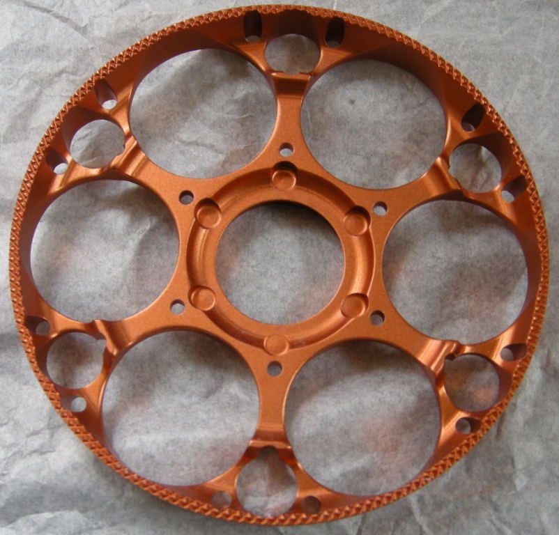

                                Hope this isnt condescending certainly not intended to be in 27 years i have never ever measured the diameter or circumference of any part to be properley knurled. Say proper because i have never ever seen a decent knurl short of a cut knurl and normal knurler with human knowledge.
                                A good knurl to me is not leaving flats but are pointed, look for that next time more apparent o course.
                                Bit more proof you dont need to measure before knurling, done 22 course this week like this and well over 1900 in total over the years. Typical speed is 85rpm with coolant, any faster job rings often misses a beat and scraps the job.
                                **LINK**
                                #403815
                                Jeff Dayman
                                  @jeffdayman43397
                                  That's a fine looking six barrel ion exchange transmogrifying thingamabob Jon. Great looking knurling on the face.

                                    That's interesting! Never thought of knurling the face of a job, only ever the circumference. Food for though there, if only for decoration.
