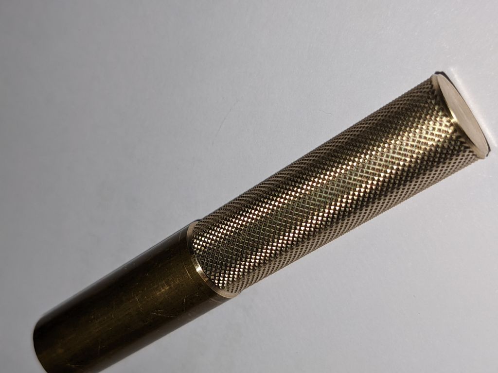

      I'm looking for some advice on knurling.
      I've done plenty of normal knurling on steel, brass and aluminium, but this project is a little different.
      I'm making a Fairbairn-Sykes style Commando Knife which requires knurling on a curved surface.
      I made a test piece from aluminium and tried it by placing the knurling tool on the work, then removing it, moving along and repeating as required. Whilst it sort of worked, I wasn't happy with the result as it was a bit of a mess.
      I've included a couple of pictures of the brass handle I wish to knurl. The two blue lines are the area I wish to knurl (the end line is where it will be parted off)
      Any help/suggestions would be very much appreciated.

          You could try individual tangential knurls separated by a grooving/parting/vee tool.
          Good luck.

            You used to be able to buy a hand held knurling tool that you gripped like a pair of pliers. it had three knurling wheels . Not sure if they are still available.
            this thread   HERE    has a picture about 8 or 9 posts down.  This one has a screw for closing the knurls but I've seen very similar ones where a good strong hand grip will work.  Obviously with the hand grip you can vary the distance between the knurls.

              Well there are two problems, you need to follow the contour of the work and the knurls also need to be square on to the profile as well, [ assuming standard knurls]
              Just an idea ! make a straight feed two wheel knurling tool that has the head articulated so it can follow the profile, thus the head and wheels swing left & right. As for the in feed to follow the contour then it's either by hand, eye & feel or make a profile follower similar to the ones where the taper turning attachment used.
              Possibly an overkill for a one off ? Whether it will work I know not but my first thoughts – lets see what the team come up with

                That would definitely make things easier.
                The originals were knurled in one and after studying pictures, some of them do look as if they were done in sections, some better than others! This was the 1940's, so CNC wasn't involved. I'm guessing how well they came out depended on the lathe operator. I can see why they changed from knurling to grooves in the latter production and current handles, as it must have simplified production tremendously.
                I wondered whether slowly moving the pressure on the work and edging it along with the carriage would work?
                Ruining it after getting this far would be a bit depressing to say the least!
                Ian.

                  Thanks for the advice. I was still replying to the first comment before I realised there were more!
                  This will most likely be a one off, maybe not, but certainly not something I'll be making batches of or repeating on a regular basis.
                  These are some original handles for an idea of what I'm trying to achieve. Obviously making the grooved version would be easier, but I do enjoy a challenge!

                    You might be able to do it freehand with enough leverage, maybe try a thin knurl on the end of a very long handle in a similar way to how metal spinning is done.

                          The 'proper' way might be to mount the knurling tool on a long-radius turning fixture or a copying attachment so as to follow the curve. In all probability you'd have to make the gadget plus a template, so you've got the decision to make as to whether the knurled finish is worth that, the grooves being so hugely easier and functionally similar.

                            Looks to me as though the original knurls have been done in bands as they don’t match up exactly so just set tool square to work and stab it in, wind it out,move along setting square to work again and repeat process. For what it’s worth I far prefer the bottom, grooved version.

                                  Thinking about my experience of using the hand held squeeze knurler device mentioned by Bizibilder it might be possible to keep sufficiently even pressure on the tool to create a good looking knurl by twisting the tool slightly so it runs from side to side. The technique works fine on a long(ish) parallel shaft.
                                  Can't see any reason why it shouldn't follow moderate slopes and curves. Obviously if the slope is too steep or the curve too great it's going to dig in. Given an adequately shallow curve or slope it obvious issue is keeping the right level of pressure on the tool as it runs up and down the the cuve. I imagine it will take several strokes to form the knurl squeezing harder with successive runs. For ordinary small knurling you just squeeze until the knurl looks deep enough.
                                  Here is a picture of the tool Bizibilder refers tor :-
                                  Certainly hasn't been made for years and rare then. Found mine maybe 40 years ago in the "going to throw away" box at an experienced machine tool and tooling dealer who didn't realise what it was and how effective it could be. Having used one I knew better and gladly handed over an extra £1 for it on top of the price of the big Pollard drill I went to buy.
                                  Minor correction to what Bizibilder said. The screw sets the squeeze depth not the clamping load. I'd think screw clamping could be dangerous if the tool gets away from you. Although the adjustments imply it can be set to handle work over 2 inches – 50 mm in diameter I find it starts getting cumbersome over an inch – 25 mm or so. But what it does do it does really well. Had to knurl some 6 mm pins to fill some no longer needed holes in a part being modified yesterday. Longest party of the job was finding some stock and mounting in the lathe. Squeeze and repeat 8 times gave me 8 pins 10 mm long ready to tap in.
                                  Links to drawings and build instructions for that and couple of similar ones in the thread linked to by Bizibilder.

                                    Daft question, but I'm assuming it pulls itself along the work?
                                    Even dafter question – does a normal tool post mounted two wheel knurl also pull itself along the work if the carriage is free?
                                    I'm 100% 'self taught' on lathe work and I've always knurled by running the chuck on the lowest RPM and the same with the feed rate (it's a Myford ML7-R)
                                    I ruined a lot of material before I was able to get a nice diamond pattern, but I'm now wondering if I've been doing it correctly and possibly making life hard for myself.

                                      Need to lean it a touch and push slightly sideways to make it move along. It's a feel thing really. Given the right mix of squeeze force with a modest push and gentle lean it walks sideways very controllably.
                                      If you hold it dead square when you squeeze it stays in place. Just the ticket for doing knurled head screws.
                                      Toolpost mount types you feed side to side using saddle feed. On lighter machines its probably better not to try and make a full knurl in one go.
