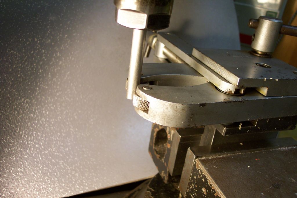

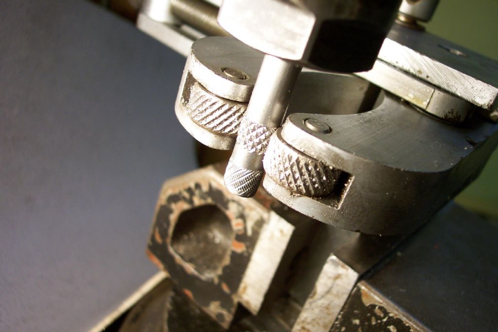

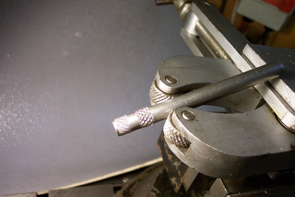

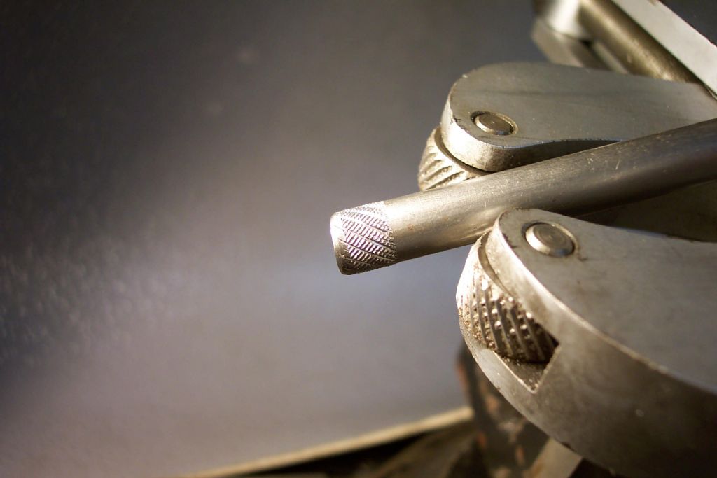

                                finished test piece.jpgsecond attempt.jpgfirst attempt.jpgTaking things a bit firther today I ran a test on a piece of 3/8 inch steel bar. The set up was on my Dore-Westbury mill, spindle speed 43 rpm using a Marlco knurling tool clamped in a big machine vice.
