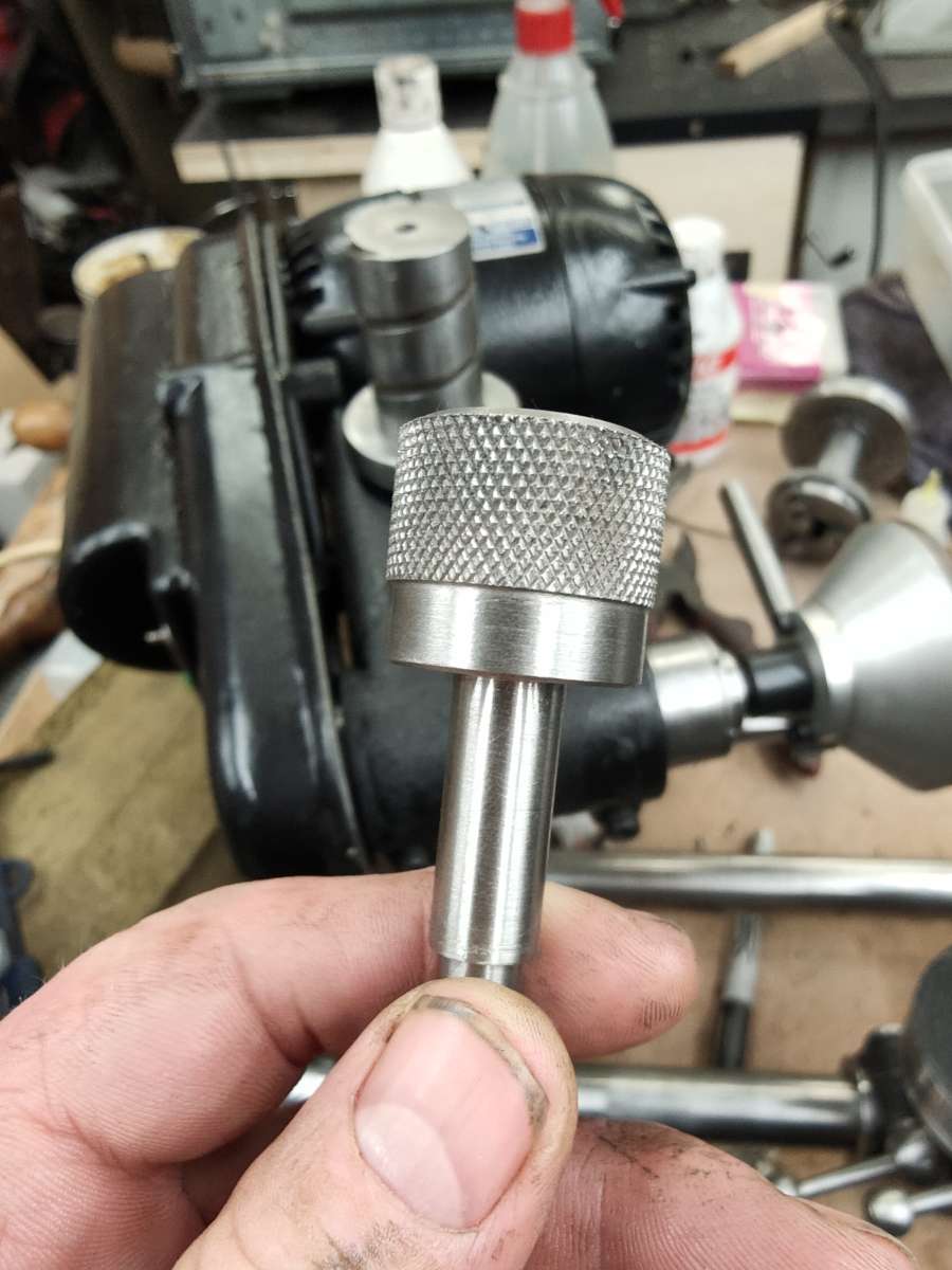

                            I really cranked on my RDG knurling tool on this stainless and it made a big difference! As good a knurl as I ever done. However, I don’t think the tool is really up to the job – it gets bent out of shape (as can be seen by the knurl at an angle). Need something much stiffer.

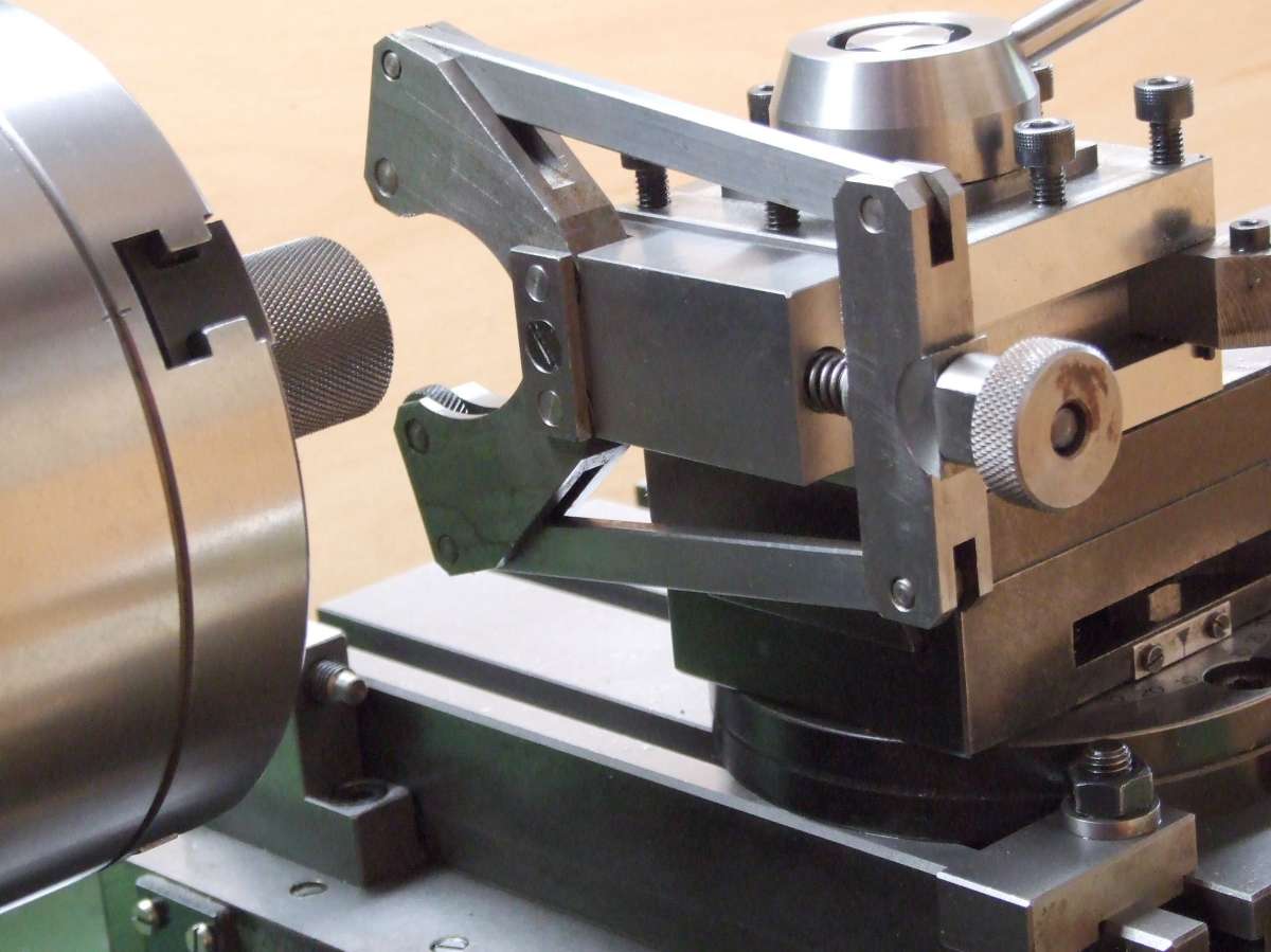

                              This is the classic scissors type problem. Thrust from the helical knurls sends each arm in different directions. There is usually far too much play at the pivot point.
                              Fig 3 Knurling set-up.
                              This is one of the reasons I designed the tool above. The pivot points are Hardened dowels and are as close to the work as possible. The other reason was to keep my hands away from the chuck while adjusting the knurls.
                              I am currently in the process of making a scaled down version for my Compact 5. The results of which I shall post on the Compact 5 thread I started some while back.
                              Regards
                              Gray,
                              #725782
                              Hopper
                                @hopper
                                The solution for the flexible cheap knurling tools is to a add a flat plate to either side to hold the two arms in line. It is easy enough to do, but you will probably have to make or buy longer bolts or pivot pins to extend out through the plates. See the hemingway kits tool for the general idea https://www.hemingwaykits.com/HK1110
