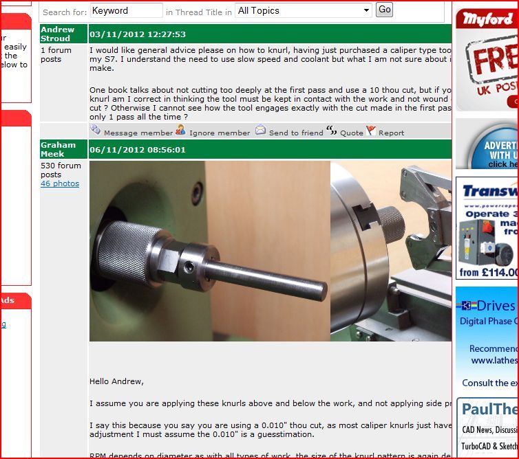

      I would like general advice please on how to knurl, having just purchased a caliper type tool with a diamond pattern for my S7. I understand the need to use slow speed and coolant but what I am not sure about is the number of passes to make.
      One book talks about not cutting too deeply at the first pass and use a 10 thou cut, but if you want to make a deeper knurl am I correct in thinking the tool must be kept in contact with the work and not wound clear before increasing the cut ? Otherwise I cannot see how the tool engages exactly with the cut made in the first pass. Is it advisable to knurl with only 1 pass all the time ?

          For what it's worth, I clamp about half the width of the knurls on the end of the stock, hard enough to make some impression, then start the lathe running and traverse the knurls along and back using the leadscrew handwheel, clamping up a bit more each time I get back to the half-engaged start point. After the first pass, I stop the lathe to see if the pattern looks right. As Gray says, sometimes the diameter of the stock is such that the knurls "double", producing a pattern twice as fine as I want. The only remedy for that seems to be to turm a few thou off the stock and try again.
          If the first pass looks OK, I continue to and fro, clamping the knurls a bit deeper each time until the depth looks right. It's as well not to go too deep; this can result in sharp points on the pattern, making the finished job uncomfortable to grip.
          Use plenty of lubrication. It does no harm to stop part-way though and brush off some of the debris. On my lathe at least, it seems best to angle the shank of the knurling tool 4 or 5 degrees towards the headstock, rather than having it exactly perpendicular to the work.
            Alternatively you can calculate the required starting diameter, so that the risk of 'doubling' is greatly reduced. The knurled pattern is effectively a very fine gear. Therefore, to fit the 'teeth' neatly around the circumference of the work the circumference needs to be an integral multiple of the tooth pitch on the knurl.
            As an example, I've just knurled the caps for some oilers on the connecting rods for my traction engines. The nominal OD of the cap was 11/16", ie, 0.6875". The knurl wheel I used was 1mm pitch. I reduced the starting OD to 0.677", which gives a circumference of 54.02mm. The knurled pattern appeared with no 'doubling' or other problems.

              One issue I have experienced with knurling is shifting of the toolpost. Knurling places much greater sideways pressure on the tool, and this can cause a shift unless you are prepared for it and make doubly sure everything is tight. I find a Gibraltar toolpopst is best.

                                  I have always had fair results knurling with a scissor type tool and all the good advice above is relevant. I must admit to never calculating knurl/work diameter and it always seems to come out ok in the end.

                                    I am applying pressure above and below the stock, my knurling tool does have a graduated adjusting screw so I can set the depth cut, but I think doing by feel and inspection is probably the best way. I will raid the scrap box and start practicing.

                                      For what it's worth I use the same method as Andyf, except I keep going until I get a nice point on the knurls!
                                      I have only had the cursed 'double knurl' when I have started with insufficient pressure – I think that if the knurl is deep enough then on the second time around they are more likely to pick up the pattern.
