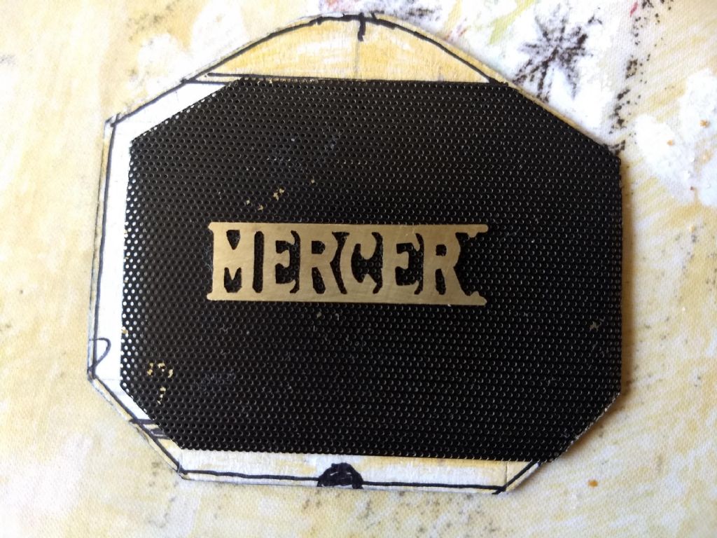

                                                    I have 3 piercing saw frames – an Eclipse, a very old one with no name, and an early KC. The old one has a deep throat and is used only when necessary. The Eclipse was my first and only one for a number of years, but has been relegated to the job of sawing off lengths of rod or tube in the chenier cutter because the KC is so much easier to use for intricate work. It's noticeably lighter, with a better balance, and the blade tensioning method makes it far easier to cope with the problem of removing and replacing the blade when sawing out lots of separate internal sections. See photo.
                                                    The conventional way of blade tensioning is to slightly bend the frame by bracing one end against the bench and pushing the other while clamping the blade. The problem arises when having to also support the workpiece at the same time in order to stop it rotating and breaking the blade; think of a 6/0 (0.18mm thick) blade in a 0.6mm hole. The screw tensioning of the KC is sooo much easier.
