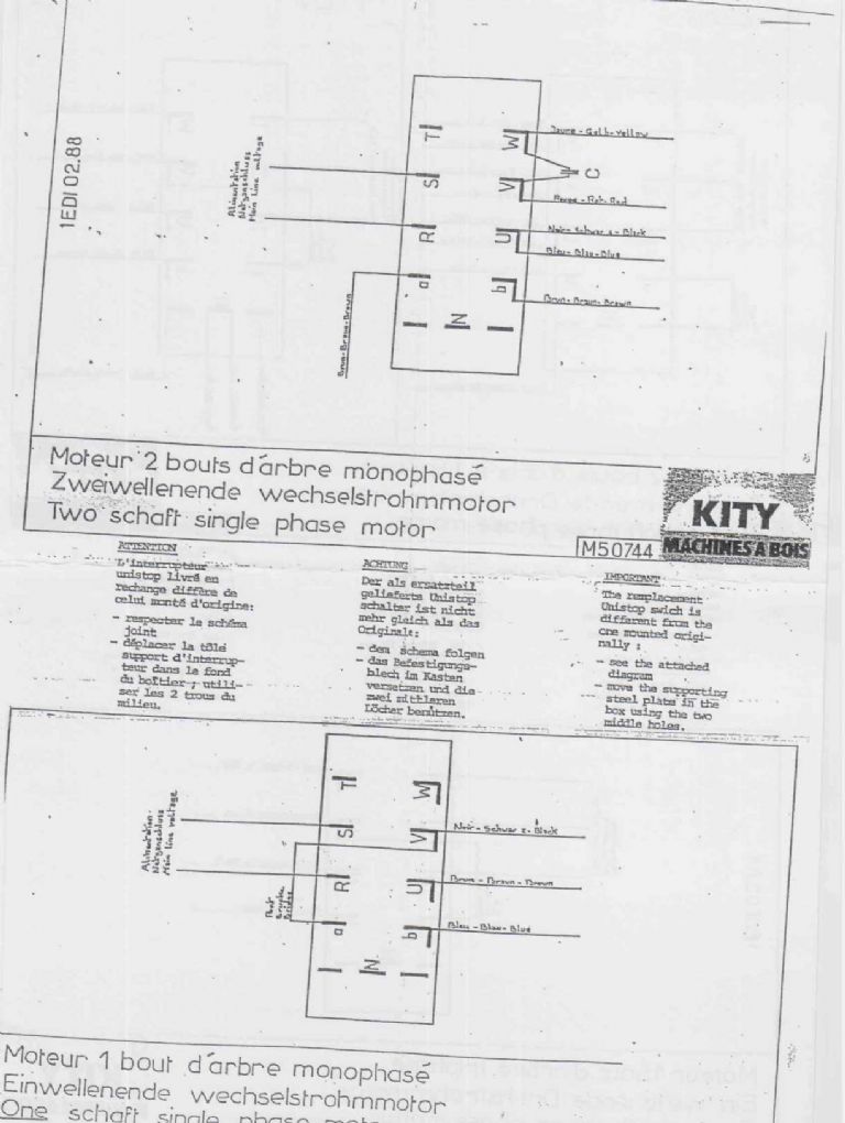

                e7371268-b52f-47d3-a845-684df2b85cfc.jpegI have found a new diagram for a newer type of unistop switch though I don’t think it helps much

                  What can I say guys.
                  Thank heaven for the internet and forums like this, it sure as hell beats trying to sort things out for yourself especially before it was around, all your help has been very much appreciated.
                  I take my hat off to Ian, I know one has to put their faith in someone and I was praying there would not be a big flash and something burnt out on the motor after making the connections he suggested, because at the end of the day it would have been my gamble.
                  He was spot on and all from my bit of a sketch and photo of the existing switch.
                  In my mind I thought, single phase motor that will be 3 wires live, neutral and earth, job done. Wrong!
                  Hopefully when I take it to him the mystery of the six wires will be solved, its better than watching Hercule Poirot.

                        noel shelley
                          @noelshelley55608
                          2 wires start windings, 2 wires run windings, 2 wires for the centrifugal switch. Then there may well be a capacitor across the start windings as well. Just a thought. Noel.
