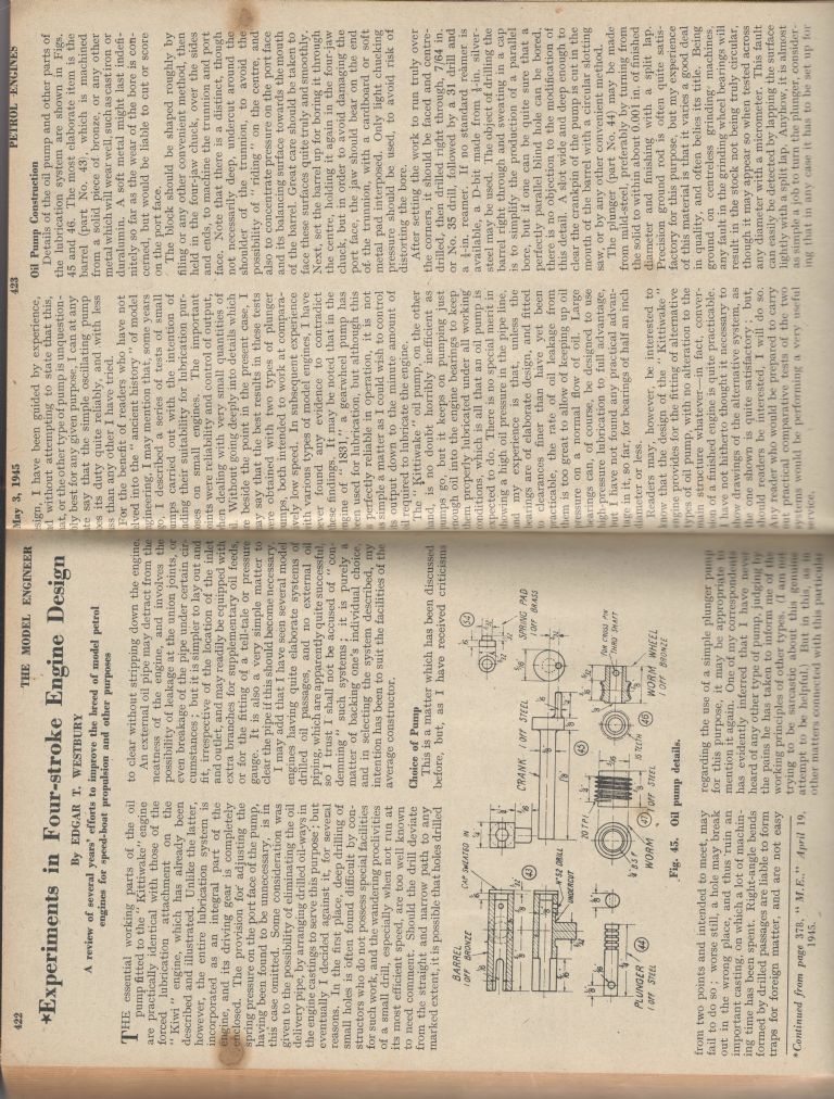

                      Les Jones 1
                        @lesjones1
                        Hi Neil,
                        I did not realise there would be so much interest in this engine. Seeing yor pictures of the parts layed out I now remember making the rocker shaft I think when I was in my late teens or early twenties.I dont think it is finished. My father did all the rest of the work on the engine before I was born or old enough to remember.
                        Les.

                          Oh well, pity about the articles.
                          Back to the engine though, it's a very interesting project and working to a genuine blueprint is seriously cool smile d
                          I think getting the surface finish back is going to be difficult since the aluminium oxide that has formed is going to be considerably harder than the base metal. I'd do all the required machining and think about the surface when the engine is running.
                          I acquired a set of Kestrel castings from Eric but I'm quite scared of starting on these since replacements are not available surprise
                          Good luck, when I'm back home from Yorkshire I'll have a look at the Kittihawk in vols 91/92
                          Rod

                                Posted by Les Jones 1 on 23/05/2016 22:02:51:
                                Hi Neil,
                                Hi Les, you'll be pleased to know the rocker shaft has come up really nicely and so has the crank.. I think the Evaporust is near the end of its life so things are going slowly, but the liner looks like honing might rescue it, but yes that 'big lump' will provide a new liner if required.
                                John, thanks for your patience, but it's a an awful lot to copy. For reference (not to make you get them!) the issues for Kittiwake appear to be:
                                2275, 2279, 2281, 2283, 2285, 2287, 2289, 2291, 2293, 2295, 2297, 2329
                                I think this is too much to expect you to copy them all, I think I have all key details in the book 'Model Petrol Engines'. I would be particularly interested in the issue 2295 article though, as the Oil Pump looks like it need a fair bit of care (and some more explanation of the valve arrangement) and it could be a good place to start.

                                          I think the drawing is probably the original for Kittyhawk – I doubt if it was retraced.
                                          The name change was probably to avoid confusion.
                                          I think I can scan it two leaves at a time, it has only torn along the horizontal split.
                                          #240029
                                            Thanks John, it's an interesting one that suggests ETW expected it to be up to long-term duty.
                                            I also note that the head has plenty of space for a full-size spark plug, my spare one for the Suffolk engine appears the right size and is a lot less tall than a typical car plug.
                                            Is there anything available that sits between a small standard plug and a 1/4" miniature one, I wonder?
                                            I popped the rocker box in evaporust for 40 minutes as an experiment, bearing in mind it isn't acid or alkaline (works by chelation) I fancied it might do something – in fact it worked very well, afterwards the crud rubbed off with a kitchen scratchy, i couldn't see any loss of metal.
                                            I've cleaned and oiled the crankshaft. The paper and the ends are a bit pitted, but all the inside parts look like they have just been machined. A golden colour suggests that it was brazed, not silver soldered.
