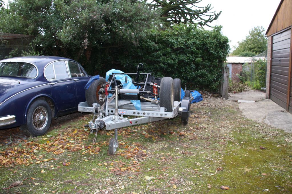

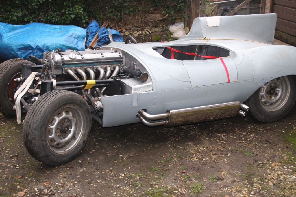

      Just a few notes s a new member to the forum. Amongst my model engineering interests I have an interest in historic racing and kit cars. We have a 50 year old Triumph Herald reincarnated using a Gazelle kit body on a special chassis. This was professionally built for the original owner and we have owned her for nearly thirty years. Very much a 'trip to pub, summer evenings' car.
      My first love car – wise has always been the Jaguar D Type and when I looked into the kit car recreations of these I embarked on a Realm / Ram kit which I bought part started.
      It is proving a long job as I was unhappy with the initial work and stripped it right back, modified a couple of details on the chassis and then had the chassis shot blasted, zinc sprayed and powder coated.
      Body has been put back on in the right position (before you couldn't get the Jag engine in!) and I have made a number of modifications along the way to improve the appearance and get closer to authentic (recognising that space frame chassis and GRP body will never fool those who know the car!
      The process has involved much research and learning, initially to understand the history of the D Type and significant features, then the XK range of cars and potential donor parts, followed by vehicle mechanicals and electrical wiring to deterge what can be 'period' and what gives an acceptable modern equivalent.
      The 'doing' stage equally involves much learning including the unravelling of often conflicting advice, research of IVA test requirements and developing a range of of practical skills.
      Throughout my aim has been to do as much of the work as I can myself, but having any safety related welding done professionally (chassis alterations, prop shaft shortening,TIG welding on handbrake, stainless exhaust manifold and silencer)
      Parts I have made myself so far include filler adapter to fit extra large fuel filler cap to fuel tank (assembly machined form aluminium scrap components and welded together – includes gauze filter), fabrication of more authentic stainless steel handbrake using MGB ratchet assembly and mounting in the correct position in the passenger well, new bonnet mountings and catches, anti roll bar links, brass radiator and fixings with electric fan, aluminium header tank, sheet aluminium trimming to engine bay with rubber splash seals, mock oil catch tank, cable tray, shortened XJ6 steering column (to retain collapsible section required for IVA) and associated mountings, aluminium trimming to cockpit floor and central tunnel, new dashboard – GRP moulded off hand moulded (draped) plastic pattern with 'leatherette' finish plastic sheet. Various adjustments to GRP bodyshell to correct fit, earlier assembly errors and to suit new arrangement of handbrake etc.
      Wiring loom has been remade with larger cables for heavy power items, wiring for alternator, two speed radiator fan etc and with provision for lighting now required for IVA (repeater indicators , fog lights etc) and sockets to enable removal of body from the chassis.
      I am now about to remove the body for hopefully the last time for final assembly of mechanicals and setting up suspension geometry and fitting of speedometer sensor. This will then leave final fitting of lighting and instruments. I have bought a digital driver for mechanical speedo which overcomes ratio issues to achieve the speedometer accuracy demanded by IVA.
      The car might be completed this year, but then again i have said that before ….several times!!

                            Will do Mike, I have some better photos somewhere but couldn't locate them on the spur of the moment.
                            I envy you to have followed the D Types at their birth. For me it is just one of the prettiest racing cars despite its weight.
                            My holy grail is Goodwood Revival – I go most years and a few years back there were 25 or 26 D Types in the paddock. I took a lot of photos that year. It must have been nearly every surviving D Type!
                            I really enjoy making even small parts for the car, others might not appreciate the detailed care that I put in to try and get design and materials right for period, if not exact. The beauty of the D Type is that even when new they were pretty much bespoke and used what parts Jaguar had available at the time. That and subsequent racing history means that no two cars are the same and there are quite noticeable differences on some. Mine will be a miss mash of early and late details (twin SU carbs as used on the early 3.4L engines but on a 3.8L unit which would have had Webber's by the time that size engine was fitted.)
                            If you look carefully at the radiator photo I posted, the tie bar to the top fixing is from the aircraft industry (not wrong on cars of that period using 'army surplus' resources and a nod towards the aircraft design used for the engine subframe on the original as developed for hanging aircraft engines to their fuselages). I fabricated the other tie bar to match as I only had the one in my 'odds box'. The side plate on the radiator it ties to is mild steel, pre tinned all over and soft soldiered on to the radiator cheek. The radiator itself is a mixture of brass and tinned steel profiles, the steel being used for the more structural bits.
                            The brackets for the drop links on the anti roll bar don't show on the photo but once fabricated I had them zinc plated, as also new m.s. tubular struts supporting the rear of the body shell from the differential cage. Those will be clear epoxy coated rather than black painted to avoid corrosion but help retain a bit of an illusion of being made of alloy.
                            For me the aim is to gain an impression of authenticity despite being a modern home build, hence my choice to use a genuine analogue speedometer clock albeit driven secretly from a digital source. I have yet to source an affordable screen printer to make a new speedo dial as it will be altered to have the 0 mph at '1.30' and the 180 mph at '10.30' on the clock face and have the stop pin repositioned. The analogue odometer and trip dials will retain the nice old red and orange paint from the MK2 Jaguar speedo.
                            Similarly I have blow out on a modern alternator fitted in a mock dynamo body to help retain some credibility under the bonnet, diagonal cable tray will also help by following the diagonal line of the engine/front suspension subframe on the original. This will be easier to see when i dig out the photo of that area.
