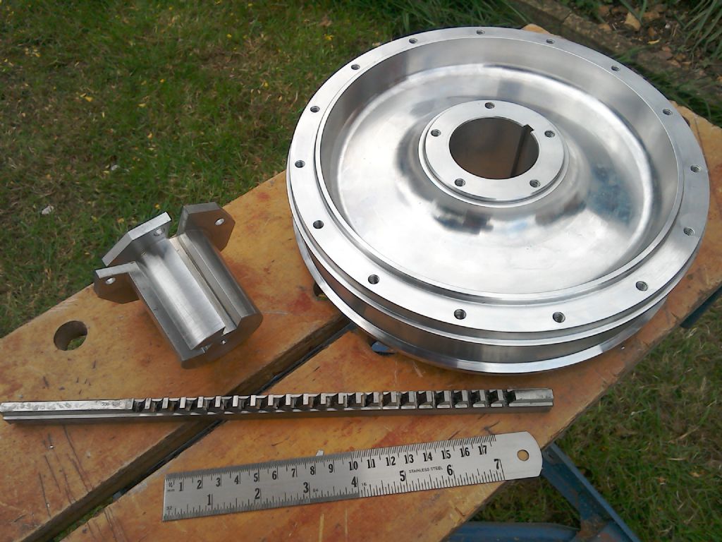

                    I do my broaching on a 3 ton arbor press. Before I had the arbor press I used the spindle of a 21" Royersford camelback drill press. Your frirnd's hydraulic press should work beautifully. Be sure to back off thr ram periodically to allow the broach to re-seat itself in the but. That will prevent the broach leaning outward and resulting in a tapered keyway.

                      Crude but effective.
                      I made a bush with 3 different depths to guide the broach. With the broach in position a piece of copper was placed on top and tapped with a hammer to drive it through. Material was aluminium alloy. The workbench helped avoid excess shock to the set up.

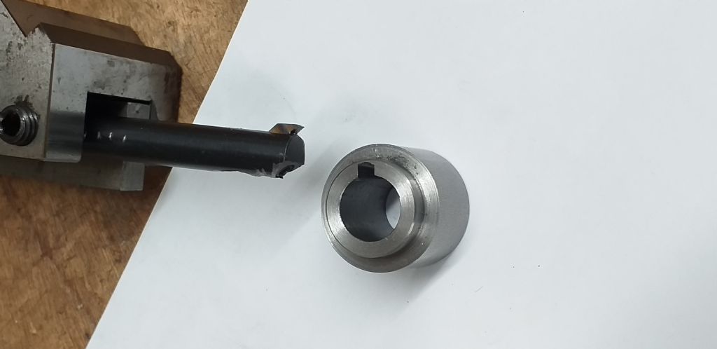

                        I did this the other day on using the saddle on the lathe. I drilled a small hole first to remove most of the waste but you might not need to do this. Regards rich20191103_172219.jpg

                          Posted by Richard brown 1 on 05/01/2020 15:23:52:
                          I did this the other day on using the saddle on the lathe. I drilled a small hole first to remove most of the waste but you might not need to do this. Regards rich ….
                          OK for a large sturdy lathe, but frowned upon with a small hobby lathe.
                          The carriage is usually driven by an outboard pinion, supported by a possibly flimsy apron. An expensive occupation if excessive wear or breakage occurs.
                          Slower, but safer, might be to use the tailstock but still loading the spindle bearings – shapers (and slotters) are designed for this type of machine operation.
