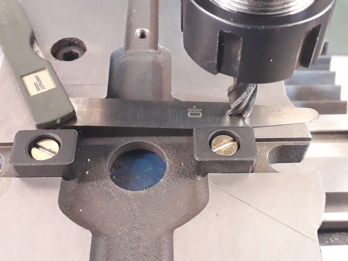

      ArcEuro have a pretty amazing deal on Versatile Vices right now. So I ventured to replace the well-marked vice that had come with my used Sieg SX2.7.
      The new vice came with keys, to position it in the table slots. These are 12mm and I need to mill the protruding part to c.11mm to match the slots on the top of the table.
      Before I reinvent another wheel, does anyone have a recommended procedure to achieve this?
      I had thought: fit them into the vice with a shim below; invert the vice with a parallel in the jaws located in a table slot and clamped down; and face off one protruding face of the keys, or maybe both?
      Cheers, Colin

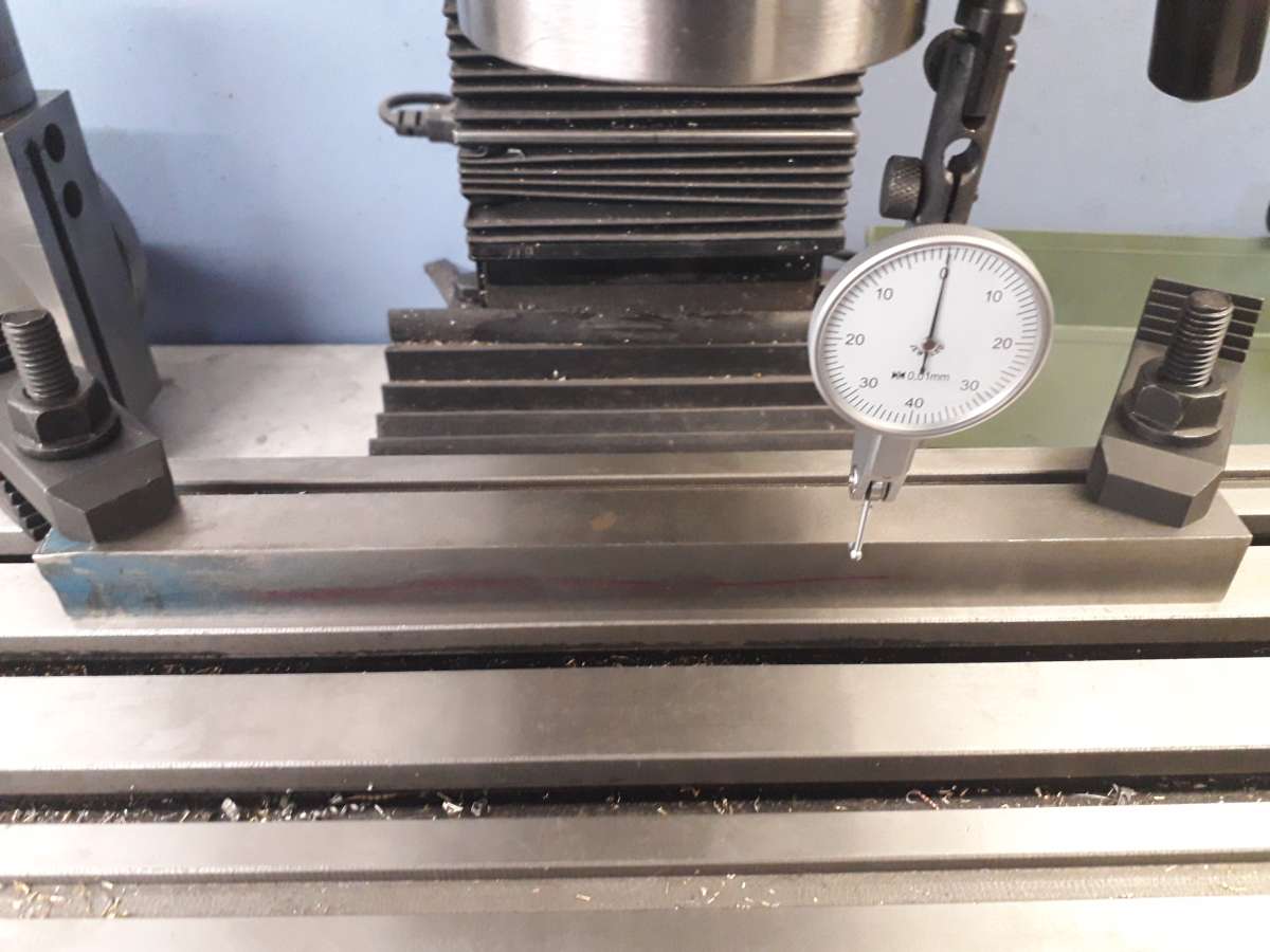

      #729011
      Tony Pratt 1
        @tonypratt1
        Colin,
        Sounds good to me but make sure you ‘indicate’ the parallel with a DTI to make sure it is truly in line with the table movement.
        Tony
        #729016
          Having first confirmed that the slots ran true I clamped a bar to the table, clocked that and then clamped the vice to the bar. Washer below key to raise it up a bit for milling.
          Vice clock (4)
          Vice clock (7)
                Jason, did you face one side of the keys, or both?
                Jason, did you face one side of the keys, or both? And I suppose, having zeroed that bar, there is a bit of mental juggling to ensure the keys are then the right way around when the vice is flipped back onto its bottom?
                Cheers, Colin
                #729144
                  I took a bit off either side, this keeps the slots for the hold down bolts central with the tee slot. Keys fitted in the position they were machined.
                  Good for 0.008mm or 3/10ths in old money. there is enough clearance between slots and keys that would allow that to be clocked out if anyone felt the need. Also some of those 8 microns is likely down to movement of the table on the X-axis ways.

                      The keys are as hard as the top of Gods’ head so it’s carbide or start over with softer material.
                      I put keys on my splendid new Xin dividing head and foot stock. Dismal failure, way out of alignment with each other 😀
                      Robin
                      #729193
                        HSS cut the Arc ones in my image above.
