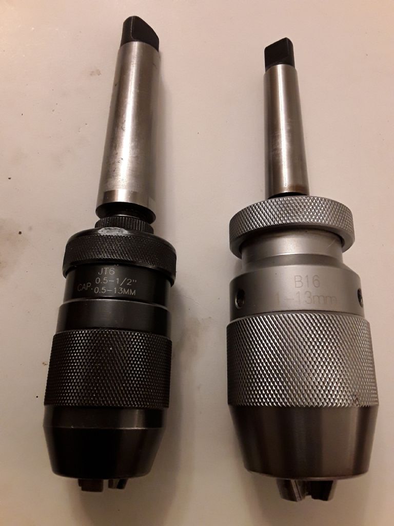

                                  I bought these keyless chucks from the Model Engineering exhibitions, probably around 15 years ago.
                                  The black one on the left is a Vertex, with a very smooth operation and the unloaded jaws are precisely located with no play at all, although that is not particularly important. But the upper knurled collar is a steel pressing, and a bit of a dent is visible on the top edge from when I dropped it. I bought two of these, one for the lathe and the other for my mill.
                                  The larger bodied chuck on the right is one from RDG, this also has a nice smooth action but has a nice thick solid steel knurled collar at the top and no brand name. Like a lot of RDG tooling at the ME shows this was on display piled in a heap in trays along with other taper tooling, so may at first appear to be possibly a bit cheap and nasty, but it is very good quality and has worked faultlessly and is used mostly in my Elliot drill press.
                                  Although the RDG chuck has a much larger body than the Vertex item, they both have a maximum capacity of 13mm. Both these chucks can lose their grip if run in reverse, for instance when tapping.
                                  Edited By Lathejack on 12/03/2023 21:18:31
