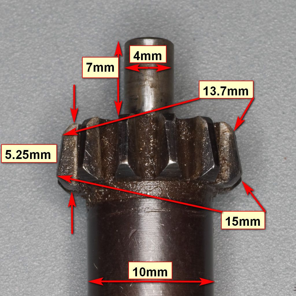

          No, but I did photograph mine for someone a while ago;
          Here's a link to the album https://www.model-engineer.co.uk/albums/member_album.asp?a=40346
          and one of the four photos.
          In one of the others, you should be able to count the number of teeth.
          Bill

              Looking at the wear/machining marks on the pic by peak4 might give one the impression that the gear is just a plain spur gear that has been tapered? It did, to me.

                  Not done it yet – it does look like that. Maybe an option to modify a bog standard gear?

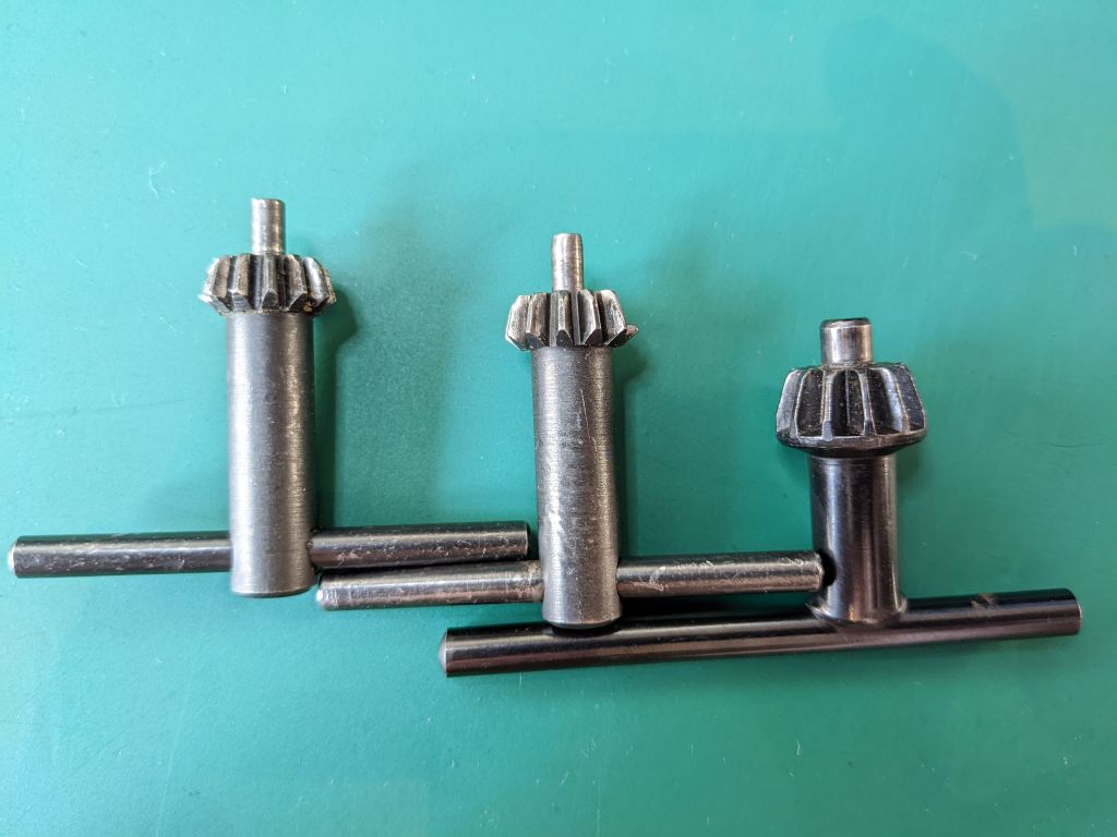

                            Though I would post this because it might be of interest to some of you.
                            The keys on the left and middle are genuine Cowells keys and the one on the right is a generic drill chuck key for a 1/2" chuck.
                            It's hard to see in the picture but interestingly the one on the left is slightly smaller in diameter and has shallower teeth than the middle one. Both fit and work fine but the larger key feels a little bit better which is great because the larger key is more similar to the bog standard drill chuck key.

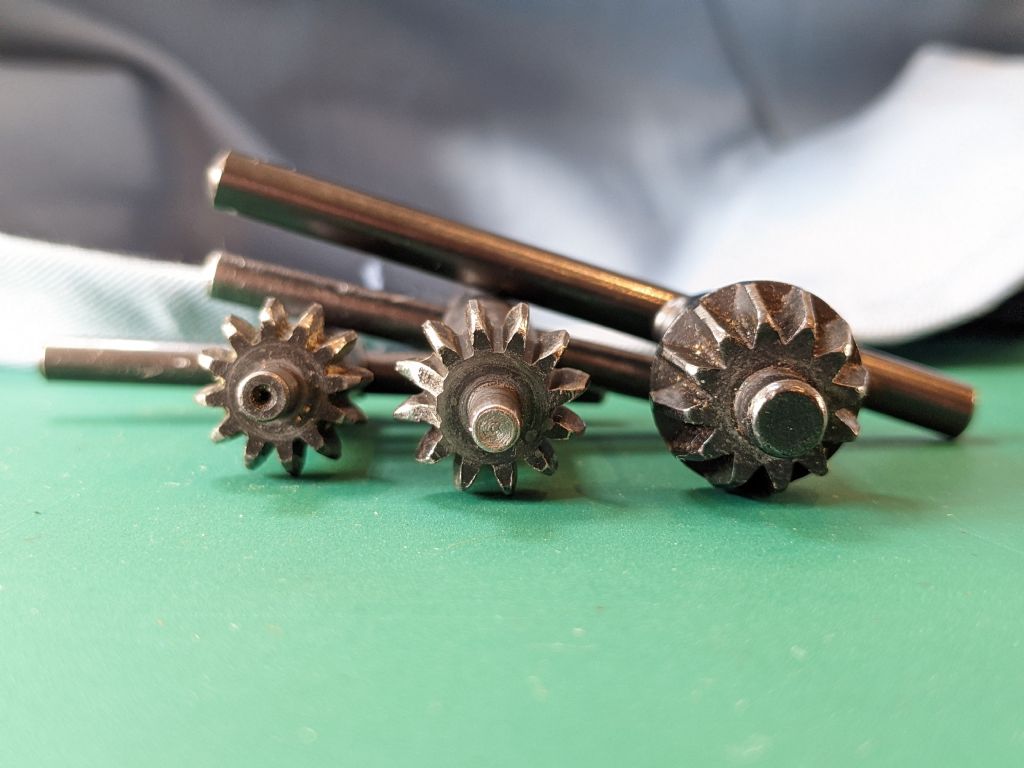

                                  Hollow point, I notice in your pics that you say that the left and centre keys are cowells but they are different shapes, the one in the centre looks like Jacobs pattern. If the one on the left is correct it can’t be that difficult to copy especially as you need 3 and several other people as well. The body of key with the teeth could be separate to the spigot which could be fitted with loctite later. Just a suggestion.

                                  Hollowpoint
                                    @hollowpoint
                                    Bernard – heres another picture.
                                    Im going to try modifying a drill chuck key. I'm just waiting on the post. I'm not using the one in the picture I need it! 😅
