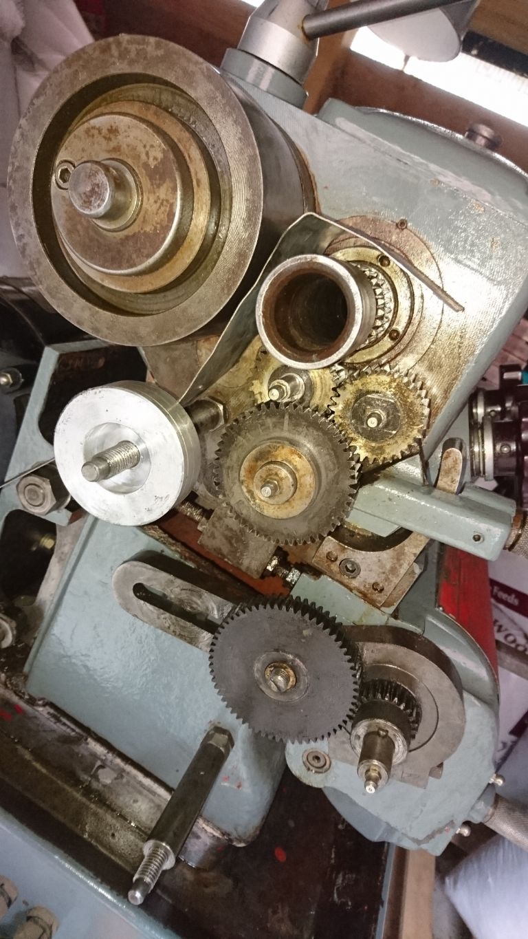

                        Hi Michael, thanks for the link. I have looked at their pictures, as the lathe shown has the 60t imperial gear, which I lack. Unfortunately, as you say, much of the detail is hidden. I have taken mine (partially) apart and have seen no pins, so far. This is what mine look like.
                        Kerry AG Mk.3 Gears127t & 32t Change Gears
                        #535105
                          I think we can now safely assume that the aforementioned ‘pins’ are Howard’s ‘Studs’.
                          … and there does look to be some considerable clearance on the one in your final photo.
                          We had one of those Kerry’s in the lab workshop when I was at BAe … and I always admired it.
                          The angled hand-wheel on the tailstock is a particular delight.

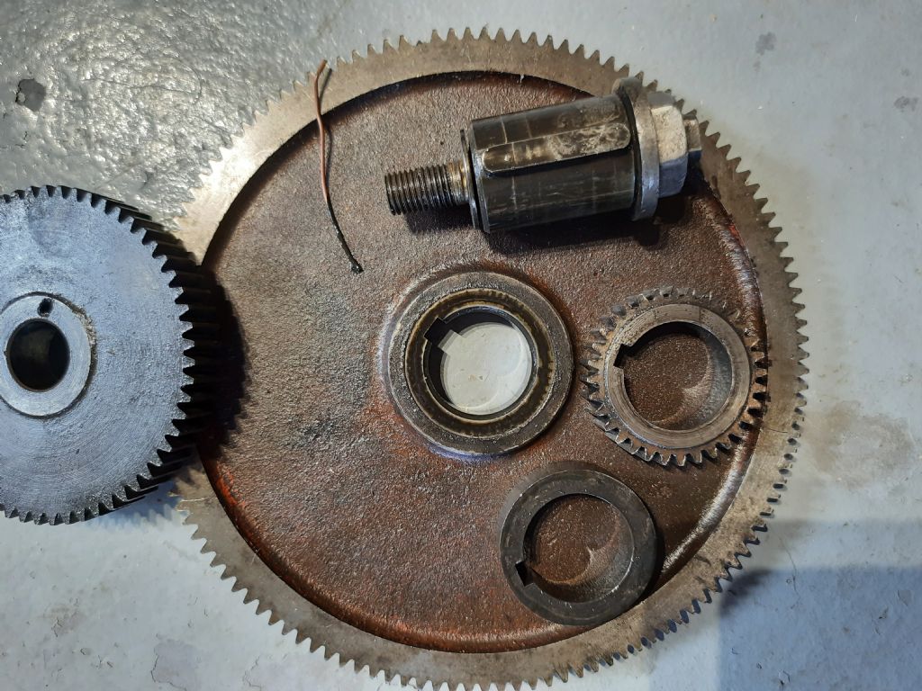

                            Is that a key way visible at the 11 o'clock position in the picture of the large and small gear?
                            Separating the two gears may answer the question. You will then know the size of any keyway, and the key or pin to fit.
                            It is possible that that the drive from Mandrel to Drive gear, and from Gear to Leadscrew could be via one or more pins set into the shaft, at right angles to the axis, i e radial?
                            If gears in the train are compounded, they would need to be on a sleeve with pins, which was able to rotate on the stud(s ). This implies that the sleeve would need to be reasonably thick to carry the pins to run on a stud with a smaller diameter than the bore of the gear.
                            If the gear is being used purely as a simple Idler, the need to key does not arise, but a spacer will be required to maintain alignment of the gear teeth, possibly with another spacer on the Leadscrew, for the same reason.
                            With a machine sophisticated enough to have a Norton box, I would have expected to find keys rather than pins to drive or compound the changewheels, since the shear load would be spread over a greater length. .

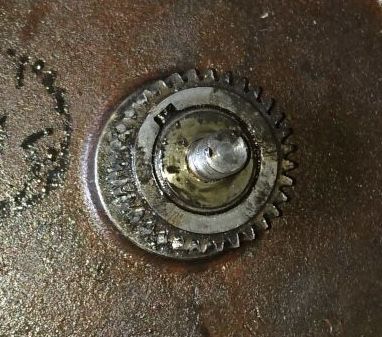

                              Michael: It's good to hear you had a favourable opinion of the Kerry. I have little experience of other lathes, my previous one was a tiny "Super Adept", which I inherited. The build quality of the Kerry seems amazing to me. I feel like the proud owner of a high quality vintage car! There doesn't seem to be any play in gears in the photo and I wonder if the apparent gap is due to a bevel edge.
                              Howard: Yes, that's a 1/4" keyway. I have taken some more photos and uploaded them to the same album. I don't know if they are sufficient to confirm or alter your hypothesis regarding the gears. There is a spacer used in the gears previously shown, as is more obvious in the photo below.20210321_123141.jpg

                                So, if you buy the two or three gears that you need, you may well have to widen or cut the key ways.
                                Ideally the new gears will be without a key way.
                                Hope that what follows is not teaching granny to suck eggs.
                                Having bored the gear hub to the correct diameter for your lathe:
                                Turn up a sacrificial bung, which is a snug fit in the bore of the gear.
                                On the boundary between the gear and the bung, centre pop, centre drill, and open up to 1/4" (or if cautious, to 6 mm ) diameter.
                                Remove the bung – it can be reused for the other gears, by drilling in another position.
                                The new gear now has a semi circular slot 1/4" wide and 1/8" deep, through the bore.
                                File away the surplus material to change from round to rectangular. (The keyway needs to be only half the depth of the key ) The key can be used as a gauge for the width, and then with one of the studs, for the depth in the gear.
                                Repeat for the other gears, and you should be ready for cutting whatever thread of which the lathe is capable.

                                    Looking at the album, it looks as if the gears are compounded by the 1/4" keys, which also fit into a keyway on the bush. The oil nipples on the ends of the studs will then provide lubrication for the bush where it rides on the stud.
                                    The bushes with keyways, to carry the gears obviously mean that the bore of the gears has to be larger than if the gear merely rode direct on the stud.
                                    To one side of one picture is the lever and detents for the tumbler reverse, but the tumbler gears are not immediately visible.. There should be two equal sized gears, meshed together, and carried on the inner end of that lever, to enable the direction of rotation of the Leadscrew to be reversed, Probably with a centre position where neither tumbler gear is in mesh with the gear on the Mandrel.

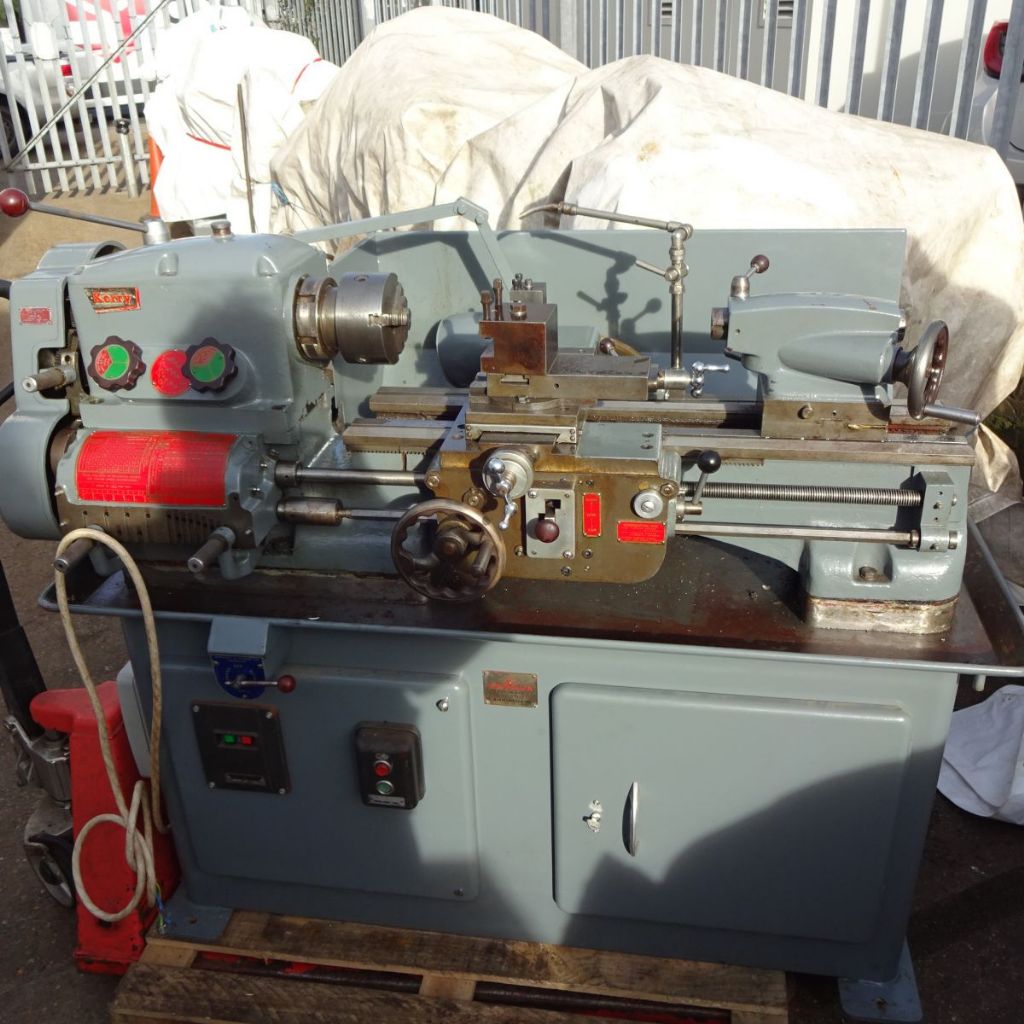

                                                I've uploaded some photos from the original ad, which described the lathe as having "noisy screw cutting but probably an easy fix!". They are all in a new public album.dsc05971.jpg

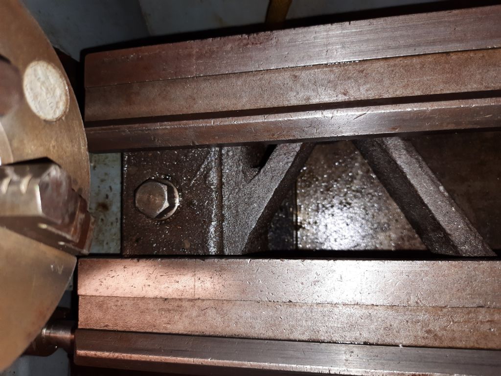

                                                  Thinking about what Dave said about whether the lathe is in "reasonable condition" I have uploaded a few photos of the ways to my "Kerry AG" album, in case that might be any sort of guide to the lathe's past history. There are many, mostly small, marks but I don't know what is typical for a lathe of this age. So perhaps these marks indicate training or educational use by inexperienced users, or are they signs of heavy industrial use?
