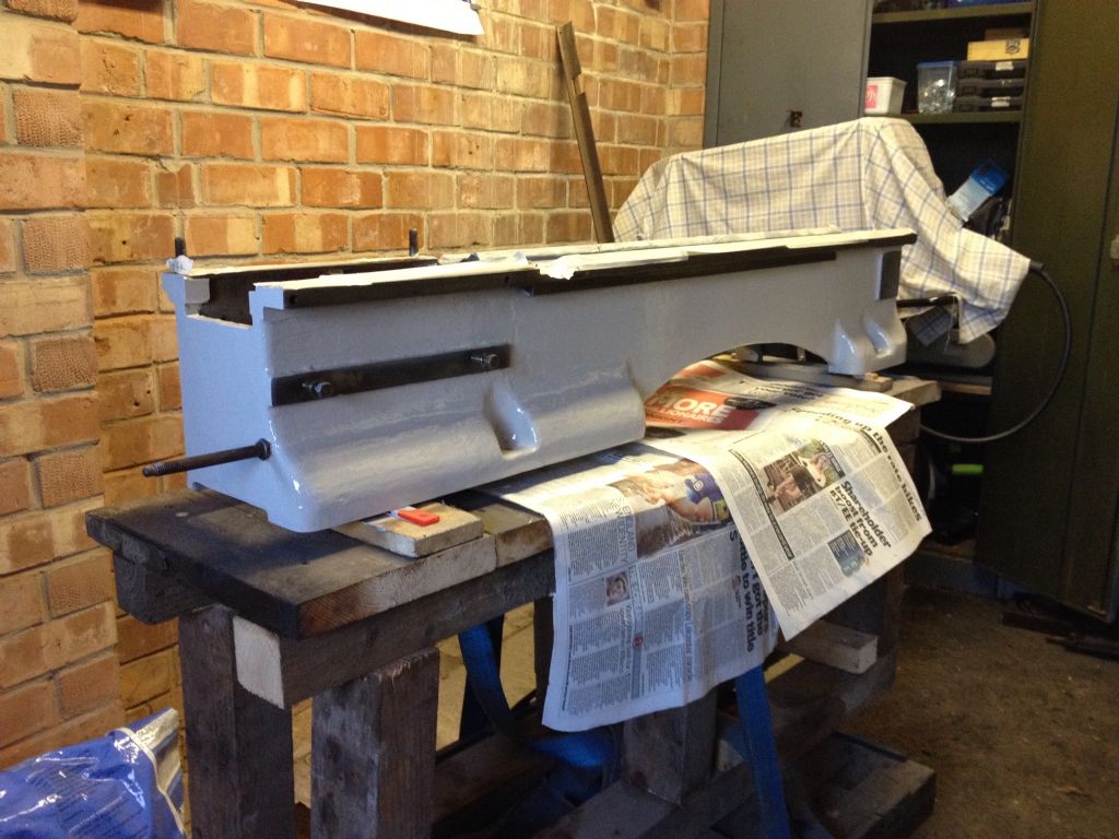

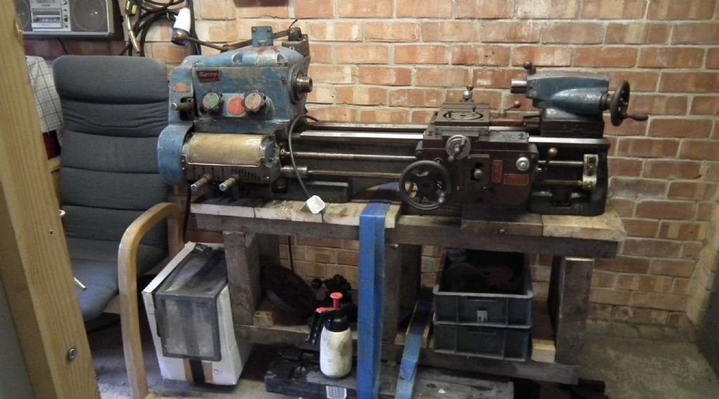

      Ive also fitted a DRO & transwave phase converter as seen on photos
      I would like to fit a collet chuck & appreciate any advise on what collet chuck would fit my machine as I have no luck in finding a factory fit model
      I didn’t want to machine a backplate & fit a Chinese chuck if possible
      any advice would be appreciated
      I have included pictures of machine before & after

          That looks nice! The first question is, what is the nose fitting? And do you want to 5C type collets of (probably) ER40 (given the size of the lathe)?

              the spindle nose is 2” 4TPI
              I was thinking of er 32 as I have the collets
              but I do like the 5c system but I am flexible
