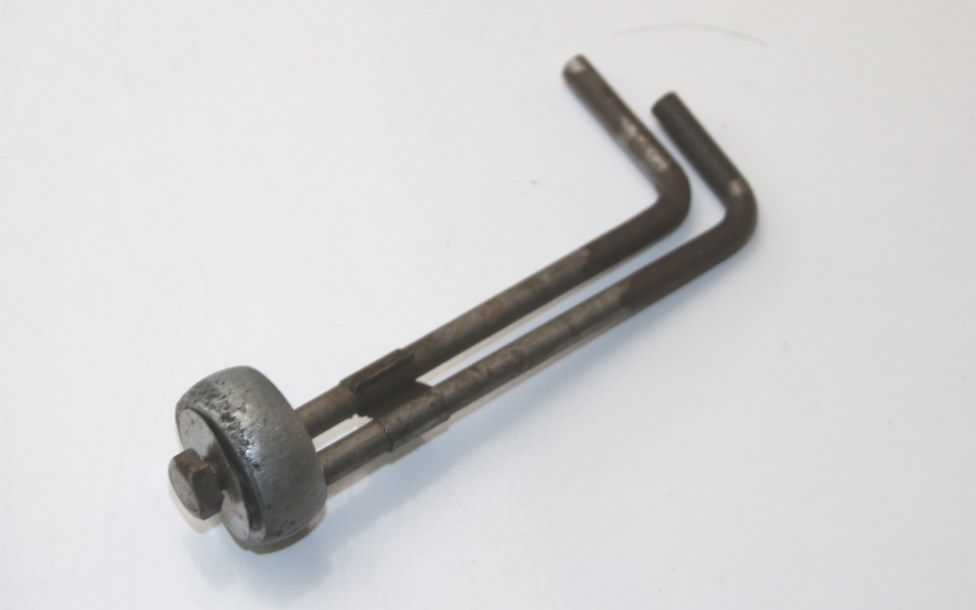

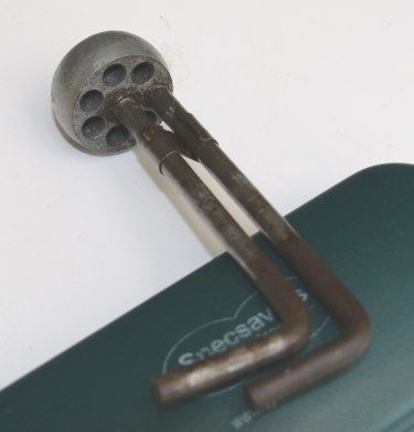

      I have a Kennedy 60?(small one) Power hacksaw that is missing the oil damper parts, the two rods, disc and the valve plate.
      Could any supply some pictures and dimensions of the missing parts ie length of rods, size of disc, number and size of holes in disc?

          If you have a look in the recent thread "Donkey (Mechanical Hacksaw to everyone else)" you will see a link to some pics of the Kennedy dashpot in my albums, and some discussion of it.
          The Album is at **LINK**
          If you need more precise details, send me a pm with your email address.

            Plunger is .258" dia. x .511" thick. The underside of plunger has a circular piece .006" shim held in place by a bolt / stud. The two "L" shaped rods are made from .250" dia. rod. The short one sticks out from the top of the plunger by 3.625" and the longer by 4.3125". The "L" shaped short bent bits are 1.625" and 1.250".

              I can see what is missing.

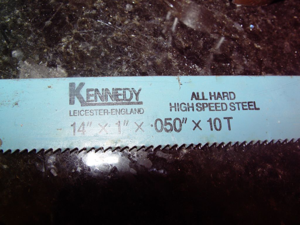

                                            Couldn't get my 90 to cut straight either with a normal hacksaw blade, however it does with a stiffer cut down full size industrial 1" blade. I guessed the rear clamp was slipping and being pushed from the front bowed the blade with the extra power and let it wander.

                                                  My saw came with a bimetallic blade that wandered all over the place, but it cuts straight and true with all-hard HSS blades. The spacing of the clamp bolts is a bit of an issue when it comes to deeper blades, I have used 1/2" and 5/8" blades in mine but it looks like 3/4" blades would fit as well. (The 1/2" blades needed the hole drilling out as the pin is larger on the Kennedy saw than on a hand frame).
                                                  Confusingly, Cromwell list power hacksaw blades under hand tools HSS All Hard Power Saw Blades but If you buy from them, check the price on both the Cromwell and Zoro websites, as sometimes one is much cheaper than the other,

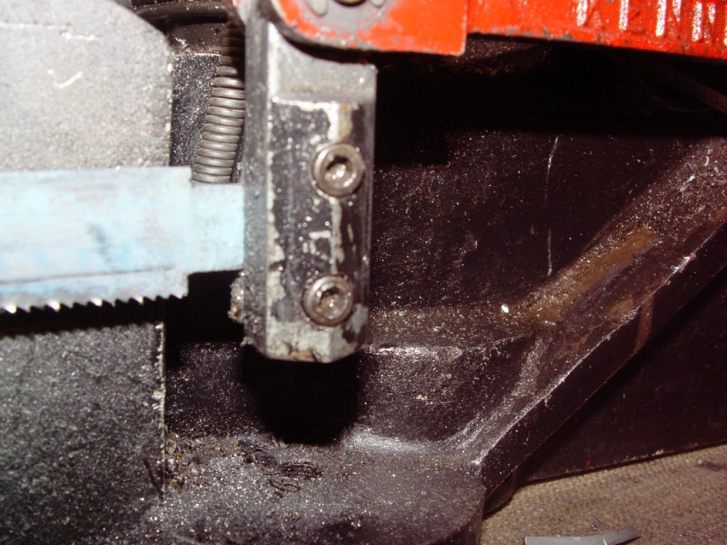

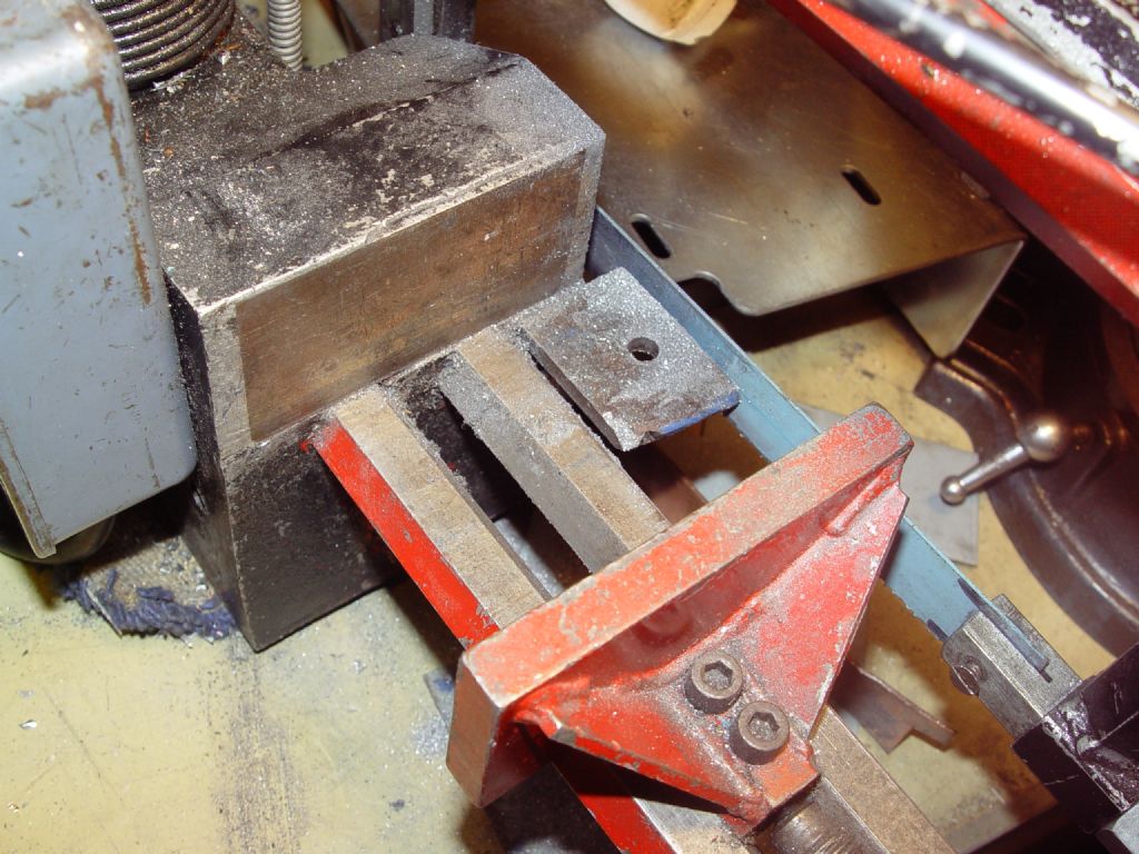

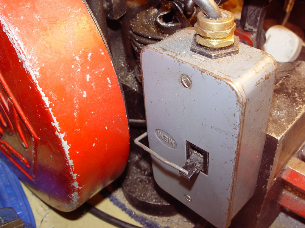

                                                    dsc02678.jpgdsc02677.jpgdsc02676.jpgThought I'd dump some photos of mine on here.
                                                    I confess I bought the saw with two blades. You can see you need to grind down the blade to fit it in the clamp.
                                                    The auto off lever is a wire coat hanger that goes in a convenient hole in the bottom of the arm rest.
                                                    i got sick of short bits not staying level before you can get the vice tightened so I used some scrap angle iron to support the work closer to the blade. What I should have done was use a longer bit and let the saw cut it's own clearance gap so the cut off piece is also supported.
