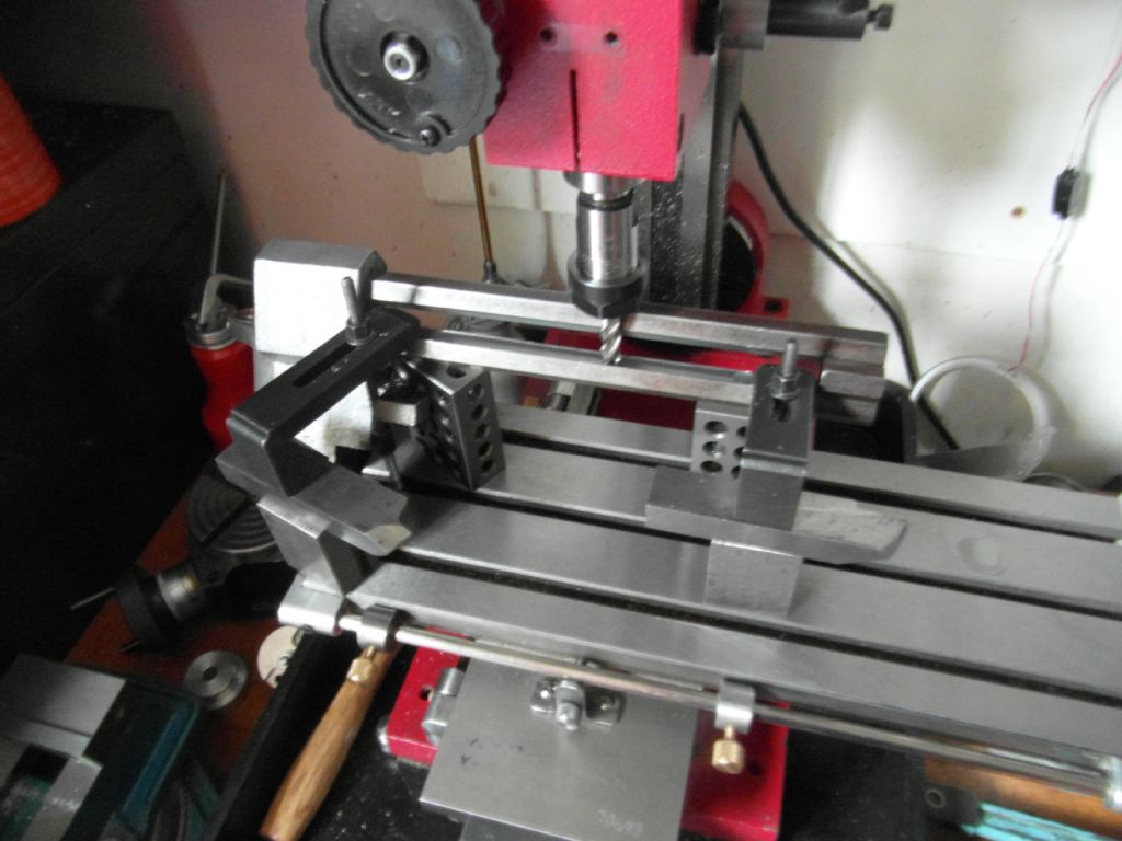

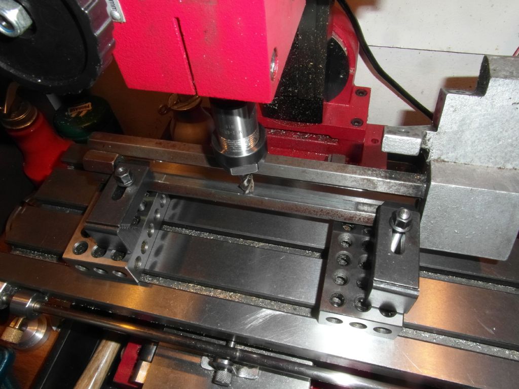

                  I removed the worn areas on the guide bars with this rather precarious-looking setup:

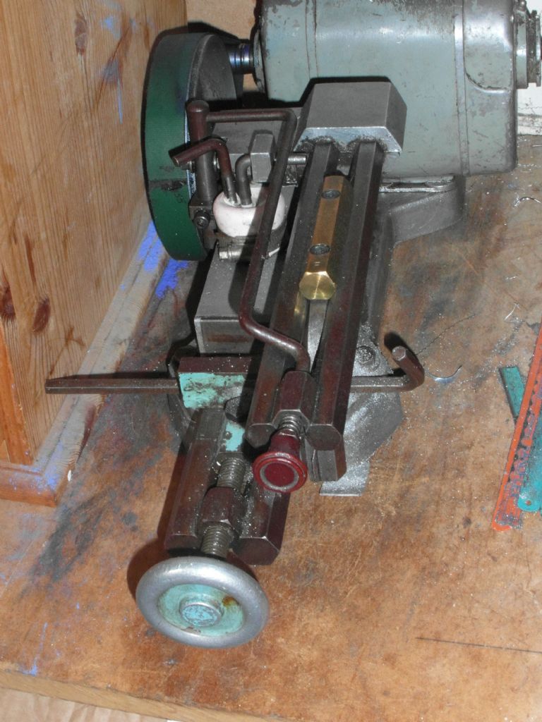

                                                  Here is my saw powering through a one inch bar
                                                  My Kennedy
