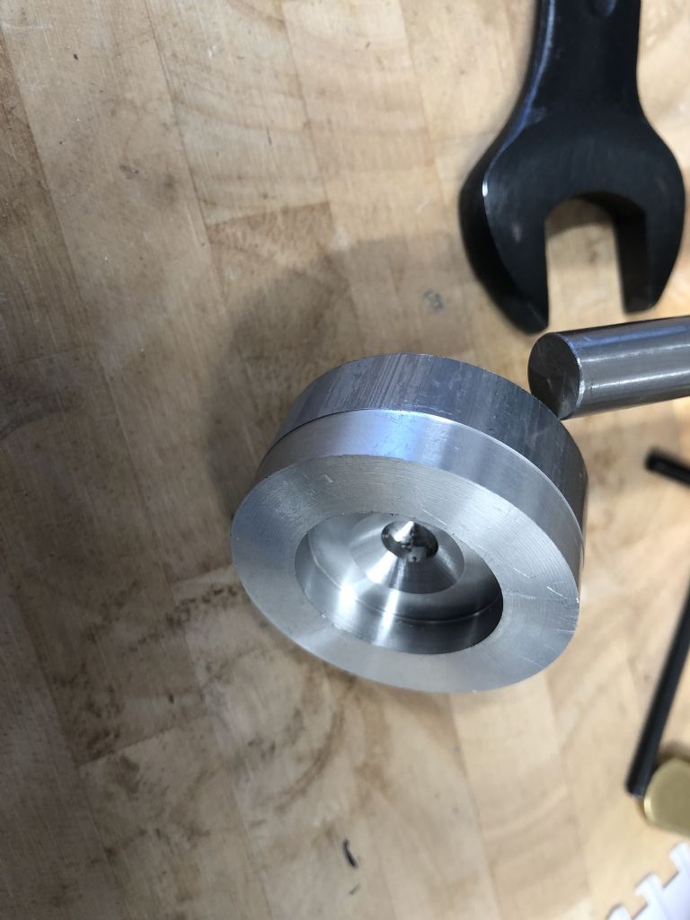

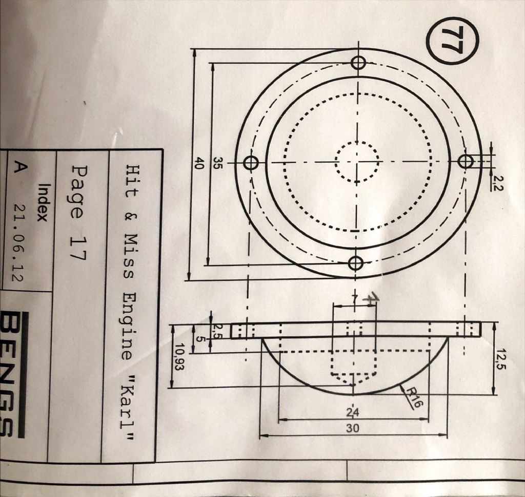

      I have to machine the dome on one half of the aluminium stock – the kit does not give you a lot to play with. Having machined the recess on one side I now need to machine the dome and create the flange 2.5 mm thick. My plan is to machine a piece of brass to fit the 7mm and 24mm diameter and loctite in place. I have already created the offsets and steps to create the dome profile prior to finishing with a file. Q. Will this work and what grade loctite given that I need to take overall dome dimension down to 30 before starting the dome procedure.

          I'd just hold it by the OD with soft jaws if you have them if not there is still enough thickness to hold provided you don't get greedy with the cuts
          638 would do if you want to stick it

            Thanks Jason – I don’t have soft jaws and therefore would be holding with a bit of protective packing in the jaws on about 2mm to give 0.5mm clearance for machining. The flange and dome – I was worried this wouldn’t be sufficient to take the gentle cuts necessary.
