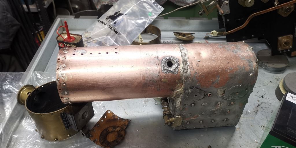

      I though this picture may elicit some Sunday afternoon activity particularly as we have another thread on the go about pressure vessels.
      It's being discussed elsewhere but I seem to be the only one who has said don't waste any more time on it, from a traction engine of unknown design about 3 1/2" dia the large hole did have a pressure gauge "attached"

        Ady1
          @ady1
          A very handy hole to braze on a kettle spout and whistle
          Teas up chaps!

            I think it may be more use as a strainercrying

              I saw the appropriate thread on another forum. It was tempting to say scrap the whole thing, as it looked to be freelance and poorly designed and constructed. But I thought it better keep quiet; but having seen the boiler above it reinforces my view. There are very few things worse than taking over someone elses uncompleted project.

                Should be alright up to about 5psig…

                  Looks like soft soldered, weigh it in

                    Nearly as much solder as copper….
                    A sad sight when you think of the price of the materials (never cheap even relatively to era) and worse the effort someone has put into it all so innocently, apparently without having sought help or advice.
