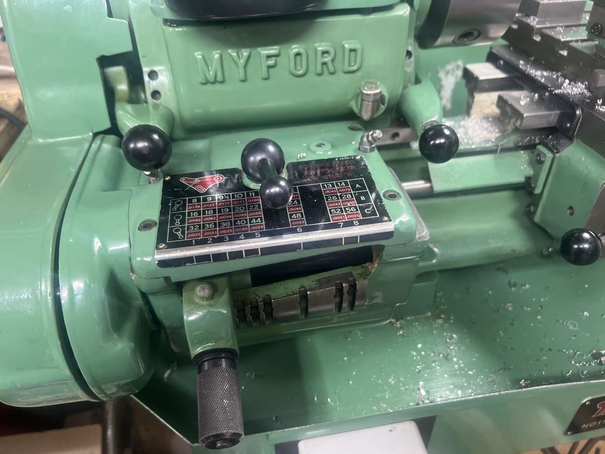

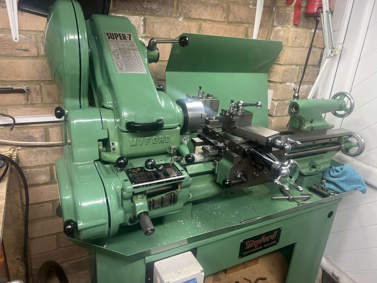

      Hi all finally got my new to me Myford super 7 home and installed and levelled up, please forgive some stupid questions but really interested in machining but never used a lathe before but will hopefully learn a lot and become confident using it
      my only concern at the moment is it’s an imperial lathe and have been brought up metric and would like to convert it, how difficult will it be, I understand I need to convert the dials to metric but the gearbox I want a metric conversion and when I look I see 2 types Norton metric gearbox and normal metric conversion can someone enlighten me if I have a Norton type gearbox or not, the gearbox serial number is QC148391 sorry for the stupid questions but on a steep learning curve here
      some pics below what do you guys thinkimageimageimage

        I think the g/box conv is a metric conv set behind the lefthand cover and an overlay on the chart. for the rest of the lathe its feedscrew and dial changes. not sure about the tailstock. why not go DRO?

          you will need to convert the dials AND the leadscrew/feedscrews AND the feednuts for a proper conversion. Plus conversion pre-gear set for the gearbox and presumably a new overlay chart unless you are able to memorise all the combinations.
          Simply not worth the cost. All you need to do is remember the magic number 25.4 and learn to think imperial. That way you will find the true path to enlightenment.

            Looks a nice piece of kit.  Dont mess about changing dials, look at the kit DRO for that lathe from M-DRO.You can then change from Imperial to Metric at he touch of a buttom.

              The gearbox in the middle of your middle photo is the Norton gearbox. It just means the generic type. The leadscrew – the long one at the front – is 1/8″ pitch, and metric pitch ones are not available so there is no metric gearbox . A metric conversion kit for the Myford gearbox involves different gears to be put inside the changewheel guard on the left hand end of the machine. This alters the gear ratio between the lathe spindle and input shaft of the gearbox to ‘fool’ it into cutting metric pitches.

                As others have said, don’t bother changing dials, just spend the money on a DRO kit. You’ll never look at the dials again.

                  +2 for the DRO. I have just fitted one to my S7.
                  The addition of 33 and 34 tooth change gears will allow you to cut most of the usual metric fastening pitches using the Norton box.  You will find that there has been much discussion of this fix on the forum in past times.

                    As Charles says, there isn’t a true metric z axis leadscrew made for the S7.  You can change the dials and screws and nuts on the crosslide and topside, but still have to live with an imperial leadscrew.  I see you have a PXF which makes the screw and nut even more expensive.  If you want a fully metric lathe the best approach would be to fit DROs as Keith  suggests.  And perhaps an electronic leadscrew to solve threading.  I have a Super 7 which is CNC converted.  If youri machine has a single phase motor I strongly recommend fitting 3 phase and a vfd, it transformed my machine especially on the high speed range.

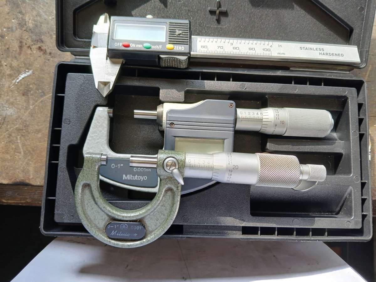

                              On the subject of micrometers, mine are all non-digital Imperial. My Verniers, DROs etc are all digital and switchable between metric and Imperial.
                              I mostly make one or two Stuart/PM Research models per year.
                              I think it is time to upgrade my mics (0-1″ max) to digital, not least because digital is much easier and quicker to read.
                              Any thoughts on a supplier with reasonable prices? eg RDG do a couple of 25mm ones…  https://www.rdgtools.co.uk/acatalog/Digital-Micrometers-.html  from about £70 – £100.
                              Or are 2nd hand digital ones off eBay, say, a more ‘cost effective’ solution? I suspect, because of the internal electronics, those might not prove as problem free as mechanical ones though.

                                Ches, I thought the same a few years ago and got digital Mitutoyo mic and cheaper depth one but just don’t like the feel so they sit in a draw unused. Though I find I don’t use a mic very much just digi callipers do for my model making needs with the traditional mic only getting used maybe once or twice per engine.

                                  On a part that is less than 13mm dia why would you use a digital cal when a 0 to 1/2 or 0 to 12 mic fits in the space easier or even 0 to 25.

                                    Firstly, apologies to Graham for slightly hijacking his thread, but ‘measuring’ is a big part of modelling/maching.
                                    Yes, the digital mics do look a bit unwieldy, certainly compared to the mechanical ones which I can operate with one hand.
                                    I haven’t got in to the habit of using a Vernier as a universal measuring tool … I still find the 1″ mechanical mic just easier to handle. But maybe a bit of brain-reprogramming is required.

                                      Bernard. That is another disadvantage of the digi Mics over vernier, they are bigger
                                      Not found getting a 150mm digi calliper in to measure diameters on the lathe a problem be ther 13mm or 130mm maybe I have more room on the 280 than a Myford and there is no rear toolpost to get in the way on my machine. Even the 300mm callipers  are easy enough to use when the work is over 150mm dia
                                      Yes that is why the mic sometime gets used particularly on the mill as it saves having to move the table away to the side to get access for measuring. I do have a small Digi calliper but not seen small digi mics so would have to do the conversion on a calculator and then use the mic

                                        Useful comparison pic.
                                        That short digital Vernier is something that never crossed my mind…hmm.
