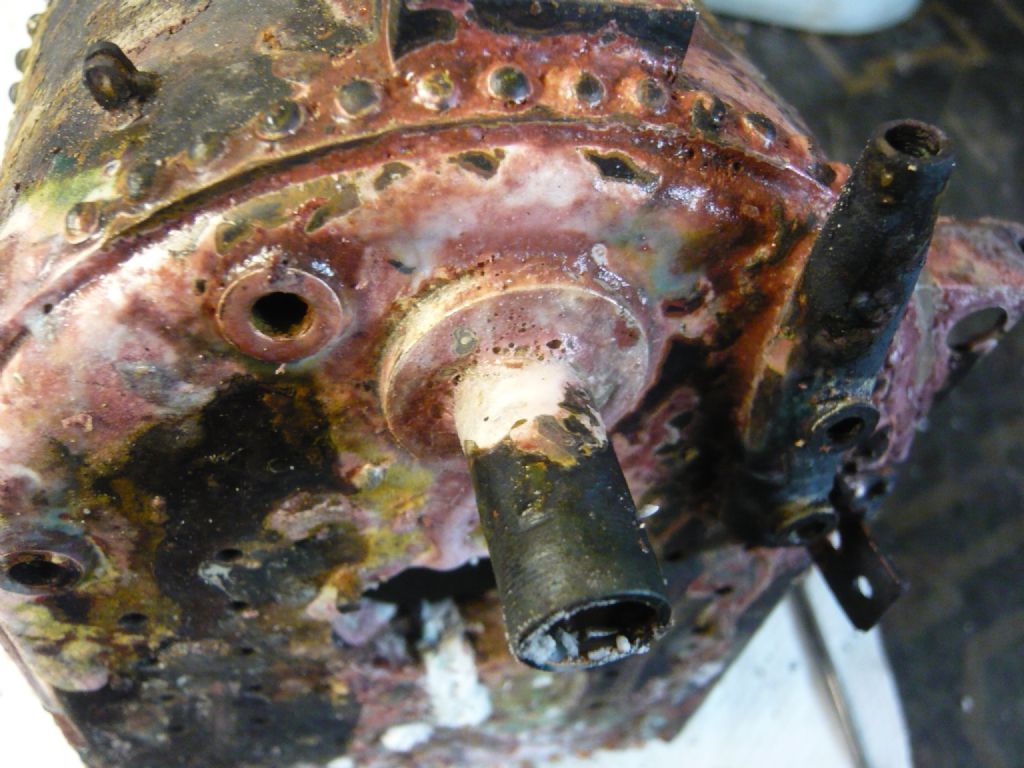

      I can't believe I've done this but… I've just silver soldered the steam collector pipe into my boiler shell, without drilling some holes or putting in some hacksaw slots to let the steam in!!!!
      I'm working out how to save the day but (almost) any suggestions welcome.

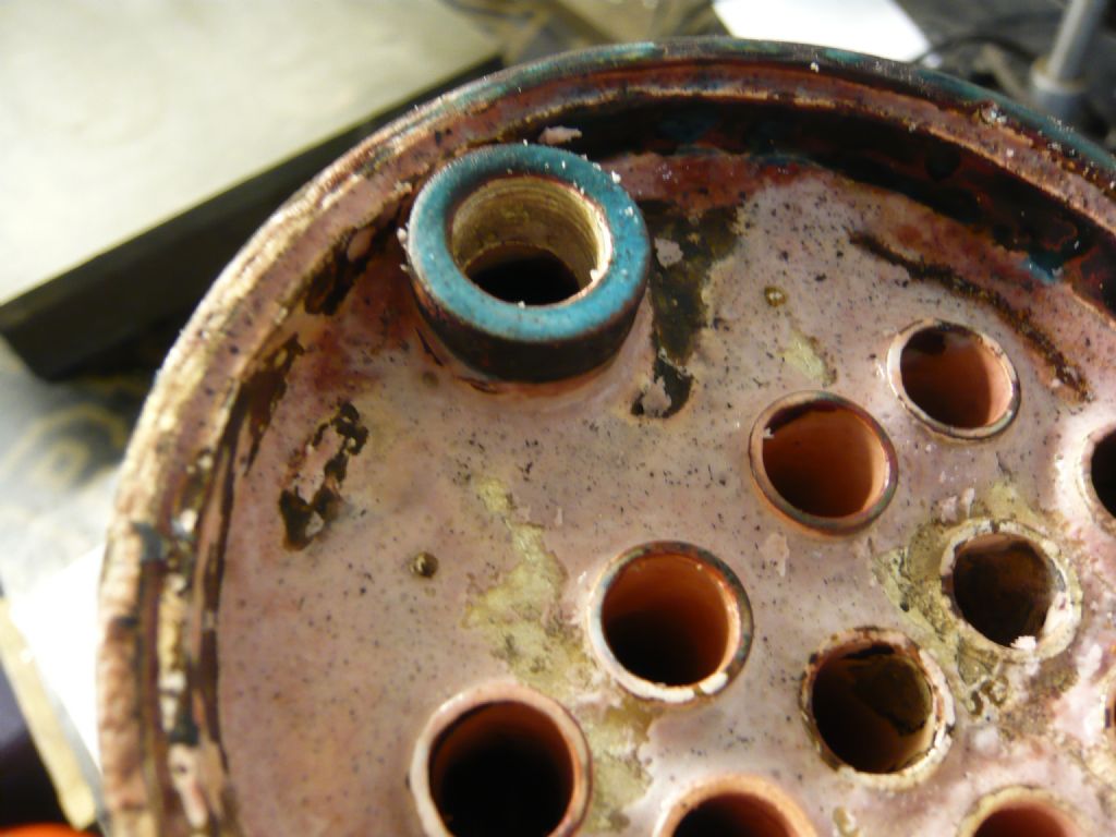

                  The tubeplate has one end of the offending tube in it, joined to a boss tapped 3/8 BSP. A 1/2" hand reamer just entered and went in as far as the start of the tube. I then used a worn, but newly sharpened on the end only,1/2" end mill, used in a tap wrench, and cut away the tube so that I can see a gap all round it.
                  I shall then do as Jason suggested and heat up the other end of the tube ( which I had fortunately left oversize) and pull out the tube. Thats the theory anyway. I'll let you know how I got on and hopefully get the pictures on.

                      Thanks for that Bazyle, I'd already thought of something similar but my vertical mill isn't big enough.
                      Here are pictures of both ends of the offending pipe.
                      Steam Collector at BackheadSteam Collector at Tubeplate
                      As described earlier, I've cut the pipe out at the front tubeplate. I'll heat up the pipe at the backhead and pull it out. It will then need just a new bush and maybe a new pipe (with holes in it!).

                            Had a devil of a job pulling the tube out. Finally did it and discovered a silver solder lump on the outside of the tube.

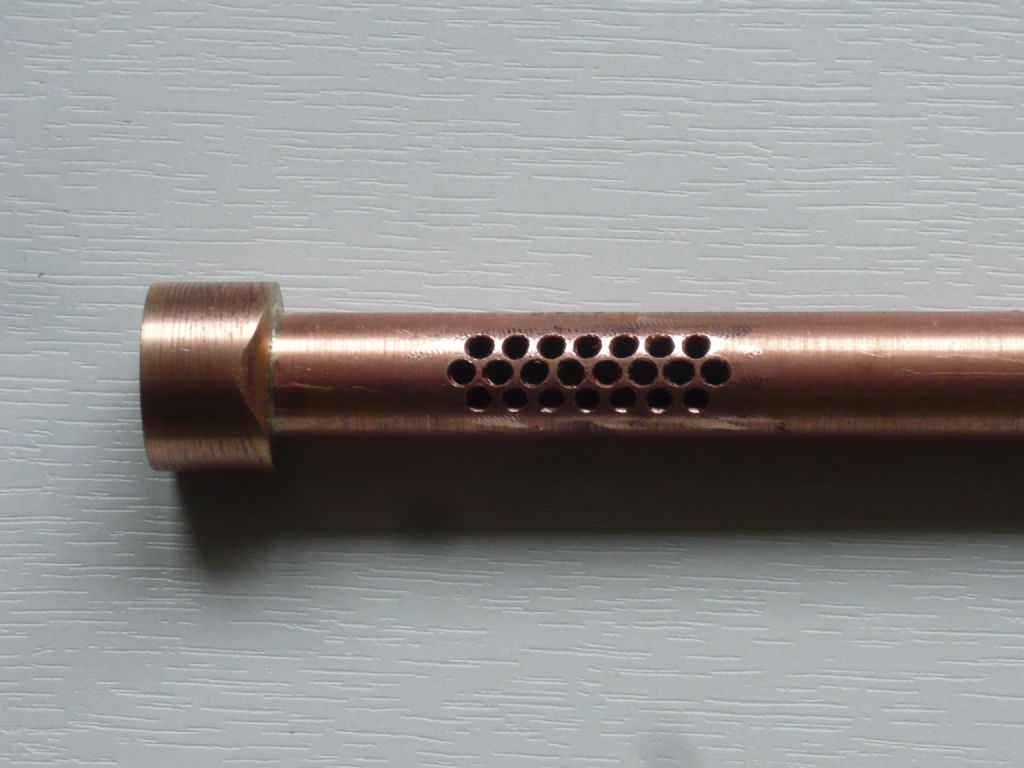

                                Ordered a new piece of tube from Maccmodels around 4.00 in the afternoon and it arrived the following morning strapped to a piece of wood, excellent service!
                                DRILLED THE HOLES!!!

                                      Jon Lawes
                                        @jonlawes51698
                                        How on earth did you make the holes so regular, I can sit for ages trying to line everything up and still end up with my holes looking like Jackson Pollock drilled them…
                                        #399339
                                        Brian H
                                          @brianh50089
                                          Hello John, all done with the magic of a DRO! No (well not much) skill required.
