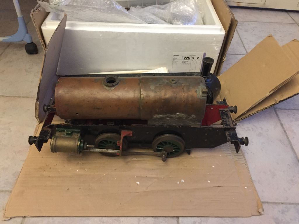

                  I essentially bought the Juliet because I like this model, it is quite simple and I wanted to have a loco in my hands to learn how they are made. For now I had only done with stationary engines, especially from Stuart Models.
                  I've done nothing to the Juliet yet, as I just have had it, I'd like to upload some pics but I don't know how (didn't take time to search…)

                      Yes i have a super X1 mill and 2 lathes (one Fartools 350 and a bench lathe from Einhell (= Clarke and Sieg etc)
                      Many thanks for your opinion about the little Juliet (that's my opinion too). So tonight I oiled every oiling point and re screwed and re-aligned several parts to have the chassis running on air and I'm pleased it runs perfectly. That means if I fix the boiler the loco will be a good runner yes
                      About the photos, I use an iPad so I really don't know how to upload them sarcastic 2

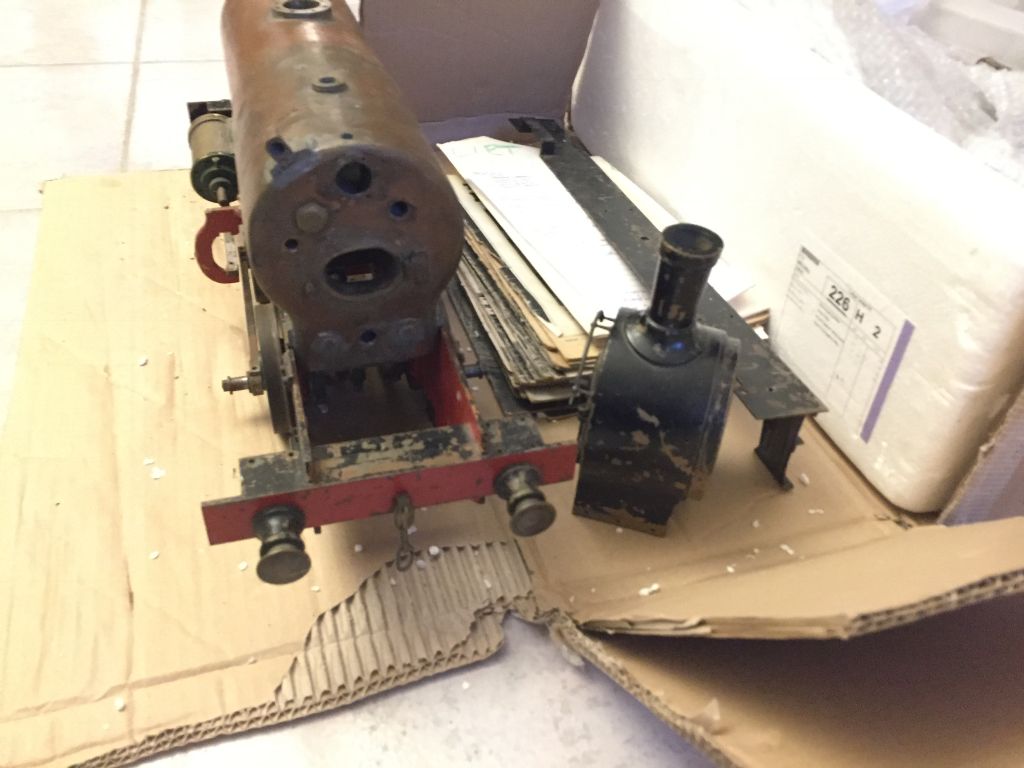

                        Juliet kit

                          Juliet kit

                            Yeah I've found the button smile d

                                  I think you are rather hijackicking Dan's excellent thread of his own build, and your own boiler problems ought to be a seperate thread.
                                  A few detailed further pics of your boiler plus inside the firebox would be of interest.
