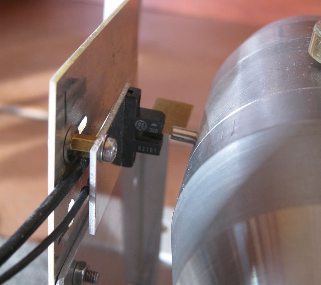

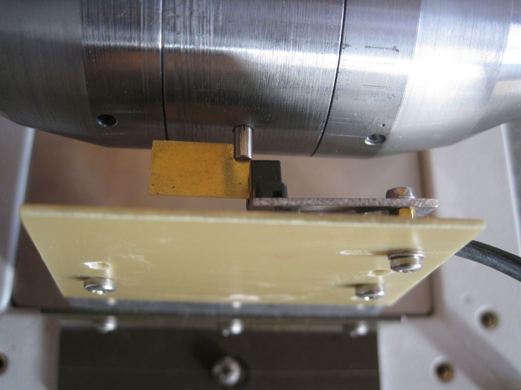

            Its been an interesting day and last night…

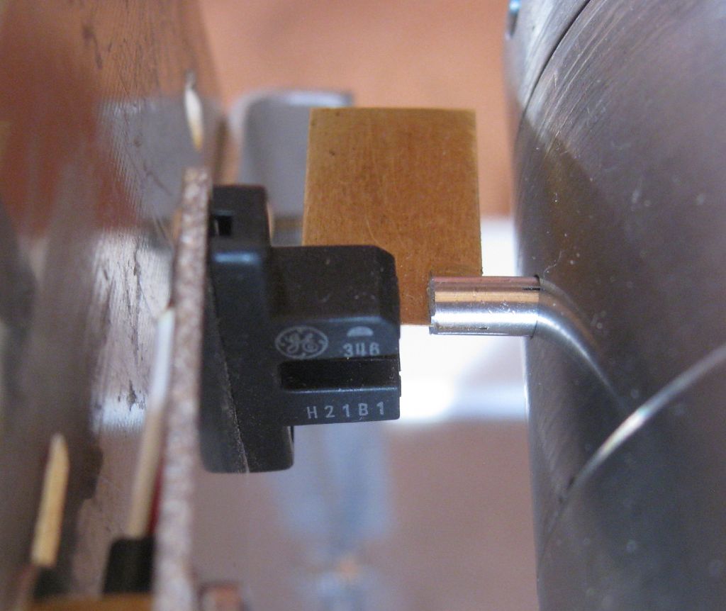

            Yesterday I replaced the V lateral pivots with pin on flats. After that the Q had dropped from around 12000 to 8000. I found issues with the knife edge alignment, and carefully adjusted that and di Q runs till the adjustment was at peak – Q done only at 61% (xPix2). This ended up at Q = 10000 average – still down on my 12500 achieved previously.
            However, what I also did during the V pivot replacement was add the Opto interrupter and accompanying vane on the pendulum. The vane is a long vane – 20mm x 10mm, and starts at the opto slot at BDC, and then covers the slot completely for 1 half swing, so I get a 0.5Hz square wave out of the opto,
            So…. I removed the vane and opto and did a run again – Q=12600! Did another, Q=12400…
            Put the vane and opto back – made SURE there is no rubbing or touching, Q=10100 …
            Removed the opto and the mounting plate and did another run – Q=11000…
            And last, remove the vane as well, again, – Q=12550.
            The aerodynamic effects of the Bob play a massive role on Q! Just that little vane, brass shim stock, costs 1000 in Q.
            I must rethink the mechanics on the vane completely.
            I tried using the zero crossing on me Angle sensor, but that gives me a few 10's of us jitter, which I would like to avoid.
            I also have the bob adjuster protrude below the bob, a 20mm OD x 30mm long 'nut' . Now the bob position is almost on the sweet spot, I can adjust the rate with just the two top adjuster nuts, top near the pivot, so I will cut that bob nut flush with the bottom of the bob.
            The nuts is seen in the lower left photo below, sticking out away from the rod.
            I think we underestimate the effects of bob shape and bits that stick out on the aerodynamic result.

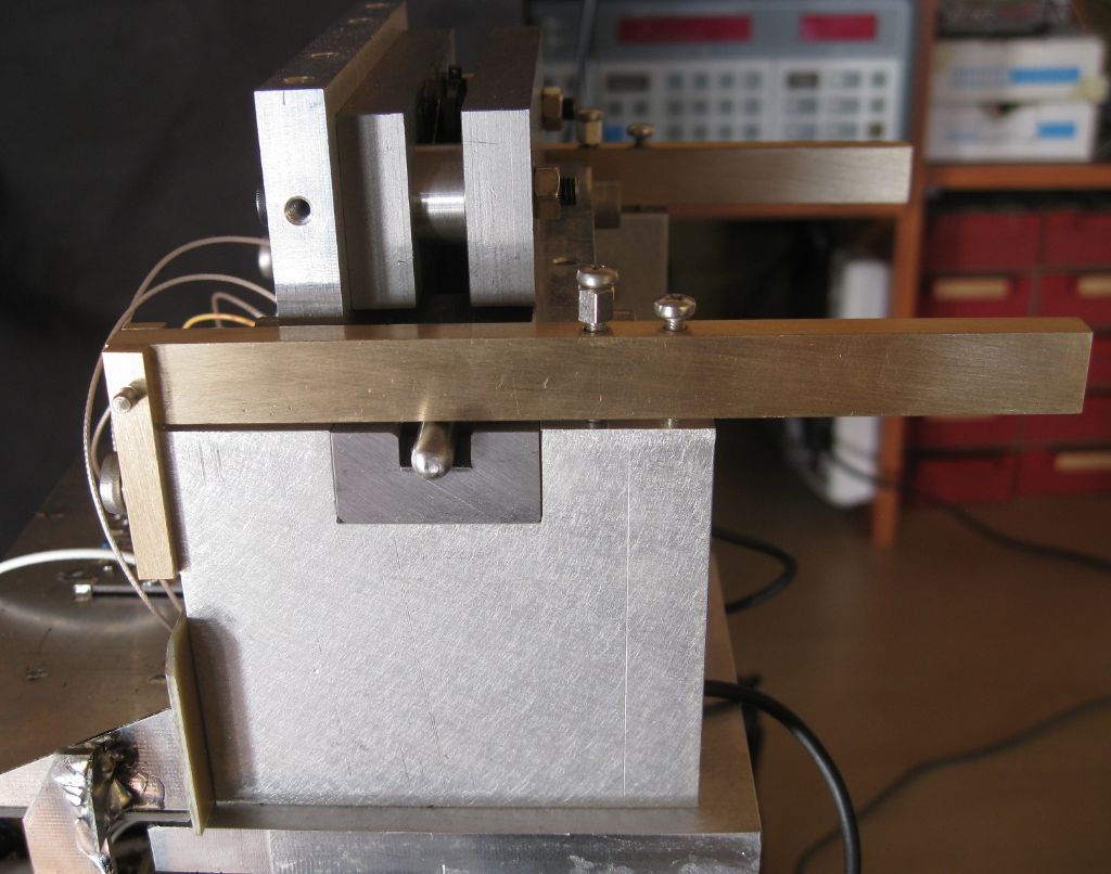

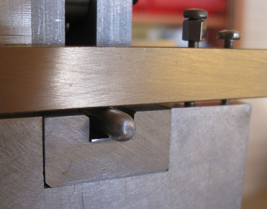

            The new lateral pivots:
            The brass bar can be screwed down hard on the pin, or it can be left floating on the pin, or it can be lifted so the pivot pin is free
            The brass shim vane, center picture, almost in the opto

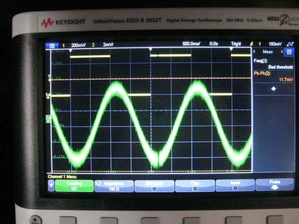

            John asked I do a run-down and let it sit , logging data – I am still logging, but after 6 hours, the pendulum is still swinging – 117mv PP ( scope probes are X10) The angle sensor gives 2V PP for a 2deg swing, so this residual of 117mv is around 117millidegrees PP!
            Walking about 3meters from the pendulum, 8 steps in 5sec, par to the pendulum, and the swing increases to 134mv..

              Posted by Joseph Noci 1 on 02/09/2023 11:48:37:
              Unfortunately its not that simple – The knife riding in the curve is intentional as the capacitive angle sensor vane has to rotate around the pendulum pivot point, which is the knife contact edge. The sensor registers and van movement, which in my case must only be rotation around the pivot. Any movement of the knife on its ledge inthe swing direction is therefore a movement of the vane, indiscernible from movement due to rotation, so it registers and offset, ie, the angle sensor peak to peak measurement remains a constant, but the midpoint is offset by the amount the knife is moved.
              So the curve is an attempt to avoid adjustment or calibration. I suppose calibration – subtracting an offset, or perhaps an offset and higher-order figures, etc., from the data – would be excessively problematic?
              My concern about round anvils is that they are pseudo-flat: neither with a sharp enough curve to accurately position the knives in one fixed place, nor flat enough to avoid skewness.
              I also really don't like the "scratch" method, mentioned above, that seeks to keep the knives in position – that's begging for a lot of extra friction. But fine vertical scratches or marks for the proper position, and the use of a loupe, should allow positioning the knife edges with quite good accuracy.
              My understanding is that the big downside of flat knife rests (whether knife on flat or flat on knife) is that environmental disturbances can cause the pendulum to "hop" minutely, and eventually walk right off the edge. I never saw any evidence of that myself (and I live in a geologically-active region), but my knife-edge pendulum was never intended to run for months or years, and indeed most of the time it was not even rocking. Nevertheless, the fear of that led me to switch to spring hinges for my current effort.
                You aren't alone. I recently read the old articles by Bateman on his clock. He reported similar drops in Q from such small add-ons. Really, every little nut and screw, etc., needs to be optimized for aerodynamics. That includes the surrounding apparatus that is near the pendulum, such as the opto, etc., that influences the air movement around the pendulum.
                Until you are operating in a vacuum, you might as well just figure that, as far as Q is concerned, everything is about aerodynamics unless you are outright scornful of any other frictional sources such as the hinge.

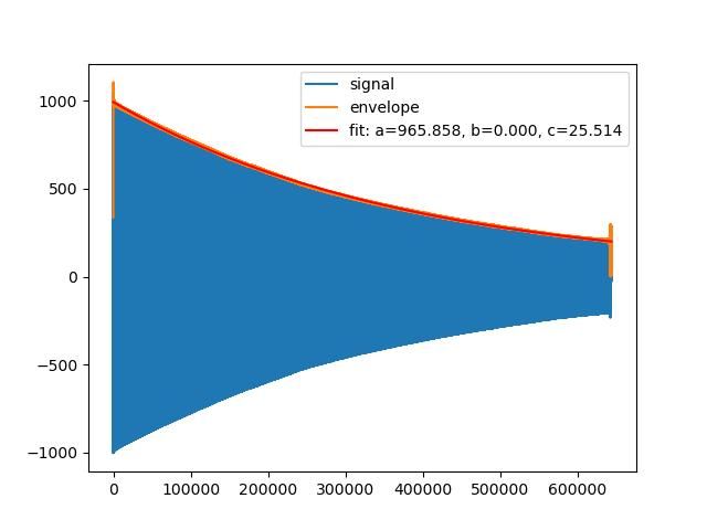

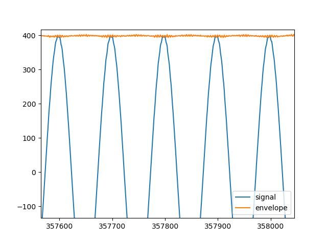

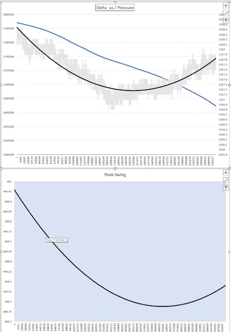

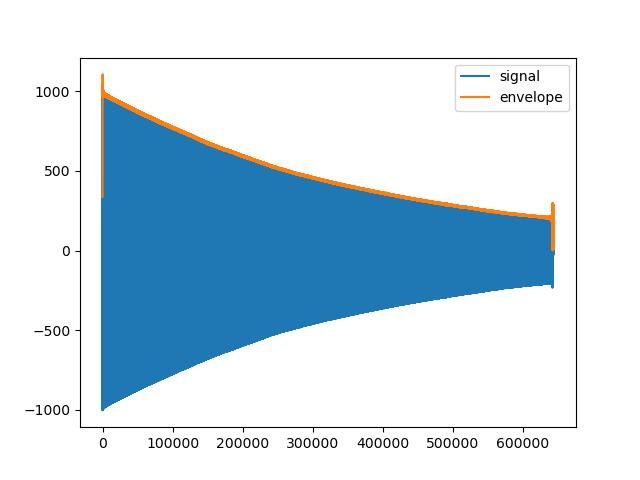

                          Had a go at Joe's amplitude data in hope of identifying his decay curve's values. Mixed success, first problem is to extract the envelope of the signal, which looks good.
                          In the graph below, Joe's signal, composed of sinusoidal amplitude readings. is in blue, whilst the envelope retrieved from the signal is in orange.
                          I expected the orange curve to simply connect the peaks of Joe's data, and it doesn't. Zooming in on the orange line shows it also appears to carry a signal:
                          Not sure why. Possibly to do with Joe's 20mS sample rate, or a mathematical artefact. Or maybe it's a real-world pendulum imperfection. Dunno.

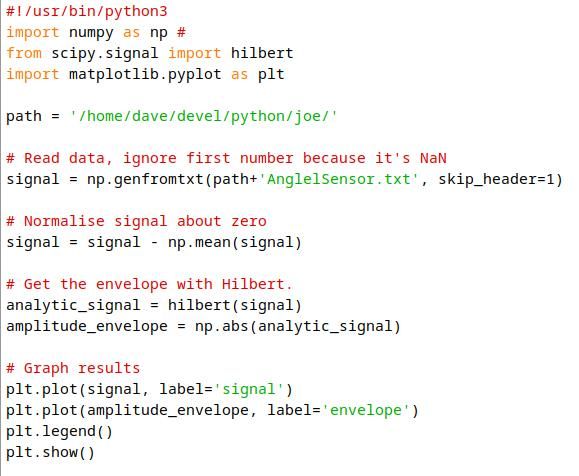

                          Code so far:
                          Next step is to fit a curve to the envelope and reveal its parameters. First attempt wrong, now looking at scipy.optimise.curve_fit. If only I understood it!

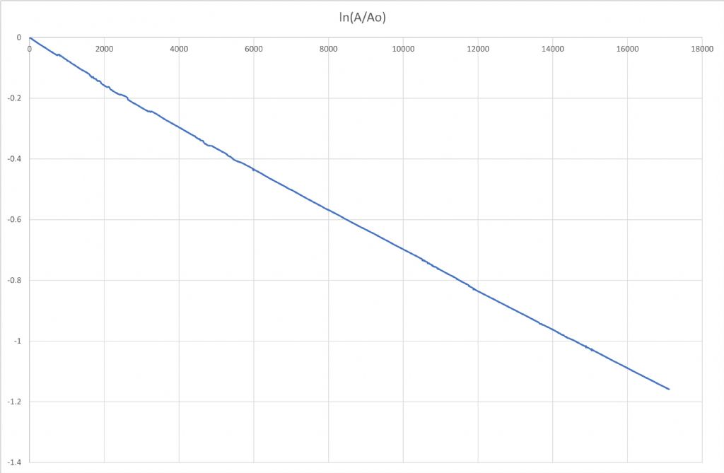

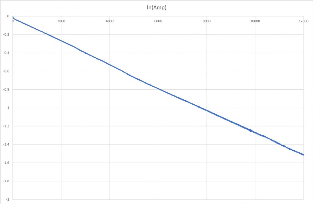

                            I've also had a go at the data that Joe was kind enough to share. He provided a file of essentially voltage samples from his angle sensor. These have a pronounced DC offset on them, larger than the negative peak, so I subtracted the mean value of all the readings from each to get a symmetrical waveform. There was also quite a lot of noise which made it hard to reliably find the peak so I did some crude filtering by replacing each value with the average of five (the sample plus the 2 before and the 2 after); then took the absolute value to include the negative peaks. Then extracted the peak readings using the Excel filter function. Normalised each sample to the value of the first and took the natural log to get this (for the first 12,000) seconds).
                            That looks a pretty straight line to me! It reaches a value of -1 at 7800 seconds in, so the time constant is 7800 seconds. This is equal to 2Q/w where w is the angular resonant frequency, in this case 2pi x 0.5 = pi. Then
                            Q = pi x 7800/2 = 12,250, very much in the ballpark Joes was measuring.
                            I think the reason Joe was getting a strange decay shape was that he took the log of the peaks of the raw data which included the dc offset.
                            Really awkward using Excel for this because there's so much data!  Would be better to use something like R-Studio but I'm not sure it has all the functions needed.

                                One thing to add is that this seems to show that the loss mechanism is nearly entirely simple viscous loss.

                                    Posted by John Haine on 03/09/2023 15:42:05:
                                    Edited By John Haine on 03/09/2023 15:43:58
                                    John, that is excellent work. Thank You. I am pleased the device behaves to some norm..

                                    The second source, and I think Dave found this 'ripple' on the peaks, is embedded in the amplitude control loop – the Peak detector I use to find peak swing is a simple op-amp/diode/cap peak detector and the value of the cap, which stores the peak, plays a major role here. Since the peaks are two seconds apart, the voltage on that cap droops before the next peak – I have 100uf in there, more creates loop instability. And there is a nice 3 to 5mv droop between peaks which feeds the VGA which controls the coil drive voltage, etc. The cap discharge R across it is 10megohm.

                                      Posted by SillyOldDuffer on 03/09/2023 14:25:11:
                                      Had a go at Joe's amplitude data in hope of identifying his decay curve's values…
                                      A result:
                                      From y = a * np.exp(-b * x) + c
                                      The parameters are: a = 9.65858457e+02, b = 2.66220695e-06, c = 2.55142704e+01
                                      numpy,exp() documented here. Returns the exponent eᕁ, the inverse of natural log,
                                      The code:

                                                    Joseph Noci 1
                                                      @josephnoci1
                                                      The last Q run now shows Q to be near to 14000. Q has been slowly increasing over the last 36hours of running – My setup is reasonably stable and consistent and I tend to trust the Q determination. I suspect the increase is all related to the knife pivot. The knife sits in the curve of the bearing inner race and I believe it is not always in the bottom of the curve after any mechanical work on the pendulum. The pendulum rocking motion plus gravity slowly lets the knife ride down to the lowest part of the curve and when there, there is no lateral force on the pendulum, which induces a lateral swing ( 90deg to the main swing..)
                                                      When the knife is at the bottom the Q is good. Comfortingly, I have found a modulation on the angle sensor voltage output which started with a 10sec period ( the peak to peak voltage of the 0.5hz sine swing varies by 3 or 4 mV at 10sec period) and the period increased to with the mV delta now almost being almost indiscernible as the knife beds in. This I believe reinforces the knife bedding concept.
                                                      The pendulum period is presently measured against my GPSDO 0.5hz output. I sat and fiddled with the pendulum adjuster weights till the delta remained fixed , ie , no drift, at that moment and used that as my baseline. I logged lots of data over a large number of hours and the pendulum shows very well the period variation with ambient conditions.
                                                      The ambient temp in the study does not change more than 2deg over 24hours and there seems little correlation between temp and period at this stage. The bob and the rod temp change by 1deg max over that period.
                                                      Humidity is reasonably stable in the study – variation during logging was from 44% to 45.5%, and there seems to be no correlation between humidity and period change.
                                                      Pressure, on the other hand, seems to dominate.
                                                      The curves below:
                                                      Top chart , left scale, Blue curve = delta in us, over 5 hours horizontal scale. ( 2,000,000 us – 2sec period)
                                                      Top chart , right scale is pressure in millibar, max was 1018.4mb , min 1017.2mb
                                                      Bottom chart – the peak swing in millivolts ( or millidegrees) of the pendulum – It follows the pressure curve nicely, with a phase shift that is close to the current control loop response time.
                                                      This seems to show that the swing is increased as the pressure increases which 'sounds' correct – the bob is slowed as pressure rises so the swing reduces, and the system gain then increases to get the swing back up again. It makes sense, but I am not sure.
                                                      This curve is the output of the peak detector that is fed by the sine swing from the angle sensor – Intuitively I would have thought that curve should be flat – If the sine peak reduces the gain increases, driving the coil harder, the swing increases back to the setpoint, and the swing level is back to setpoint.
                                                      I am trying to extract the total control loop transfer function as that is key to the understanding I believe.
                                                      A further complication, due to lack of suitable components – the Voltage variable gain amplifier I use is a linear-in-dB device – the angle sensor output is peak detected and finally drives the voltage control input of the VGA – a 33mv change is a 3dB gain change. So the control is logarithmic and the resulting bottom curve is also log, etc –
                                                      I think there is great potential for the method of amplitude control, but there are too many unknowns for me and I am a bit lost!
