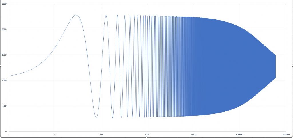

        John, Is this 'log' plot format what you mean?

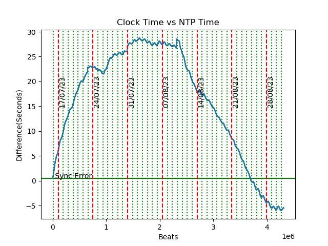

          Posted by Joseph Noci 1 on 30/08/2023 22:06:35:
          Posted by SillyOldDuffer on 30/08/2023 20:02:58:
          At the moment the clock is 6.297933s slow.

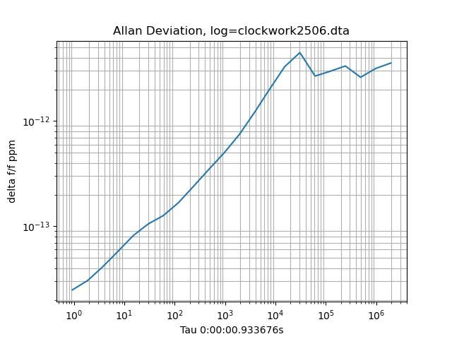

          Just for laughs here's the Allan Deviation.
          6sec in 44 days is rather impressive – 1.6us/sec slow….Not sure my approach will be as good.
          Dave, that ADEV graph bothers me – it is shown reversed to the norm, ie, starts hi and drops, stabilises and then turns up again. Also, way down below 10 minus 13…! That's good GPSDO territory and I am afraid, not possible. Even the Shortt is around 10 minus 8 @ 10 ^5 sec.
          Unless I misunderstand this curve completely, is looks like the curve you get when you do ADEV measurement on an oscillator using a time reference that is derived from the same oscillator – somewhat incestuous…doing so gives a curve that just keeps going down, almost forever – looks good, but is a lie.
          EDIT : is your pendulum running in a vacuum on this test?
          Yeah, that Allan graph bothers me too! I added the code long before the performance of the clock justified it, and strongly suspect something is wrong with my implementation. Not chased it much because other graphs show worrying about Allan is premature. There's nothing legitimate in what I've done to justify 10⁻¹². Got the bits needed to install the vacuum system, not done it yet. At the moment the bob swings uncased in air.
          6 seconds in 44 days would be impressive if it were consistent. Boo, hoo the graph of clock time vs NTP is less impressive because the rate wanders:
          X-axis is in millions of beats, but the grid verticals are midnights, red Sundays. Sync error is the difference between clock start and NTP, another bug in my clock setting code.
          Apart from the large wander, the blue line also has a daily ripple corresponding to temperature change. I'm hoping both are due to an error in my temperature and pressure compensation system.
          I'm letting the clock run in hope more data will explain why the rate changes. Doesn't seem to have an environmental cause.
          Edited By SillyOldDuffer on 31/08/2023 11:28:06

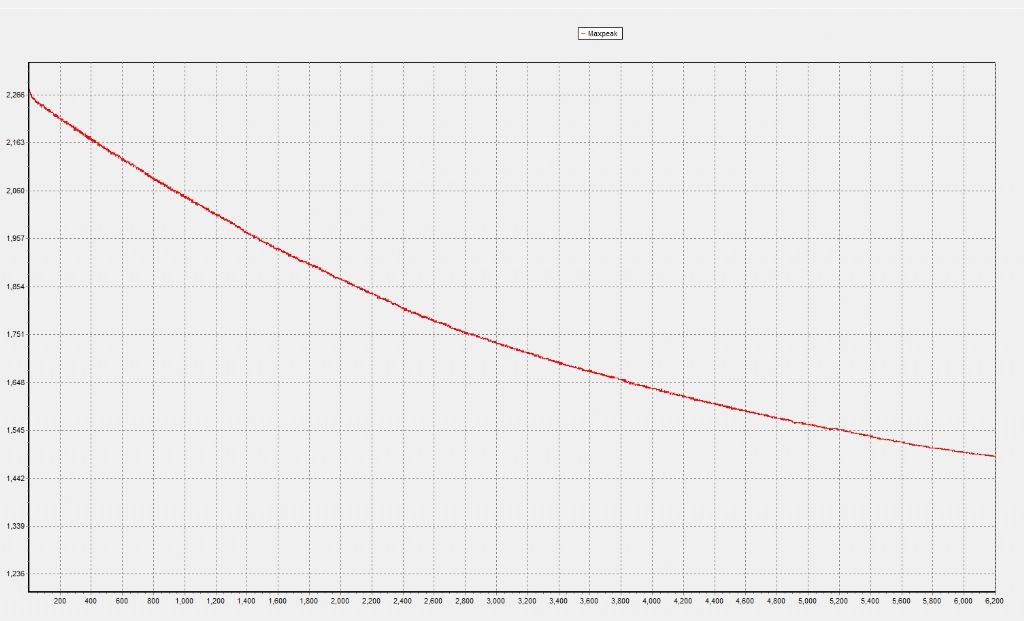

                                    No, I mean log amplitude but linear time. For each cycle take its peak, normalise to the starting amplitude, then take the log. The resulting value for pure exponential decay will be a straight line with negative slope.

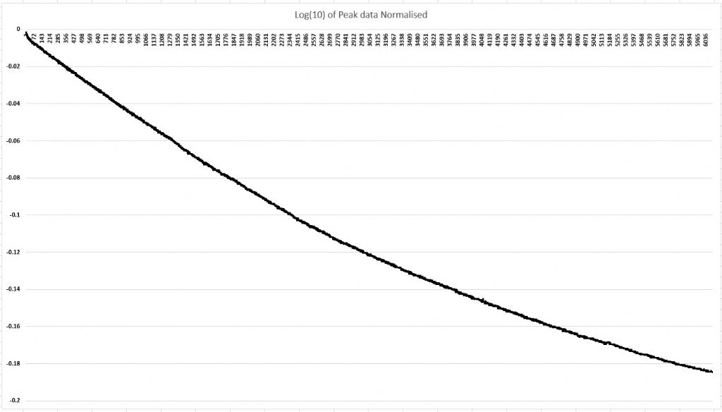

                                        Posted by John Haine on 01/09/2023 06:57:27:
                                        Posted by Joseph Noci 1 on 31/08/2023 09:12:55:
                                        Ok, I think I have plotted it correctly –
                                        This is a plot of Log(10) of normalised data:
                                        Not exactly a straight line.
                                        This is a plot of just the peak values – extracted from the Angle sensor output file, with peaks extracted
                                        These plots are are the same for all intents…
                                        What am I missing?
                                        John, you also said –
                                        You plot the decay I think on a linear amplitude scale. It would be interesting to plot it on a log (ln) scale which is more natural for exponential decay. But it's fairly clear that there is a "break point" where the slope decreases. If you are seeing essentially an exponential shape it's a good indication that the loss is primarily aerodynamic – other forms of loss give different shapes. My pendulum test showed exactly such a break point, with a somewhat higher Q for that part of the decay above it.
                                        Where do you see the break point – in which curves? I would like to understand better.
                                        Also, which curve am I looking at to see 'essentially an exponential shape' ? The Log plot, or my straight amplitude decay curve?
                                        I am somewhat confused –
                                        As my log plot is not a straight line, does this imply that my losses are primarily NOT aerodynamic? If so, the the losses must lie in the pivot?
                                        Or should the curve BE exponential confirming a 'good' set of mechanics, with losses mainly aerodynamic?
                                        I am not sure if what I have is good or bad, nor the reason why!

                                          I am very rusty on this stuff, Jo … but I think you might want to use the natural logarithm:
                                          **LINK**
                                          This looks like a good tutorial … I’m off to get a drop of Jura
                                          Edit: __  Try here: https://serc.carleton.edu/sp/library/teachingwdata/graphsexponential.html

                                              The natural log will just have the same numbers multiplied by a constant, which from memory is I think 2.302 [ln(10)] (could be wrong).
                                              Joe, could you email me the numbers behind one of the plots please? I could try to illustrate what I mean.
