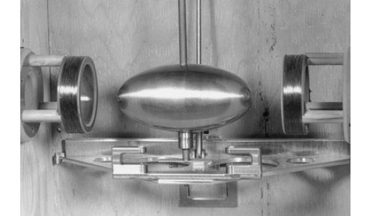

Low speed aerodynamics are difficult – there is a glaring scarcity of scientific data at such low Reynold numbers – sub 10, even below 3 or 4…In aircraft wings design I worked with numbers up in the R10,000, for fighter jets, down to R1000 or so for small UAV's – there are few software tools that model correctly below R10. There are toold for liquid flow in pipes..
What is valid though, and contrasts with aircraft wings, is that laminar flow is not a Bob's friend. When the air sticks close to the bob, at low bob velocities, it causes the glove of air attached to the laminar layer to be dragged along, instead of being pushed aside. That artificially increases the perceived size of the bob in terms of frontal air area, and therefore drag. Cylinder bobs standing up are bad – flying saucer bob horizontal are almost as bad, vertical are quite good. Rugby balls are very good, but MUST be aligned in swing, else much worse than most. Balls are a reasonable compromise, better than cylinders.
Turbulent airflow is , as in aircraft, just bad and causes wobble of the bob. Also, a problem that aircraft don't have, the air pushed aside, now turbulent, is not displaced far away and the returning bob rides through old turbulence on its return trip..
perfection would strive to have a rugby ball shape, polished mirror finish, so that laminar flow is encouraged, with a small ring around each nose of the ball ( position and size of ring critical, or course), called a trip – as the airflow reaches nice laminar conditions, the trip breaks that flow so that the air detaches from the bob surface and flows smoothly past the bob.
This is used on aircraft as well, esp really fast ones, to break the air from the wing – friction is reduced , sometimes up to 30%, lift can be increased by up to 15-20%, and during high angle on attack, stall can be delay by 4-5degrees. all for a piece of wire…
Edited By Joseph Noci 1 on 16/08/2023 21:57:13

I'm awaiting your ultralow speed wind tunnel to optimise bob shape. Mine's cylindrical, axis vertical. Next one will be rugby ball passing into large diameter air cored drive coils. I wish I understood magnetic circuit design!
Don't exist…With all the associated compromises, these sorts of tests are normally done in water with dye injection, and then they try to extrapolate to air and compensate for viscosity, etc – Most times you get as accurate an idea by blowing your pipe smoke into the clock case and watching the smoke.
A neat way is also to have a smoky flame from below, and orient the bob vertically for a rugby ball bob, for example, with the smoke hitting center of bob point. Video the smoke/air flow to capture the vortex, and play back slowly and compute the air speed from the distance traveled by the smoke in 1 sec, etc. Use a hotter flame for faster, or cooler for less..and then clean up the mess.

Why would the vertical vs. horizontal orientation of a same-shaped bob matter? I've always wondered why saucer shaped bobs hang vertically, when that requires the alignment to be perfect, while horizontal has no alignment problems.
Sorry for the belated response – problem with these topics sometimes – they pop off the stack so quickly and then are forgotten till news is worthy of publishing again…
In a pendulum where local air is becoming the limiting factor, bob shapes play a significant role. A vertical saucer presents the same aerodynamic shape while swinging in an arc ; when fitted horizontally, the air flow over the top will tend to break away from near midway on the upper surface and becomes turbulent in the bob's wake. That increases drag, induces wobble, and the bob has to return through that still turbulent air. The air on the bob underside suffers similarly, except slightly reversed and somewhat reduced – the leading edge section has increasing angle of attack with air breakaway, and the resulting turbulent air washes over the trailing edge. We are talking of VERY small effects here, but significant when you are trying for short of Shortt performance.
In a pendulum where local air is becoming the limiting factor, bob shapes play a significant role. …
Rawlings (in The Science of Clocks and Watches) discusses bob shape in Chapter 4 (Dissipation of Energy by a Swinging Pendulum), and DA Bateman adds a useful section in which 'The objective was to discover which shape would give the lowest air resistance for a given volume, and hence the largest Q for a given mass and density.'
In short:
My pendulum has a mild-steel cylinder bob, not a good shape and it might rust, but I plan to swing it in a partial vacuum. As my ancient vacuum pump only gets down to about 600mb, I might try to improve the shape by rounding the ends into a "cylinder with hemispheres".
Cylinders are easier to make and balance than other types, which is a practical advantage.
I guess Joe's bob shape isn't the absolute best possible. However, still hot stuff – better than a sphere, and much better than my cylinder.
I don't think Rawling's mentions polishing. I'd expect a highly polished bob to perform better than a rough one.

Anyone know what the ideal ratio of long axis to short axis for the oblate spheroid bob is? It scales at about 2:1. And what is a 'football shape with pointy ends'. I'd expect the oblate spheroid to be a football (US version, rugby ball to Brits)
Anyone tried British Library for Matthys book?
Michael, it depends on what the Pendulist is wishing to achieve. Vacuum tops it all, and then shapes and dimples are moot.
I have some odd 'standards' or limits I wish to abide by, and I feel using a vacuum is not allowed. So if the aim remains to achieve really good performance, then it is very relevant indeed. Since losses in air amount to over 90% of pendulum loss of mechanical energy, assuming a decent pivot, any % gained in reducing air resistance is a boon.
Those Tubercles on the whales flipper are working at very low speeds and have been shown to increase efficiency ( by measuring lift) by anything up to 30%! The problem is quantification by amateurs and amateur methods and tools…Since my main field is aerodynamics I have a very good feel for this, but at these low speeds it is very difficult indeed to quantify – hence my pedantism on trying to find a reliable, quantifiable, repeatable method of measuring Q. Most folk want high q to be able to eventually 'measure' tides – I want Hi Q so I can measure aerodynamic effects and the effect on Q.
I would propose that it is a straight oblate spheroid, but with a missle nose type tip so that the air is separated cleanly rather than compressed and then squashed aside – but how long is a point, and where around the oblate does it start…I think just a point will do better than none.
As to ratio – I have seen proposed ( I am digging to find the reference again..) that the ellipse should fit inside a Golden Rectangle = Golden Ellipse

Posted by duncan webster on 22/08/2023 16:32:58:
I agree on the first part of that, Duncan … but not the second:
https://www.dimensions.com/element/american-football

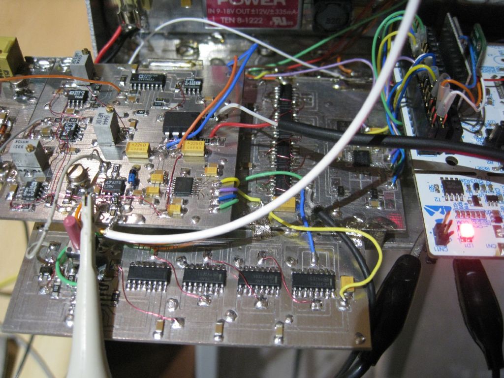

My initial attempt at controlling to a fixed amplitude has met with some success and promise.
I used the angle ( = amplitude) of the pendulum as given by my angle sensor as reference, phase shift that sinusoid by 90deg and feed that to the coil driver, and control the level of that voltage so that the level of the voltage from the angle sensor remains constant.

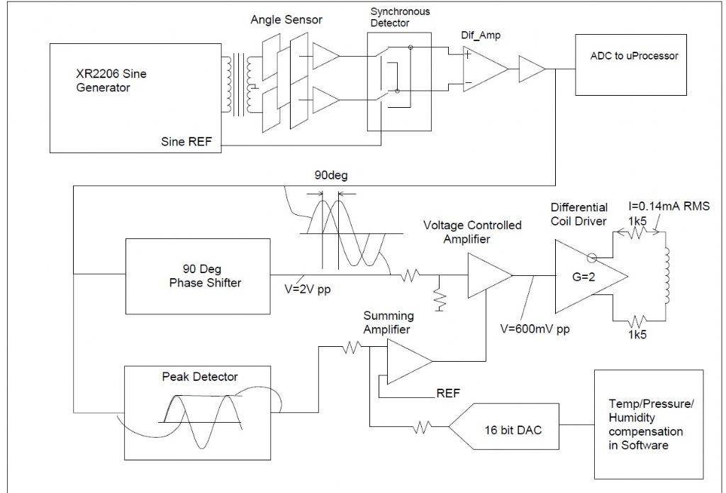

A block diagram of the electronics:
A Sine generator generates a sine wave at 5KHz and feeds a 600ohm-600ohm transformer which drives the differential angle capacitor sensor. The pickup sensor of said device is buffered and feeds a synchronous detector, driven by a reference Sine from the sine generator. The resulting DC output is amplified differentially and filtered. This resulting voltage is a representation of the pendulum angle since the senor is fitted to the pivot.
This 0.5Hz sine wave feeds an ADC read by the Nucleo processor, for later processing.

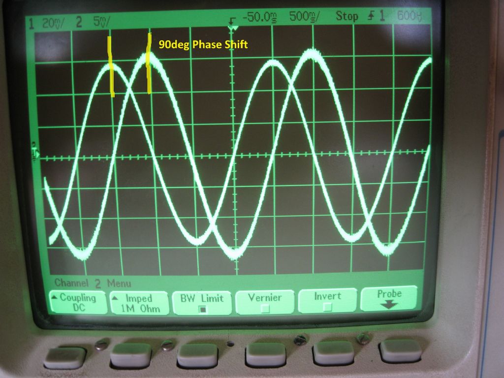

The 0.5Hz also feeds a 90deg phase shifter. The shifted phase is required since the pendulum drive is via a drive coil atop the pendulum, above the pivot, and is fed with a sine wave drive per swing, all the time. The 90deg shift ensures that the sinusoidal drive voltage is at its peak when the pendulum is at BDC, and minimum when the pendulum is at the extremes of swing. There are no impulses, just a good sine wave drive, and I hope this will result in almost no pendulum perturbation.
The driving voltage level is maintained within a closed gain control loop – the pendulum angle sinusoid feeds a Peak detector, which generates a DC voltage equal to the peak of the voltage of the pendulum swing extremes. This DC voltage controls a voltage Gain Controlled amplifier. The input to the amplifier is the 90deg phase shifted sinusoid, and the output is that sinusoid, level controlled , to ensure that the pendulum swing angle is maintained. An increase in angle( amplitude) increases the Peak detector output and the VGA gain is reduced, reducing the drive sinusoid voltage to the pendulum drive coil. Reduction of swing is a reduction of the DC output of the Peak detector, causing an increase of Gain in the VGA, and increased drive to the pendulum coil.
The RMS current in the drive coil is 0.14mA when the loop is stable. The angle sensor Peak to Peak voltage output for a 2 deg total pendulum swing is 2 volts PP. This voltage varies by less than 0.2mV over 3 hours with the loop stable.
The drive voltage from the coil driver is 1.2V PP, and feeds the 10ohm coil via 3000ohm series resistance.
The Peak detector output is summed with the output from a 16bit DAC. The DAC output will be used to provide a voltage offset to the VGA, causing an increase or reduction of the swing amplitude. The intention is to perform temp/pressure/humidity compensation is software, and to feed corrections via the DAC to the VGA.
Presently there is no microprocessor control at all. There is a Time to Digital convertor that measures the time in nanoseconds from the rising edge of a 0.5Hz reference pulse from my GPSDO, and the rising edge of the pulse from the pendulum BDC sensor ( an opto interrupter). This will be used to Phase lock the pendulum to the GPSDO 0.5Hz pulse initially, by control of the DAC, breaking the Peak detector loop. When phase locked to the GPSDO reference, the uP will
log the variation of DAC control voltage to maintain lock, as well as logging Ambient temp, pressure, Humidity, bob temp, and rod temp.
I hope to find a way to implement some sort of amplitude compensation using all that data as reference input, at which point the pendulum will be released again and be free running, with only the amplitude loop controlling it, and the uP performing environmental corrections only.
The phase shifter is also able to be voltage controlled. If the amplitude control of the coil drive voltage does not achieve the control required ( since period is largely independent of amplitude) then the VGA loop will control amplitude, and the DAC will be used to adjust the drive voltage phase, allowing a lag or lead drive voltage to slow or speed up the swing.
A lot of electronics and a lot to experiment with….quite enjoyable.
Starting some logging now to see how the phase lock to GPSDO performs, and now that the ADC is in place, I want to do a few run-down swings to try calculate Q…
