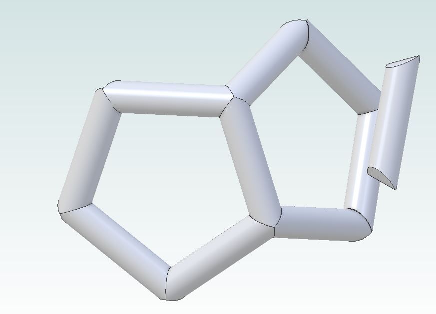

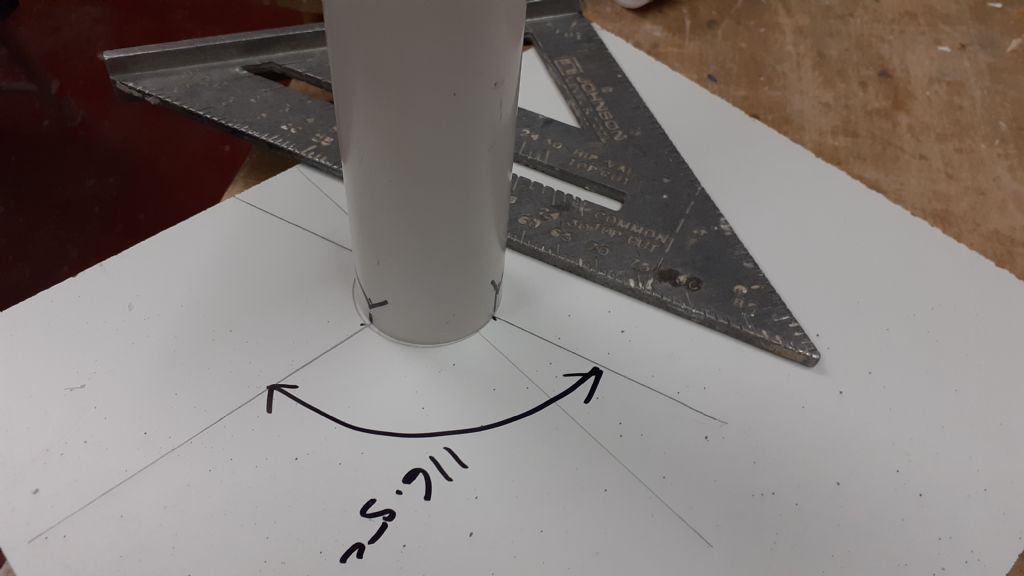

      Yes you are right Duncan, I had one of the angles wrong two straight cuts each end will work or the triangle to give a more rounded external corner
      I was right with the 36deg mitre angle but the rotation should have been the complamentry angle of 63.4 so the tube needs rotating 116.565 degrees for the second 36deg mitre cut.
      Looks like it goes together though I was having a job totally constraining the positions, one tube to go
      Edited By JasonB on 28/03/2023 19:22:15
      Edited By JasonB on 28/03/2023 19:35:46

          If you put the tube at an angle of 20.91° to the horizontal then the two angles you need to cut are 60° from the vertical plane that goes through the tube centreline. It should be possible to make a simple wooden jig to allow them to be marked out like this.
          A chop saw with a tilting head set to 30° off vertical and horizontally rotated the 20.91° will also make this cut but cutting steel may be an issue however cutting a wooden saw guide/marking out jig should be easy.

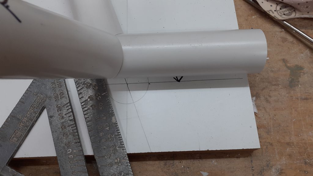

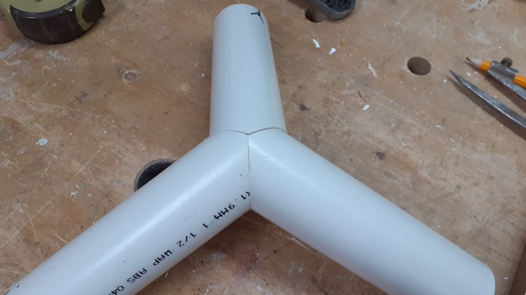

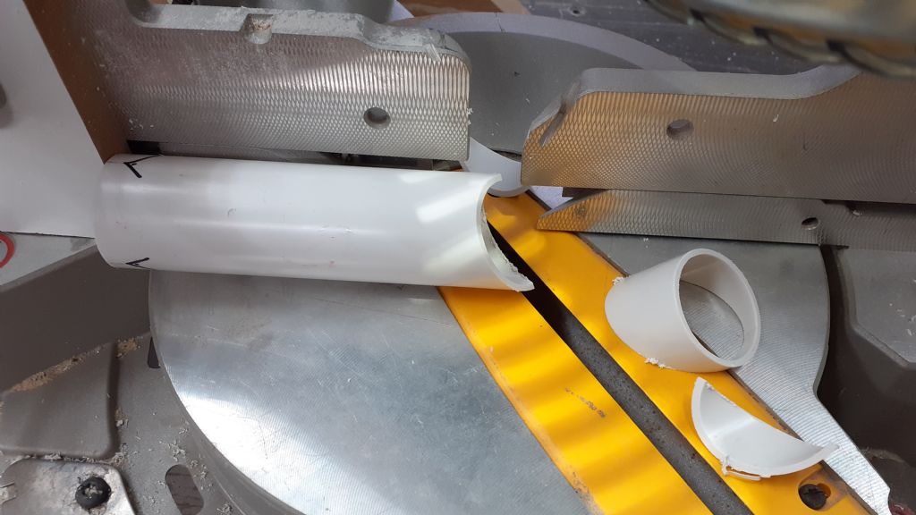

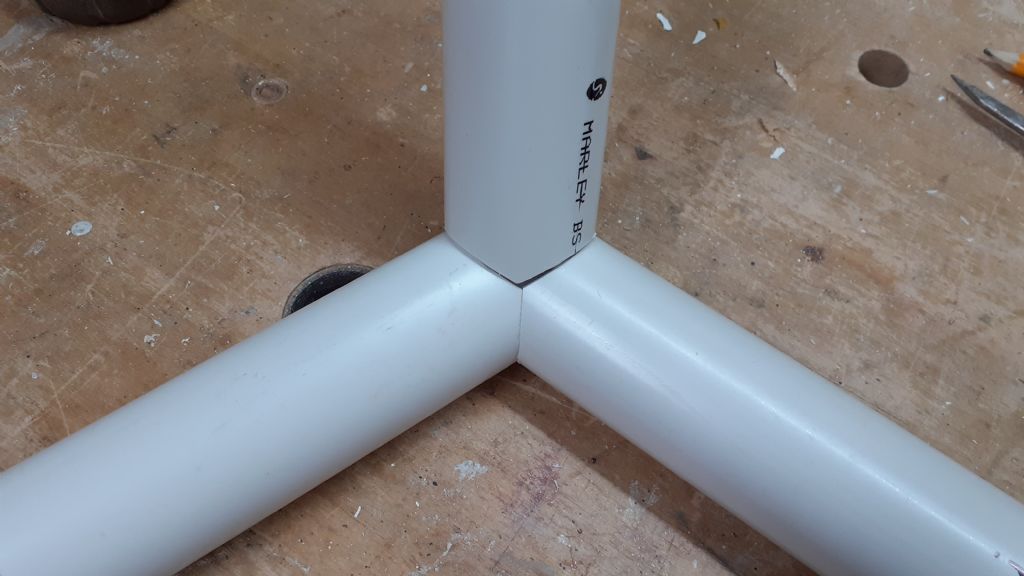

                  I gave it a go
                  First marked out the 116.5deg with a speed square, stood the end of the pipe over the guide circle and marked the two angles. Not the most accurate method but good enough to get an idea if it's right.
                  Over to the SCMS and set mitre angle to 36deg, make a cut, rotate to second mark and cut again
                  Stick them together, the 108deg external angle is good
                  Slight inaccuracies in the 116.5 deg marking out and indexing leave a small gap but spend a bit more time getting that right and a tighter joint will be possible. Certainly good enough for welding anyway.

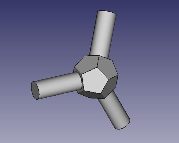

                          Just in case Andrew wants an extra-difficult, time-consuming and expensive alternative to Jason's excellent solution, it can also be done by making pentagonal dodecahedron end fixings. These are prettier than balls, and complete the motif!
                          The method is easy, and the dodecahedron fixings could be threaded rather than welded.
                          All that's needed is 20 steel dodecahedrons big enough to join 2" diameter steel pipe, bored on 3 faces. A mere detail I'm sure! So the next challenge is "How can I make 20 fist-sized steel dodecahedrons in a home workshop?" (With mill, lathe and the usual hand tools.)
                          devil
                          PS.  On a CAD note, FreeCAD did better than Solid Edge on this particular problem.  As far a I can see SE doesn't have a tool for creating dodecahedrons, so they have to be developed from first principles – hard work.   FreeCAD has an add-on workbench for making pyramids and polyhedrons, so they're just a button press.   Trying new things caused the usual CAD grief, which is the software not working quite as expected.   It's easy when you know how!

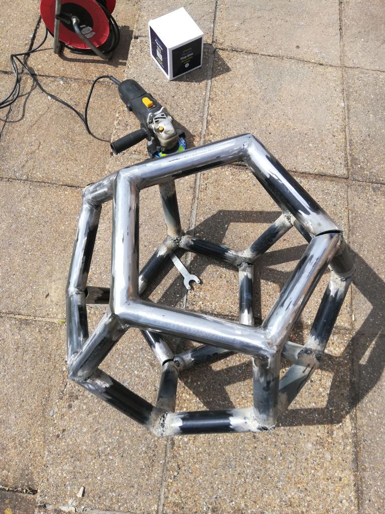

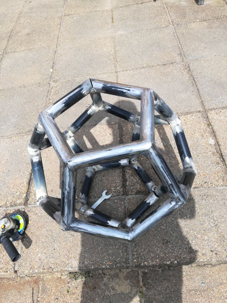

                                                  I am almost embarrassed to post these pics but given the help from members of the forum in sorting out what should have been a blindingly simple problem I owe a debt of honour.
                                                  The welding is truly shocking but luckily flap wheels are pretty cheap. That task will fill a few hours.
                                                  Rushed the marking out resulting in some poor relationships on the end of some parts that needed a bit of filling. First attempt with gasless mig and I struggled to get the settings sorted for what turned out to be 1mm wall thickness.
                                                  Wife hates it and wouldn't have it near the garden. So a nice idea poorly executed and not liked by the intended market. At least I am consistent.

                                                    Nice, but cleaning up the welds is going to be a pain. That's what apprentices are for!
                                                    35A and 17volts using tackwelds would do it, in-out in-out
                                                    #642892
