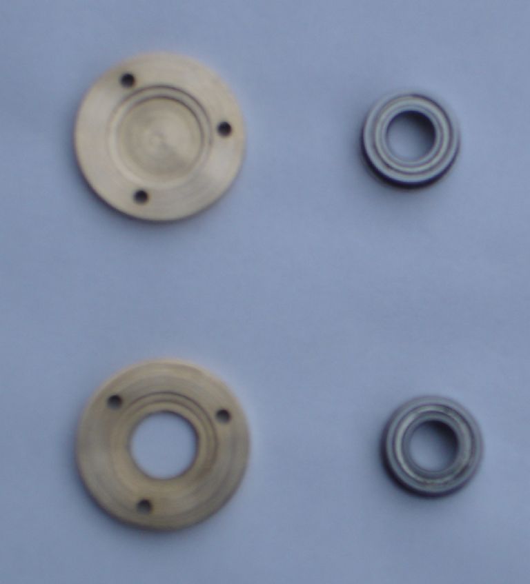

            dsc00013.jpgMaining springEscape anchorsSome time ago Mr. Russell Eberhardt posted that he intended to build the month going version of the John Wilding regulator but fitted with ball bearings at all pivot points and invited comment from anyone who had built this clock.
            In 2002 I built the eight day going version of this clock as described in Mr. Wildings book except for the maintaining power spring (q.v.) I had no problems building this clock and it kept time to two or three seconds a week on a 5lb driving weight. At a later date I added jewels to all pivots except for the hour hand arbor ,as this carries no load, and the winding barrel arbor and front pivot of the centre arbor as no jewels were available for these points. At the same time I replaced the solid escape anchor with the Vulliamy type.These modifications enabled the driving weight to be reduced to 4lb with the same time keeping.
            A couple of years later I built the same clock for a friend but this time with an escapement anchor spanning seven and a half teeth as I had read in the literature that a `Square` escapement spanning seven teeth was the optimum form of the dead beat escapement. This clock gave the same performance but required a six lb driving weight.
            After reading the discussion of Mr. Eberhardts proposal I fitted ball bearings to the winding barrel arbor and the front pivot of the centre arbor.. These are flanged shielded bearings. The winding barrel arbor bearings were 0.5" o/d and 0.25" i/d and a light push fit in the frame plates and retained with collars and 10 B.A screws and the centre arbor bearing was 6mm o/d and 3mm i/d and made a light press fit in the frame plate I first tried the ball bearings as supplied and then with the grease flushed out but could detect no difference in the pendulum swing. I then ran a drop of clock oil into each bearing as an anti-corrosion measure.These modifications enabled the driving weight to be reduced to three and a half lb.and the time keeping was unaffected.
            May I offer the followings comments on the month going version for consideration.
            Ball bearings are cheap and easy to fit. The jewels in my clock were imported from `The Swiss Jewel Company` in the U.S.A who have a minimum `shipping` order of 100$ which makes the price prohibitive unless more than one clock is being built, as in my case. The maintaining power spring in my clock is gauge plate 18 s.w.g.(0.048) thick and 0.070 wide. As the stiffness of this spring increases as the cube of its width it would not need to be much wider to suit the increased weight needed to drive the month going version and would be much simpler than Mr. Wildings bolt and shutter arrangement. The pin at the top of the great wheel in the photo limits the relative turning of the maintaining ratchet to the great wheel to four teeth, which is adequate and avoids over-stressing the spring.
            For anyone building the clock from Ball bearingsscratch, cutting the winding barrel right handed would cause the driving weight to move away from the pendulum as the weight descends as originally intended and may permit the fitting of some sort of stop-work which is absent form the present design.
            I hope that these comments are helpful to any future constructors of this regulator.
            John Parslow

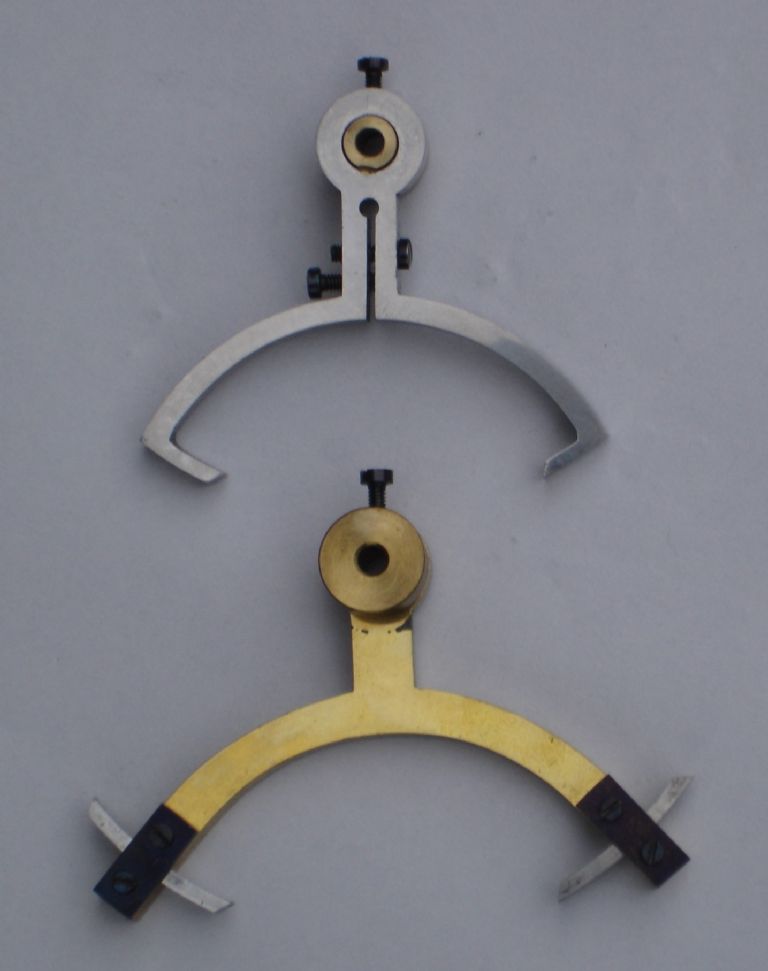

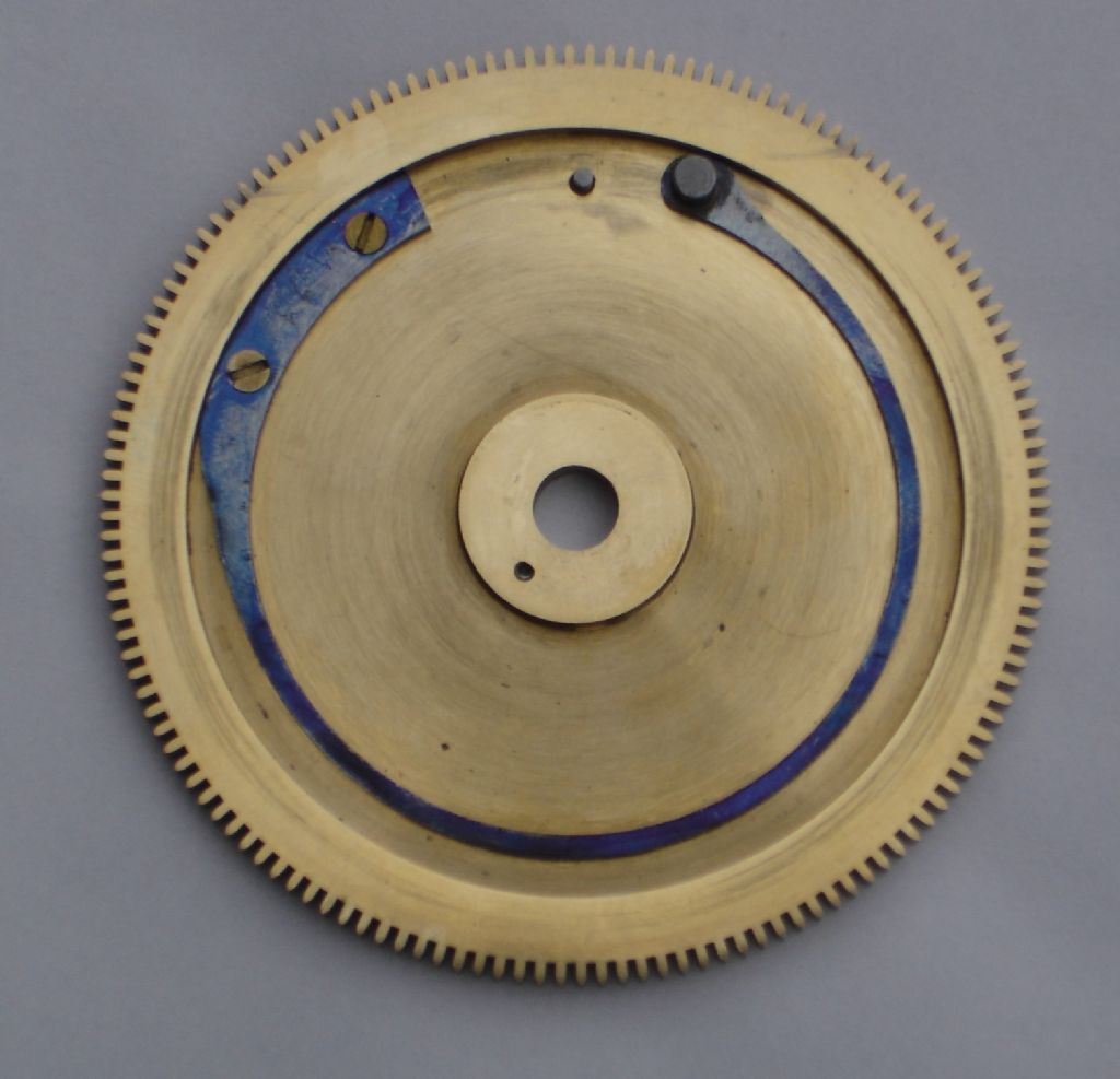

                        Makng some progress at last. I now have all the wheels and pinions fitted to their arbors and mounted in ball bearings with bushes in the plates.
                        I'm about to start on the pallet assembly to the Valliamy pattern. JW's book quotes 2° for the impulse angle and shows how to lay out the pallets using an impulse circle of 1.21" rad. I drew this up in a CAD program and found that using an impulse circle that big gives an impulse angle of 2°. There is a copy of that drawing here
                        I've found that, in order to acheive a 2° impulse angle I have to reduce the impulse circle to 1.03". That seems to be a big change. Has anyone else noticed this problem or have I made an error?
                        Russell.

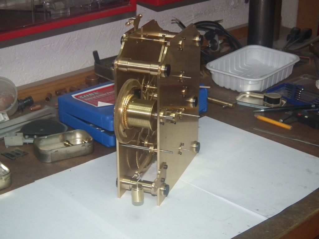

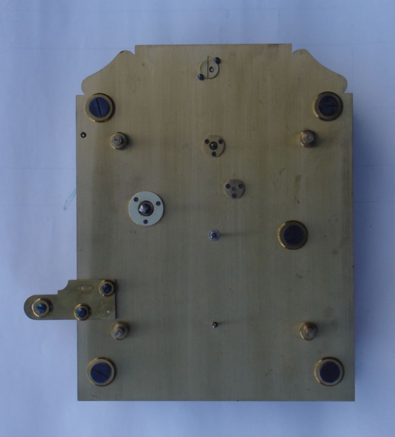

                          It's a while since I gave a progress report.
                          Well, first I noticed a mistyping in the above post, an impulse circle of 1.21" radius gives a 2.7° impulse angle not 2°. That was my problem. I decided to use a 1.03" impulse circle, giving the correct impulse angle and it seems to work O.K. At least, using Valliamy pallets it will be easy to change if I have made an error.
                          The movement is pretty well finished:
                          All arbors other than the bolt and shutter maintaining work are fitted with stainless steel ball bearings.  Just have to make the dial and hands. I will make the dial by photoetching. I have tried out the process making the beat plate and after several trials I think I have got the parameters right. Just trying to pluck up the courage to try it on the dial.
                          I found that Invar is very expensive here in France so I have made thee pendulum rod from a unidirectional carbon fibre composite. That material has a very small negative temperature coefficient which will compensate for the suspension, the bob, and the short length of threaded rod for the rating nut. The transition from the carbon fibre rod to the threaded rod was made 30 mm below the centre of the bob which should give the correct compensation.
                          I have added a few more photos to my album.
                          Russell

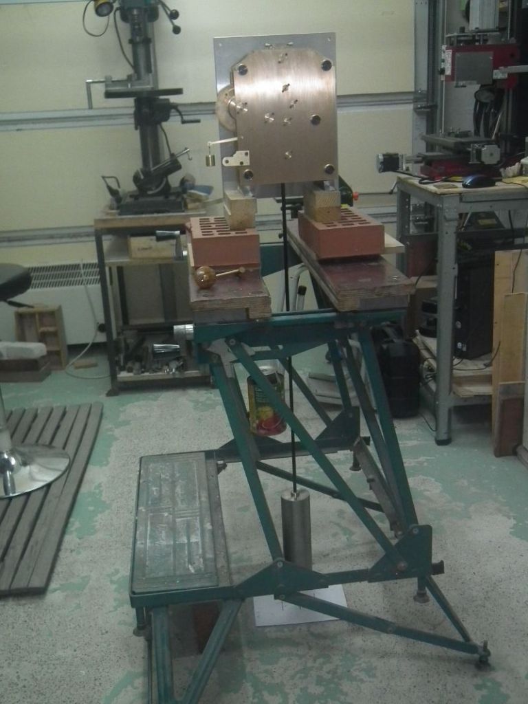

                                O.K. I've set the clock up for testing:
                                The clock runs well with 4 lbs weight on a single drop so will need 8 lbs on the pulley. That compares well with John Wilding's month going version which he said needs 14 lbs. It isn't as much of an improvement as I had hoped so I thought I'd do some investigation. At least I'll be able to make the weight a bit slimmer.
                                I measured the pendulum Q factor by setting it swinging freely and counting the number of complete back and forth swings it would do before decaying to 37 % of its starting amplitude. It came out at about 1800 swings so the Q = 1800 x 2 x π = 10,000 which is about the figure expected.
                                My next test was to run with a light short pendulum (actually just 1 oz on the end of the crutch). That gave the surprising result that it would run with only 12 oz of driving weight.
                                So it would appear that the energy required to overcome friction in the movement is less than 1/4 of that required to maintain the pendulum swing. That should bode well for the timekeeping.
                                Russell.

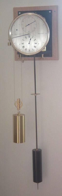

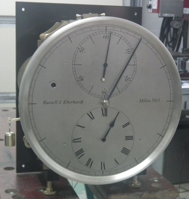

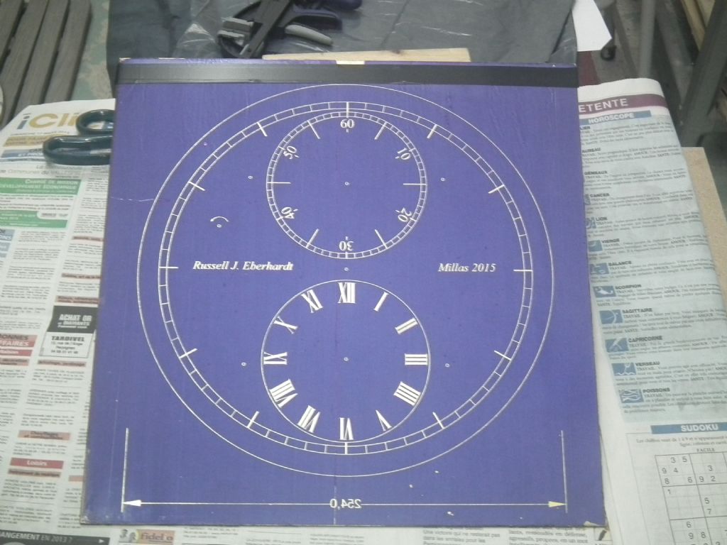

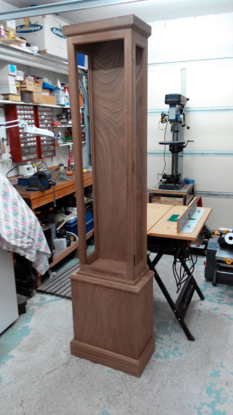

                                            I don't seem to be able to get much workshop time these days with all the other pressures on my time. It's nearly a year since I poste my last update so it's time for another.
                                            About a year ago I had the movement test running propped up on some bricks on a Workmate. My next task was to make a dial. I drew up the dial in reverse on Draftsight and printed it out on Xerox transparent film in two parts as it is too big for my A4 ink jet printer. I found the inkjet printer in photo mode gave a better result than my laser printer. The two parts were lined up using printed registration marks and cut and joined. I then laminated some dry film photoresist onto a sheet of brass using an office laminator and and exposed the resist to UV from the sun for three seconds (not having a light box) . After developing I had this:
                                            I then silvered the dial using silvering powder from Honiton Clocks and lacquered it with shellac. All the above required numerous experiments to get the process right.
                                            Then it was just making the hands. I intended to use my little cnc mill to cut them out but a computer failure occurred and I ended up making them by hand the traditional way. I don't think the result was too bad:
                                            The clock is now running and mounted on the dining room wall while I continue with the case:
                                            I had to get the hardwood for the case shipped over from the UK ans I couldn't find a supplier here other than complete trees sawn into planks. Anyway, the case is now ready for varnishing:
                                            Not much left to do now smiley
                                            Russell.

                                              That's looking rather fine, Russell
                                              #236615
                                              Ajohnw
                                                @ajohnw51620
                                                That looks very good Russsell. Glad to hear that the photoresist can be exposed in the sun. I've done that with pcb's so wondered.
                                                Tempted to mention types of ball bearings but I think I will put it in the beginners clock thread.
                                                #236620
                                                  NIce work, Russell.
                                                  #236622
                                                  roy entwistle
                                                    @royentwistle24699
                                                    Russell Well done
                                                    Roy
                                                    #236625
                                                    julian atkins
                                                      @julianatkins58923
                                                      Hi Roy,
                                                      That is a truly beautiful clock and dial and case! Wonderful work!
                                                      How did the dial surround/rim change from 'silver' to brass?
                                                      Will you add a brass sleeve to the pendulum bob?
                                                      What wood did you use for the case?
                                                      Cheers,
                                                      Julian
