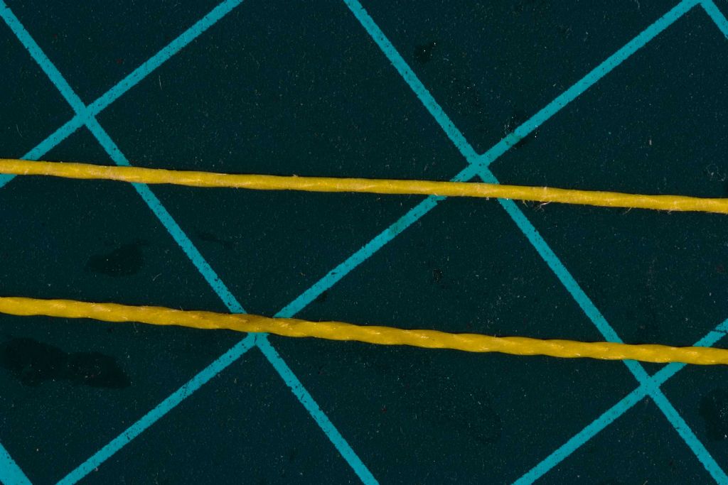

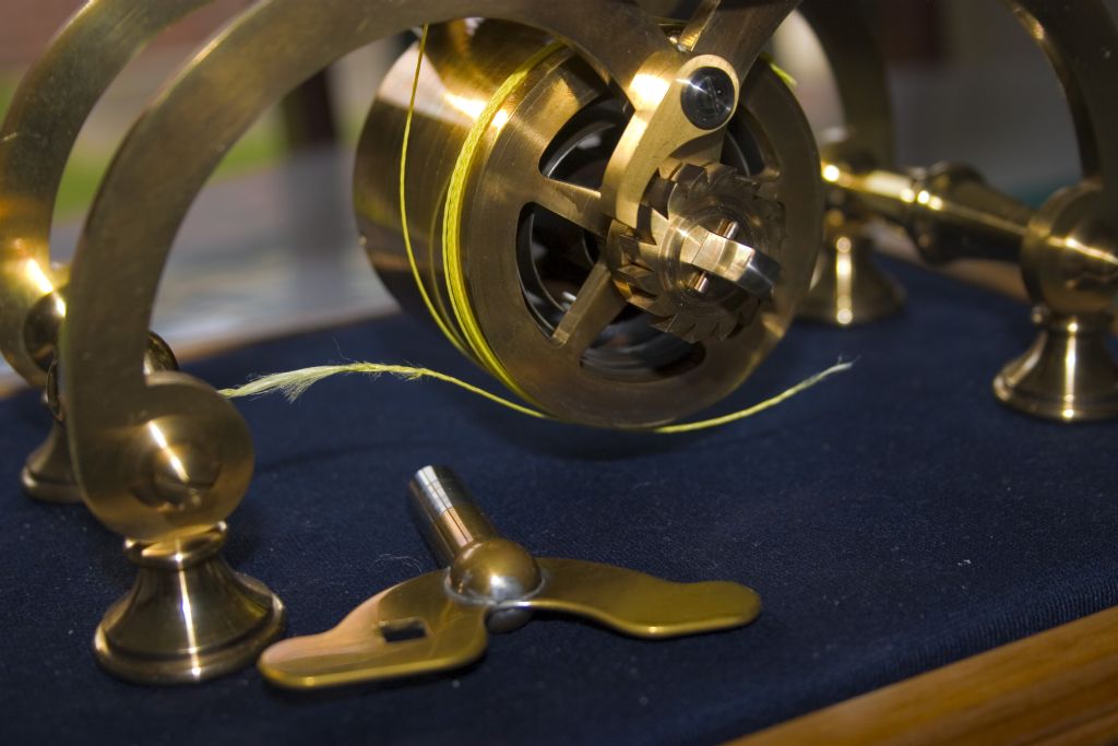

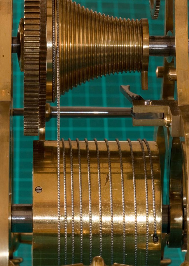

                                                Sam Stones
                                                  @samstones42903
                                                  This happened to the 80lb fishing line I was goaded into using. Only our dog was there at the time it broke, but I imagine from a near full wind, it must have got off with quite a din.
                                                  BTW, from my background in plastics, I should have known it could happen (creep before failure).
                                                  Here's the result of a three-year stretch –
                                                  I replaced it with steel, generously supplied by a local antique clock repairer east of Melbourne.
                                                  Barrel-&-fusee
                                                  PS – I wasn't the only one that got the winding direction wrong. It turned out to be how the barrel arbor had been drawn, and my lack of knowledge.
                                                  The knots on the ends are a mess, and will stay that way.
                                                  Sam
                                                  #572540
                                                  Sam Stones
                                                    @samstones42903
                                                    Adding to the above, this was a paragraph I wrote when I described building John Stevens' skeleton clock. (refer Model Engineer #4526 – Jan/Feb 2016)
                                                    To transfer the power from the barrel to the fusee I had used braided plastic fishing line. The (yellow) fishing line was rated as having a breaking strength of 80 lb. My fairly rough measurements had suggested that the main spring was exerting a tension in the line equivalent to a weight of about 10 kg (22 lb). There was plenty of strength to spare, or so I thought.
                                                    I trust this helps.
                                                    Sam
