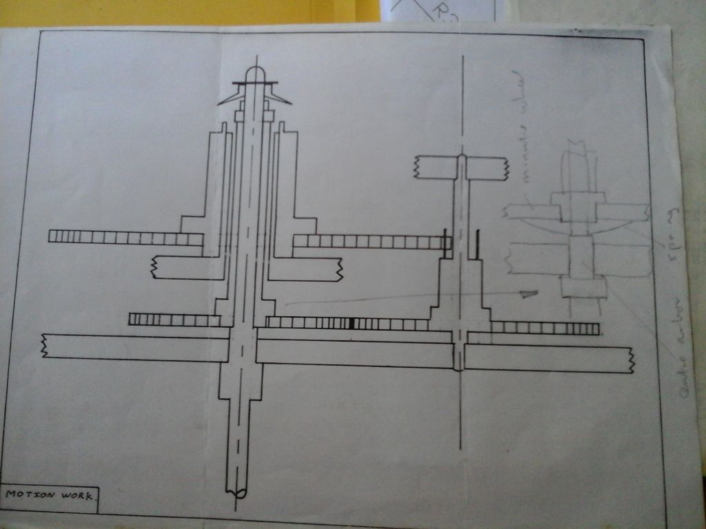

      Hi to all makers of this clock or indeed anyone who has already completed one.
      I am just in the throws of assembling the various wheels and pinions of the inners of the clock and could do with some help with the exterior motion work (hour and minute wheels) the book by John Wilding is a bit lacking in details of this assembly and whilst there are some good photographs on the forum a bit more advise and guidance wouldn't go amiss for me. This clock has truly been a challenge for me as a precision engineer but I am so close now.
      many thanks in anticipation of much superior knowledge.
      jim.

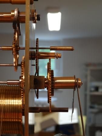

        I don´t know whether this helps but this is a side on view of the motion work on the clock as built according to the second book i.e. pinions instead of lantern pinions etc. The whole stack friction spring, minute wheel and pipe, hour bridge, and hour wheel floats on the centre arbour and is driven by the friction clutch that sits on a square that is filed in the steel collet that protrudes through the front plate. Attaching the hour bridge tensions the minute wheel against the friction spring. The minutes hand is held in place by a washer and a pin through the arbour at the end. A reverse wheel with a pinion translates and reduces the movement of the minute wheel to drive the hour wheel. In this version if you look at the clock from the front the reverse wheel stub sits at somewhere between 10 and 11 o´clock. The brass friction / bow spring is a critical bit, it is made springy by hammering and you have to adjust the tension, too slack and the hands aren´t driven and fall to the 6 o´clock position, too tight,nothing goes. The alignment of the wheels might involve the addition of a washer just to get the alignment right. The older version uses a small bridge to hold the arbour for the reverse wheel. The hour bridge´s position can be moved (big holes small screws) to centre the hour pipe.
        My clock is a bit rough and some bits are going to be remade but it´s running.
        Anybody know how to make a chapter ring which doesn´t involve too much sawing? My lathe won´t take anything bigger than 16-17 cim dia.
        Hope this helps,
        Dick H.

        #301866
        Jim C
          @jimc
          Hi Dick H.
          Many thanks for the photo and description of the motion work. I am making the clock to the old book and there seems to be some minor differences to yours. I can see from the photo the friction spring and can understand now how drive is brought about by having a square on the steel collet.(no mention of this in by book !!) am I correct in thinking then that the steel collet is glued to the centre arbor? And that tension is produced between the spring with a square hole in it and the washer at the end of the arbor?
          I am grateful for your help with this and good luck with your question re the chapter ring.
          Jim.

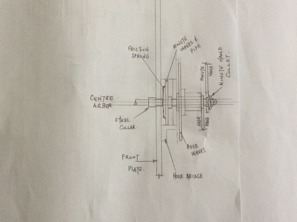

              Jim C
                @jimc
                #301934
                Dick H
                  @dickh
                  ´Hi Jim,
                  Your drawing would appear to fit my understanding based on the second book, the collar/collet being glued to the arbour and transmitting power to the motion work via the friction spring. However in the first book it looks as if the arrangement is different. If you look at Steve Bensons photo earlier in this thread you can see a shadow of the friction spring the other way round!?.
                  I must say I´m a bit confused, I know how my clock works.
                  Having a think.
                  Dick H.
                  #302022
                  Alan Charleston
                    @alancharleston78882
                    Hi Jim,
                    When I started this clock 10 – 15 years ago I was having trouble figuring out how the bits out the front worked as well so I drew up how I thought they should go and sent it off to John Wilding. He sent my drawing back with a penciled addition showing where the spring went (see photo). He didn't make any other comments so I assume my drawing is accurate.
                    I hope this is helpful. I'm not up to this part yet and I won't be until I can get the clock to run properly. I'm pretty discouraged at the moment and haven't done worked on it for the last 6 weeks or so.
                    Regards,
                    #302039
                    Jim C
                      @jimc
                      Hi Alan, many thanks for your help with this. It was obviously a bone of contention with you at the time. Your drawing is very clear and much more professional than my rough sketch !! And John Wilding has answered the question of where the friction spring fits. (From the horses mouth so to speak) I will crack on with this assembly then in the next few weeks to see how it all fits together. If I may I would like to offer some encouragement to you to continue with the build, especially now you have got this far. Thanks also to Dick for his input. Best regards, Jim.
