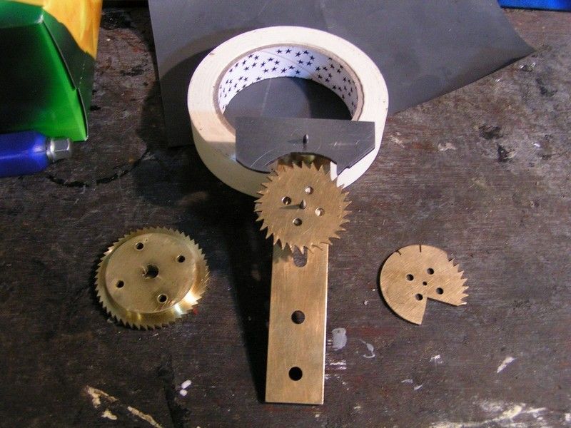

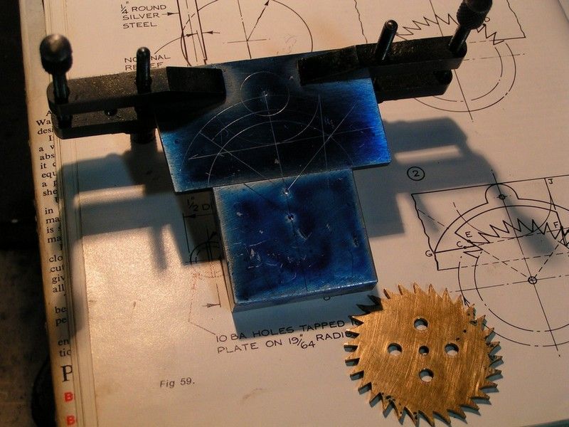

          This how I did my JW 8 day clock pallets, it was a long time ago now but the clock is still running well so I must of got something right

            Thanks for the help. One of the problems I struck was that the book says that the line GH shown in drawing 2 should pass through C and between F and D. It doesn't specify how it should pass between F and D. I have therefore drawn GH such that it passes through a point midway between F and D and generated a drawing of the pallets which I have printed and glued to a piece of 1/16" brass. I'll follow Bob Stevensons advice and see how I get on.

              After waiting for weeks my 0.2mm slitting saw finally turned up so I have been able to cut the slots required to get the pendulum installed. It's amazing how the suspension spring lets the pendulum oscillate for a couple of hours when it's set in motion.
              I now need to install the crutch. The book gives the dimension of the slot which goes around the upper block as 3/16" which is the same as the upper block. In my case, this has resulted in a tight fit. Am I right in thinking that it should be a loose fit with the slop taken up by the adjustable shim? If so I'll file the crutch slot out.
              Does anyone have any photos of the way the upper block fits into the crutch?
              I've made the pallets, so once I've got the crutch sorted out I can look at putting everything together and see if it ticks. Exciting times indeed!

                You need about 0.1mm (4thou) minimum clearance on the block just file it as it is not very critical but both the slot and block need to be polished, I made mine adjustable because I did not know any better but since then I have seen longcase clocks working well with twice that clearance, too big is better than too small.
                #289039
