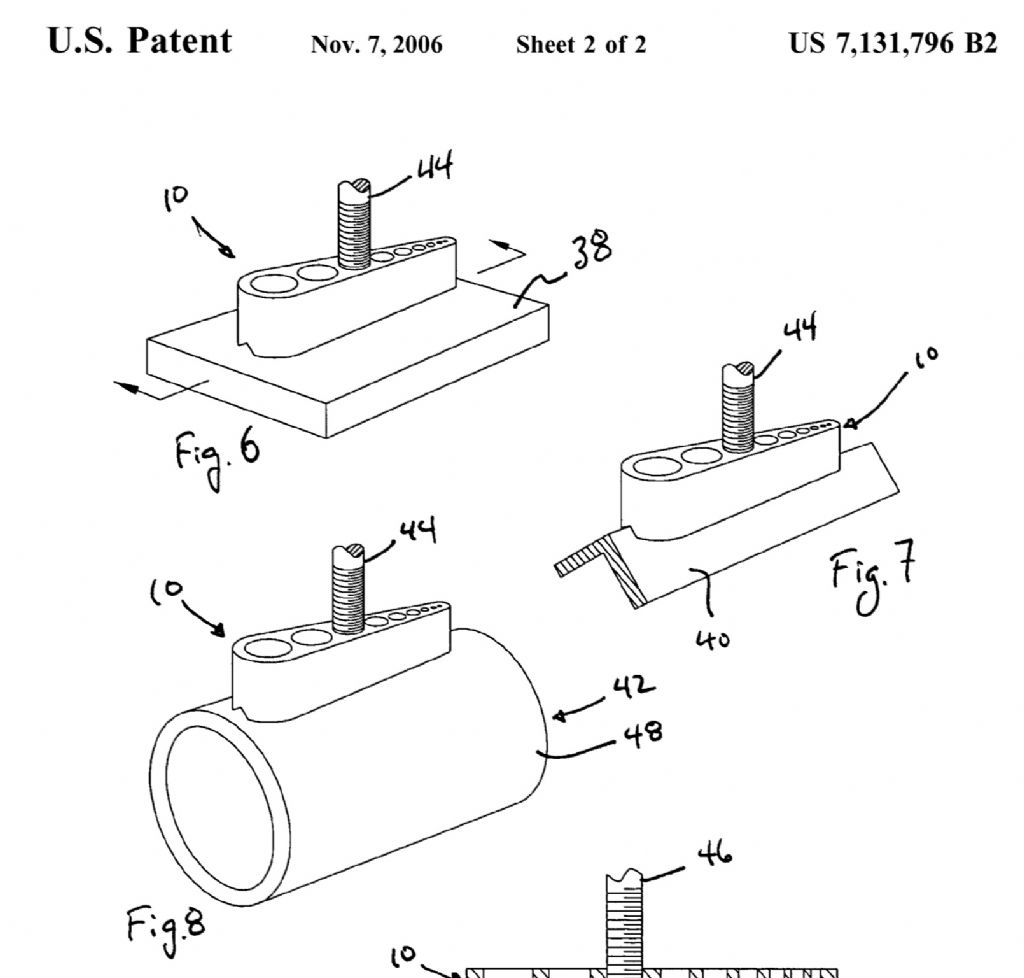

          Forgive the slight digression [‘though I am actually returning to the title of this thread] …
          Someone on the microbehunter forum was pictured using this drill & tap guide, patented by Bruce P. Rooney and currently available in the USA
          I think it worth sharing:
          **LINK**
          https://patents.google.com/patent/US7131796
          and also this, for a related version:
          **LINK**
          https://patents.google.com/patent/US9751133B2/en
          MichaelG

                              #486394
                                Posted by Chris TickTock on 18/07/2020 09:07:52:
                                The only issue I had using this was tapping holes on tubes. I did find this : […]
                                Strangely enough … the big feature of Mr. Rooney’s device is the Vee groove on the underside:

                                      #486515
                                      Chris TickTock
                                        @christicktock
                                        Posted by Michael Gilligan on 18/07/2020 09:38:50:
                                        Michael, what about across the tube, you would still get a levelling issue/
                                        Chris

                                          #486523
                                            Posted by Chris TickTock on 19/07/2020 08:13:37:
                                            Chris
                                            Well, YES … of course you would
                                            as indeed you would with the converted vee-block that you referenced.
                                            Can you find any device that doesn’t include a ‘fixture’ which wouldn’t behave as a see-saw ?

                                                #486540
                                                Chris TickTock
                                                  @christicktock
                                                  Posted by Michael Gilligan on 19/07/2020 09:07:53:
                                                  Chris
                                                  Michael you are right in that nothing is perfect. Rooney's device is useful.
                                                  Chris
