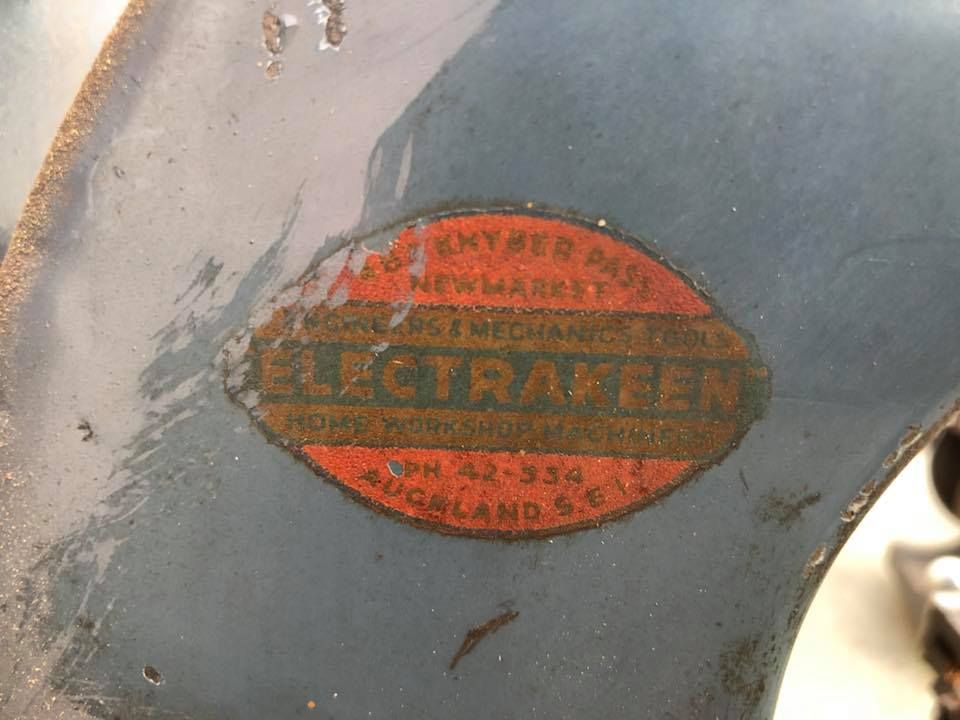

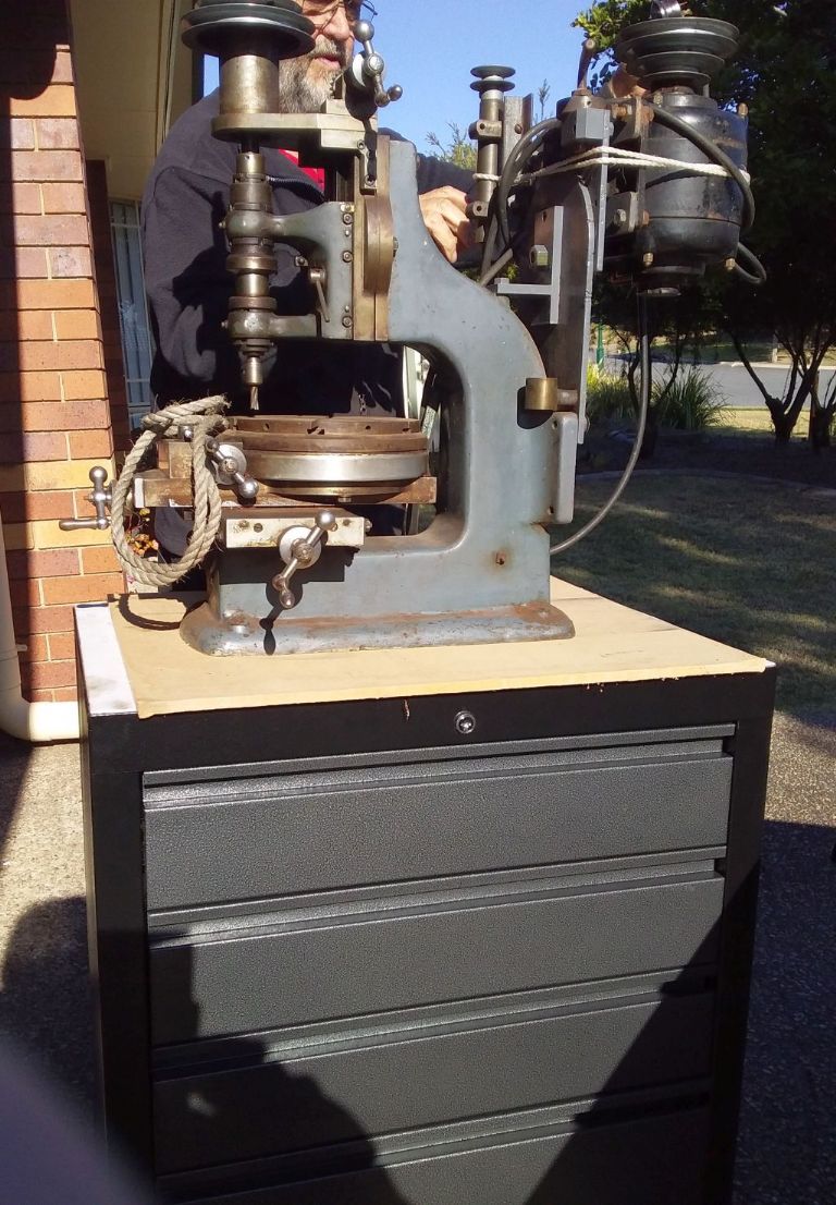

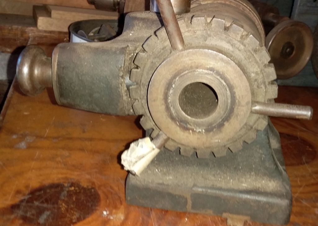

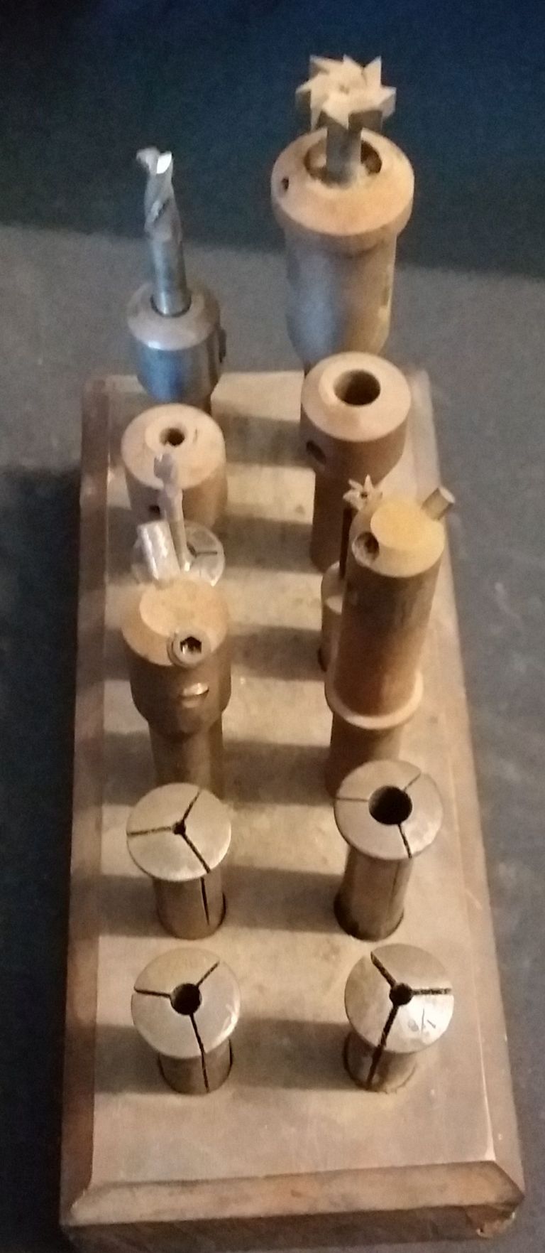

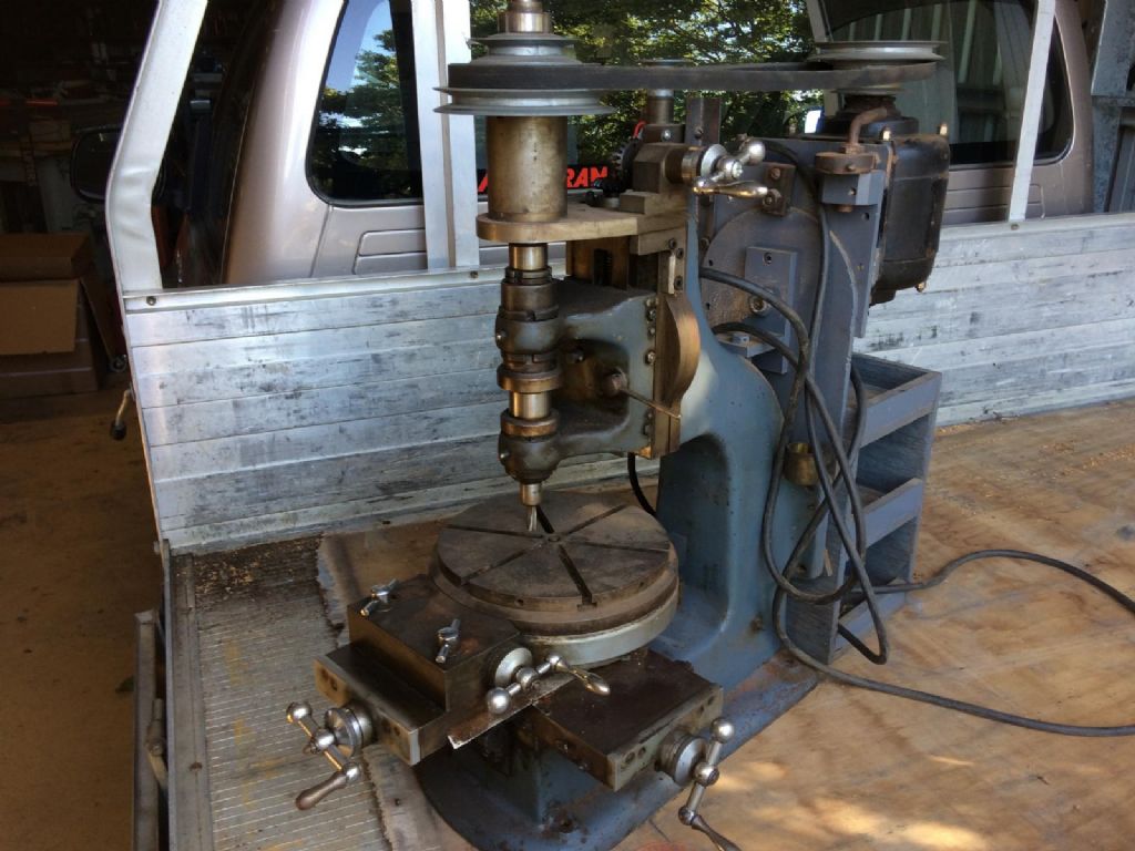

      img_1405.jpgimg_1402.jpgimg_1400.jpgimg_1398b.jpgimg_1398a.jpgFellow i know picked this beauty up during the week trying to locate more info on it. If anyone has any photos, links PDF's etc could you please let me know.img_1396.jpg
      The Electrakleen transfer indicates the mill was made in England, it has a 1/4 HP BTH motor, wiki suggests that BTH branded motors were last produced in 1960.

          Seems it might be a knock off of either e Sigma Jones or
          http://www.lathes.co.uk/bca/
          #350804
            Nice find, Raymond
            It looks like it has been used [adapted] for heavier work than originally intended, but yes; it's basically in the style of the early version of the BCA.
            I'm also surprised to see six slots on the table.
            P.S. Not too sure about your analysis of that ELECTRAKEEN transfer though. dont know
            http://lmgtfy.com/?q=khyber+pass%2C+newmarket%2C+auckland

                It's not a "knock off", these machines were part of the war effort during WWII and were 'duplicated' from German machines by order of UK Gov……have some improvements over the German originals

                  Going by the Transfer, I would say it was sold from a shop on Khyber Pass Rd Auckland New Zealand. I'v looked up the NZ companies site, and found that Electrokeen 1960 Ltd 127 Queens Drive Lower Hut closed 15/7/1991.

                      It's identical to my Sigma Jones/Exel model 0/BCA mk11, wartime clone apart from the modified drive (not a bad idea, by the looks of it), shelves and the six slot rather than three slot table.
                      Mine's got 7/16BSW feed screws for some reason. I don't know if a previous owner wanted 14tpi screws or if it was an ignorant repair, but I haven't got around to rebuilding or using it since I inherited it from the old man…

                          A nice machine but I think the electrics could do with some attention, twin and earth and exposed terminals are far from best practice for machine wiring.

                            The machine was unlikely to be made in NZ, but Electrakeen (not Electrakleen) seems to be the retailer who sold it when they were in Auckland NZ.
                                    Mike
                                    poor Bob had not had time to check it all out was assured the thing/motor worked he turned it on but it didn't run, not ceased tho. He'll check it out when he gets back next week. He's had a busy few days with a museum he does time at.
                                    We both spotted the wiring when we were checking it over.
                                    Main shaft bearings need replacement notchy as blazes, every thing is tight a good clean and some TCL might see it become a very nice unit. The accessories blew me away, cutters of all sorts even small gear cutters, index plates and dividing had, the cross slide block is actually a tilting table beautifully home made marked in degree's. Many fly cutter and some neat dual arm hold downs.

                                      The logic being that [although it would be a very useful feature] I have never seen one of these machines with six slots in the rotary table.
                                      Your friend's machine has evidently been 'improved' so I was hoping that you could confirm whether [or not] three of the slots were customisation.

                                        Michael the Sigma Jones rotary table is numbered different to the rest I've seen and appears to be factory milled.
                                        Now my machine s Bob has decided he has no use for it so i am buying it off him. Minus the tilting table which appears home made but to standards very high.
                                        We found motor doesn't arch up so bob is checking that out and the notchy bearings on main shaft. Hope there is no serious damage to the shaft, bearings can be replaced.
                                        I'd like to do a restore on it, going to need to locate the sizes of the original drive belt pulleys and the tension bracket which I will have to get one cast up. I bout I'd ever find one.

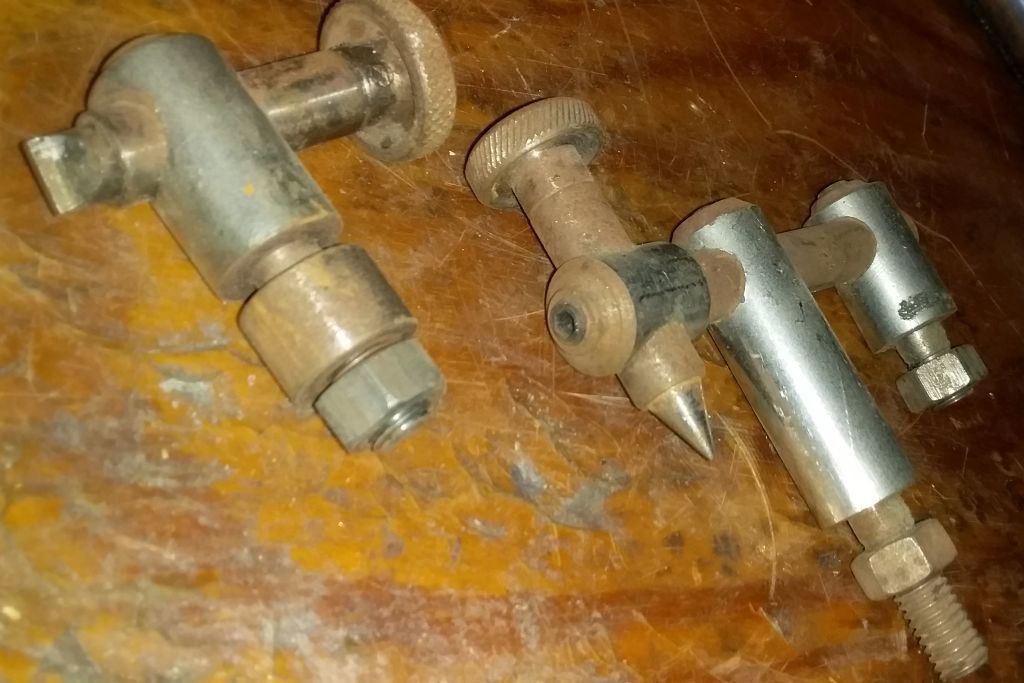

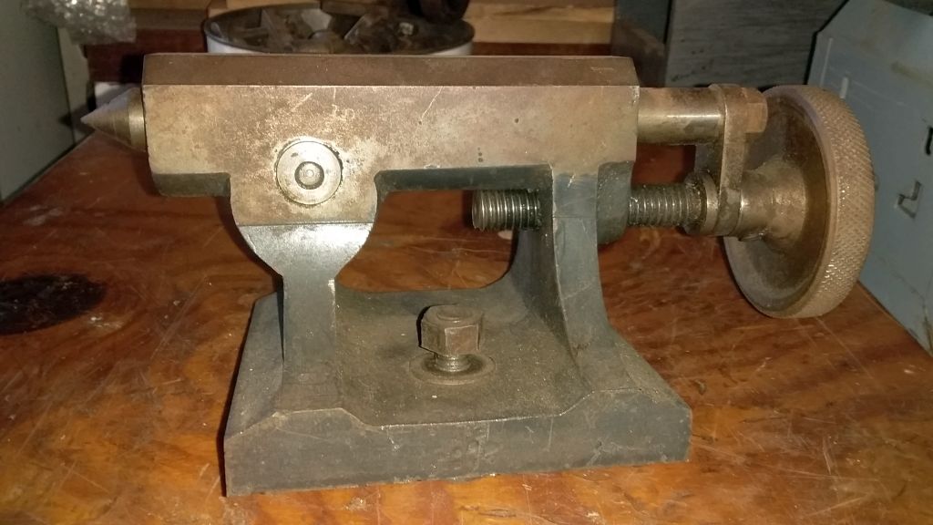

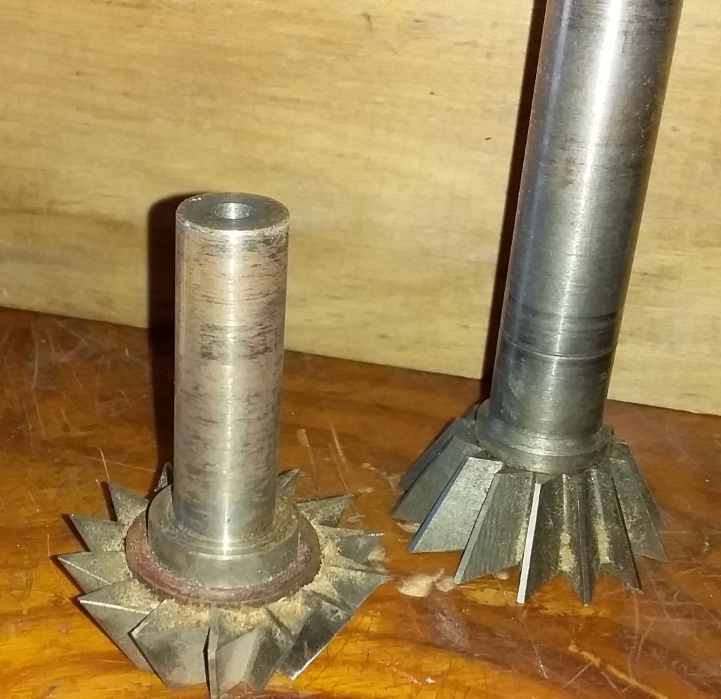

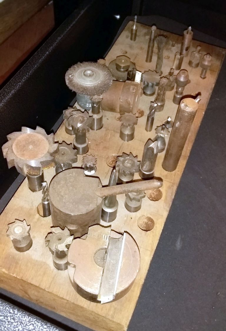

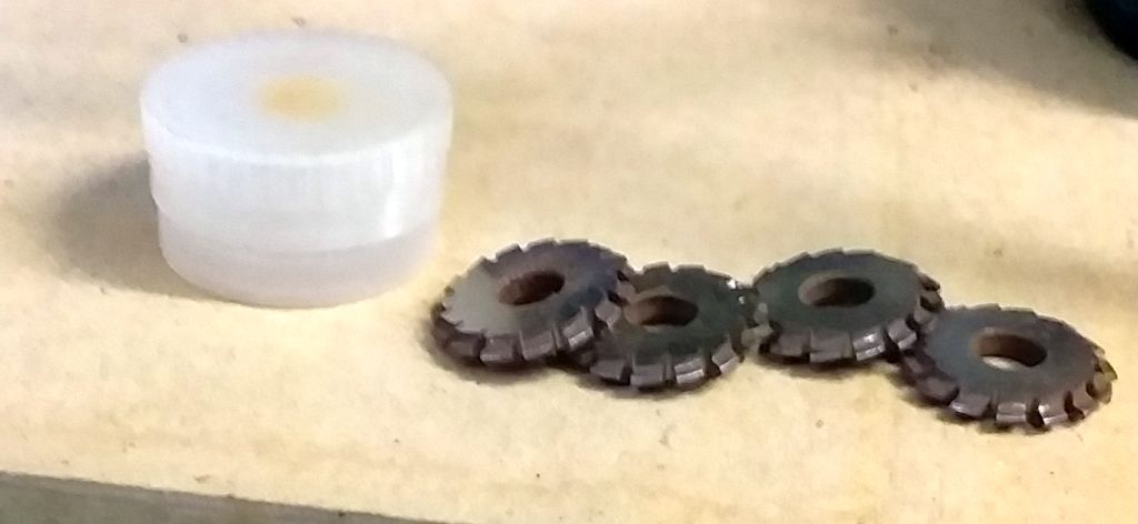

                                                As of Friday the Jig Borer is in it new home rushed out to buy a new cabinet trolley earlier in the week that came with drama as they didn't have at the firsts store what I was after other than one which had parts missing. So opted for one with doors not draws. On opening that up foud the carton had been dropped and to many panels damaged so it went back. Sourced another store and found the one with draws, all bits n pieces (ow you got the song going through your head too) are stored handy to the machine.
                                                The additional tools and tooling which can also be used on the ML7 much of it needs a good clean up and surface rust removed.

                                                  Nice machine, but that's some serious chuck abuse!
                                                  #365508
                                                    Posted by Neil Wyatt on 04/08/2018 12:09:17:
                                                    Kinda goes with the innovative modification to the main spindle arrangement.
                                                    … looks like all the important bits are there though; so hopefully, Raymond can restore it to something like its former glory.
