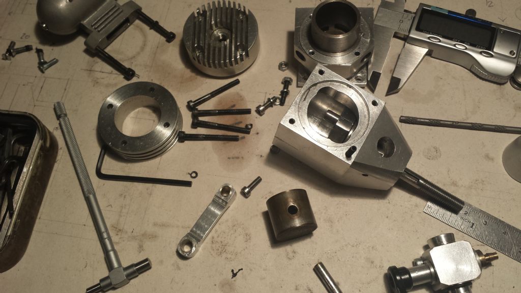

          Hi All,
          Dismantled the firefly yesterday for a winter service.
          My "pilot", John, a friend and experienced aeromodeller felt that the engine was starting to labour over the few months of flying. I wasn't really surprised because it's been worked hard over the last year.
          I was surprised when I opened it up and discovered the wear in the con rod. The big end hole was elongated by a good 0.010" so much so that the underside of rod had been rubbing against the crankcase. The small end was also a sloppy fit. I'm curious as to why it has worn so much. I used H15 alloy as specified and the crank and gudgeon pin were polished before assembly two years ago. Both ends had lubrication holes to feed the bearing surface. Is this sort of wear to be expected from a plain con rod with no additional bearing material?
          Anyway using my new super dooper Seig mill it was a simple task to open the holes up and insert slimline phosphor bronze bearings. You can see the renovated rod in the photo. Let's hope they stand up better than the plain alloy bearing, time will tell.
          Geoff

            How does oil get to the rod ends? If it doesn't have a path to get there it may not, and if there's not enough lube you will get wear. Maybe you could pre-oil by hand before flights. Just a thought.
            #395244
              "Both ends had lubrication holes to feed the bearing surface"

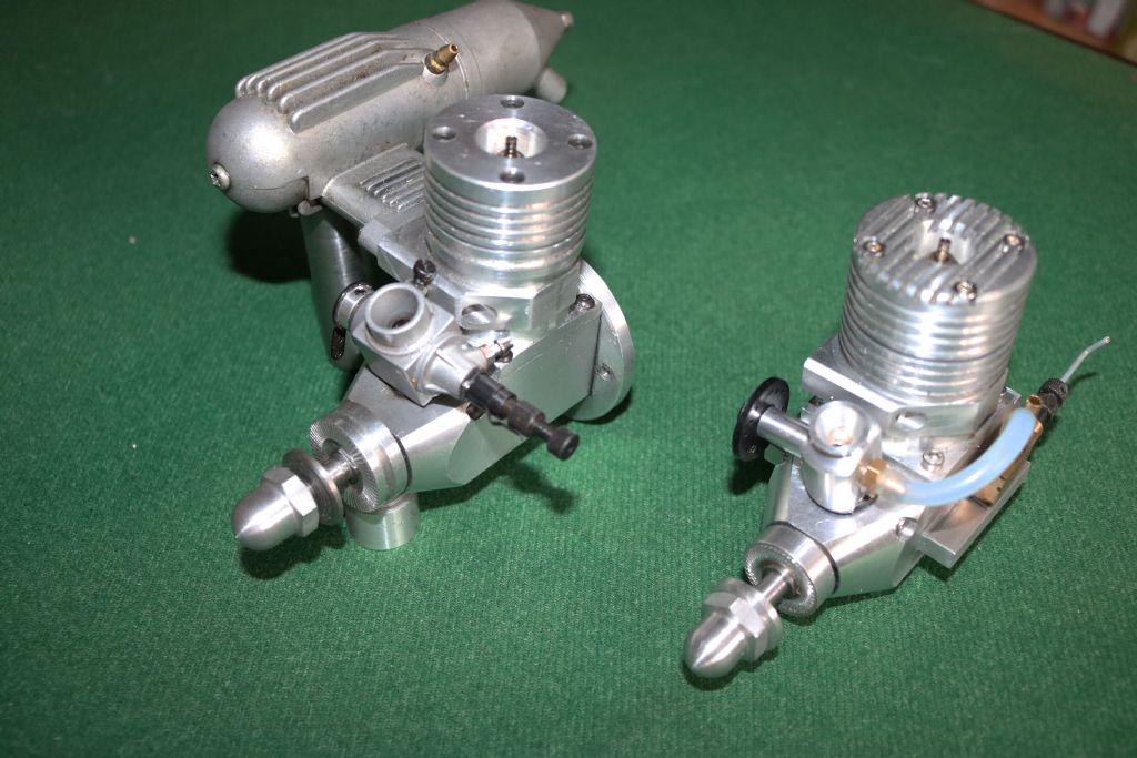

                img_6826a.jpgA photo of the two Firefly's I have built. I have had no success in getting the top one to run. I have not tried the front version as it currently contains an early attempt at the cyl /piston assembly.
                Basically I don't seem to be able to get a fit of the piston in the liner to give good compression. My attempt at using a piston ring did not work (probably because I did not temper the ring).
                I suspect that the venturi on the commercial carb is too large as well and the poor crankcase vacuum is not sufficient to draw fuel.
                So the next (and probably final) step will be to make a new cylinder/ liner for the front version with the design carb adopting all the excellent advice I have been offered on this thread

                  Hi Peter,
                  If you are making a new liner and presumably a new piston then it might be of interest to you to have a look at the website referred to in an earlier post by Ian Hewson
                  The site is Adrians model aero engines. In the technical topics section there is an excellent article by a guy called Ken Croft on cylinder liners and pistons including lapping and fitting.
                  I found it really interesting, maybe you will too.
                  Geoff

                      Geoff.
                      Thanks for the link to Adrians Model Aero Engines. An interesting site and the article by Ken Croft was really helpful. Full of useful tips such as using Turps as a lubricant in the lapping process.
                      I made the cylinder lap he described but found that it tended to expand at the end as the grub screw was tightened which is exactly what you don't need so I have reverted to Adrians design which gives a parallel expansion along the laps length.
                      Now for several hours of patient work on the liner.

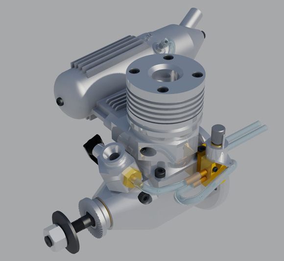

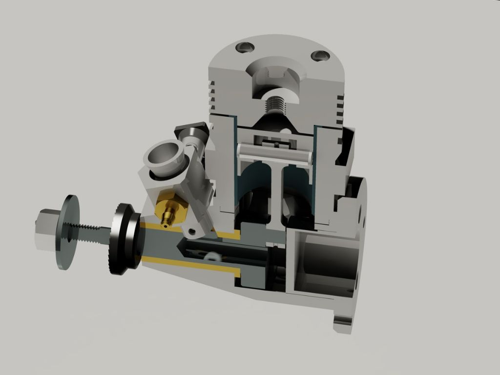

                                      I've now added the additional renderings to the Dropbox account as well as to my Firefly Album.
                                      Just to tempt a few who may have missed it first time around and are looking for a lockdown project here is an external rendering and cross section.
