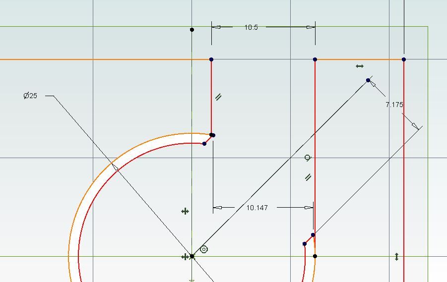

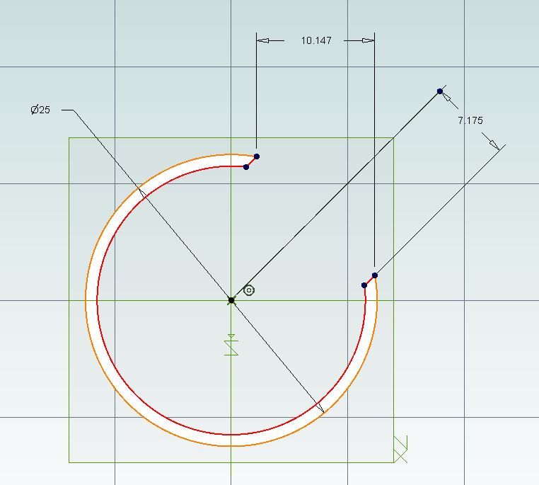

                          A question about the port dimensions, the cylinder block exhaust port is shown as 10.5mm x 5.5mm, whilst the cylinder liner port is shown as 15.285mm x 4.96mm.
                          How critical are these dimension as the are shown to three places of decimals?

                            The three decimal places of the exhaust port are more a product of the CAD package when it rolls the liner out into a flat plane, the 14.35mm is what you will actually machine.
                            Width wise you have a bit more leway but the heights of the ports are what really set the timing of the engine so they are what you should aim to get as close as possible.
                            The crank case hole is a little larger than the port in both directions so it does not offer any resistance to gas flow and is less critical than the liner.

                              Thanks for your prompt reply, appreciated, so the holes on the liner are the critical ones, and should not be restricted in diameter by the holes in the block when it is fitted?
                              The 10.5mm exhaust hole was the one that was confusing me as it seems to restrict the port in the liner.
                              Just measured the plan, and I can now see that the 14.35mm is due to the curvature of the cylinder, didn’t want to bu**er up the block on the last cut.

                                That's it liner is the one to get right particularly height.
                                The 10.5 and 14.35 are basically one and the same dimension, if you were to project two vertical lines upwards on the drawing that shows the 14.35 the distance apart would be about 10.2 as the 45degree cut is the long edge of a 10.5 x 10.5 triangle with a bit to spare.
