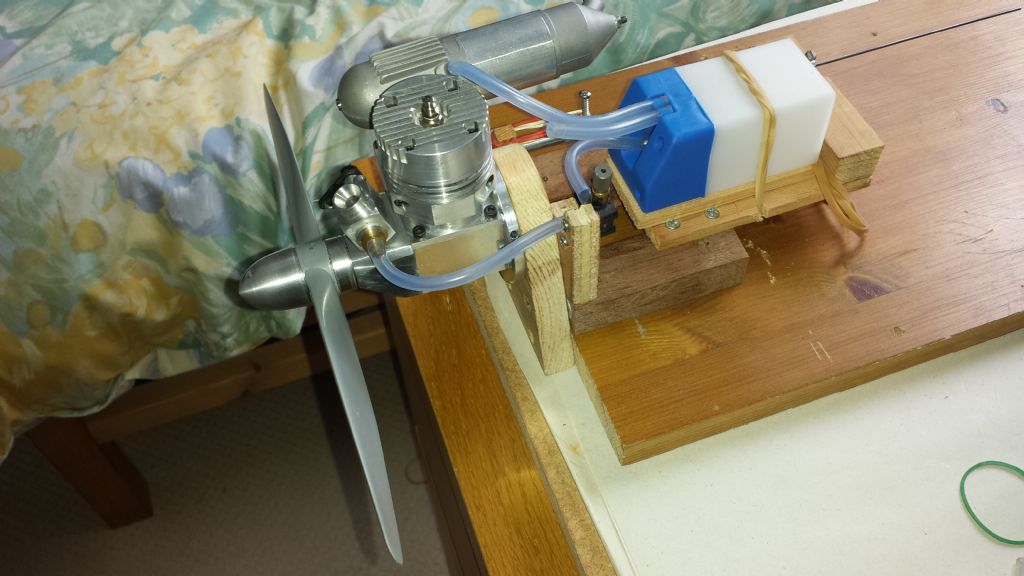

                            many thanks to Jason for the thread as that was all I had except for the plan smiley. Engine mount wood is flexing hence movement sad
                            **LINK** https://youtu.be/DQ_LxO-p75s
                            My first attempt at an ic engine, very please with result, it’s not exhibition standard but it runs and looks ok.
                            Edited By JasonB on 20/04/2018 18:10:02

                              Keith Whiddett
                                @keithwhiddett67769
                                Thanks for like Jason. What I did not add is that I ball raced the main shaft !!

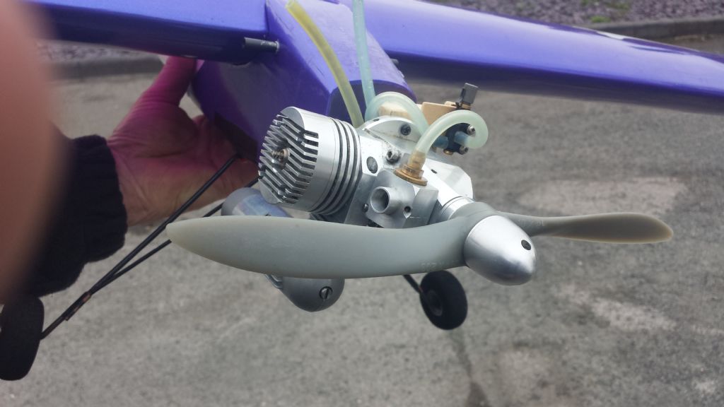

                                geoff walker 1
                                  @geoffwalker1
                                  Nice job Keith, I know how you feel, it was my first engine as well.
                                  I also used ball races instead of the plain bronze one. No particular reason just seemed like a good idea.
                                  Mine has been in the air today on a cougar 2000 model. The slightly larger carb is one I made for Jones 605, easier to tune for performance. Just about fits in the barrel space. The Cougar is a small light model which was about the size limit for my engine.
